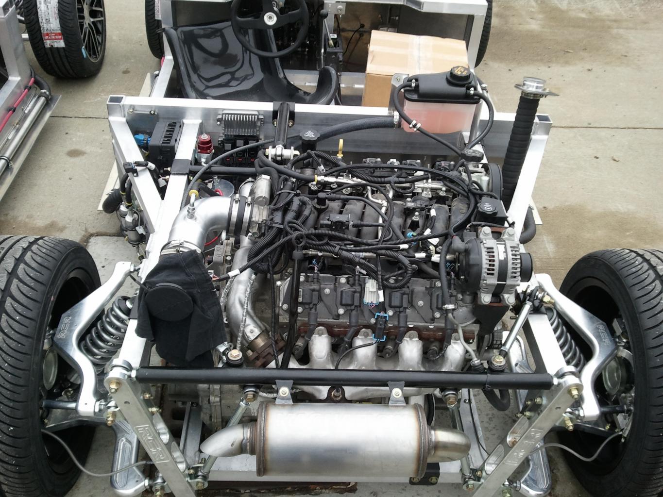

It might sit like this ...or maybe not....:lipsrsealed:
thats not an SLC or an Apex...its a movie car and its wider than both of the aforementioned cars.
But it does show what the LS4 drivetrain looks like out of its OEM home
Yes I was just going to say, that doesn't 'fit' either of the two... Interesting! Could such a package be used on an SL-C though or, not wide enough?
But the Apex, although not as wide as the mystery aluminum movie chassis shown in the photo, IS wide enough for the LS4 drivetrain...?

Yes but not with the suspension from the SLC though....the movie cars all use the same components for ease of service while on set....hence the reason I said that the unit pictured is too wide.
Oh, I see now, It will sit sideways. Even though it isn't the Apex, thanks for the teaser Fran. I'm not sure if I remember someone asking but will the front or rear clamshell open like the SLC? I would imagine the front to be a lift off.
Aha! Should have thought of that! The reason I am so excited about the Apex now with the LS4 drivetrain is that it is sort of a little brother to the SLC with wife-friendly features. Tom is now legally blind and anything he builds for himself has to be piloted by his wife, who is Debbie Downer personified. The Apex would be his chance to get into a world class performance car, something I believe he had resigned himself to never happening.
