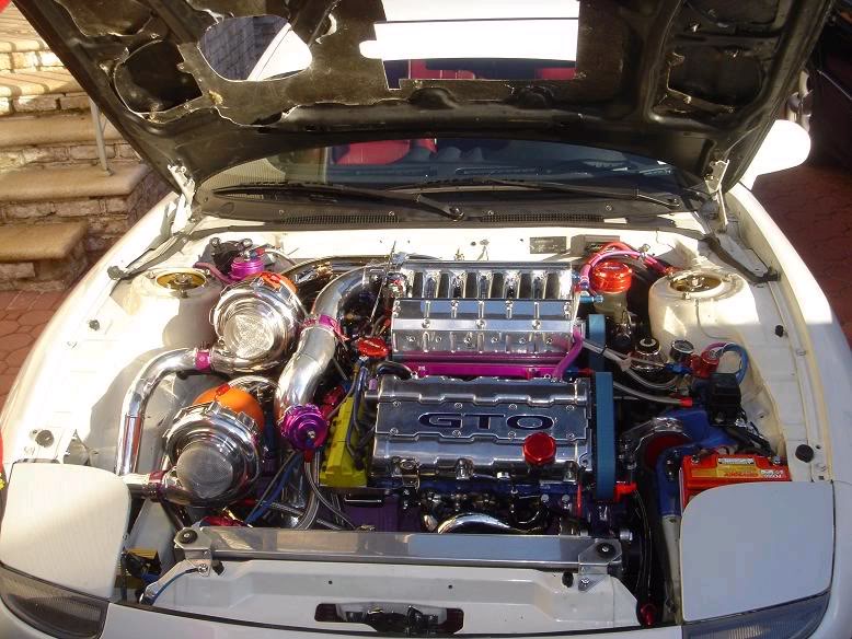

that would be pretty cool, I dont think you would really need something like that to get air to the IC there. I think it would be better to have vents in the hatch to just let hot air exit out. I think putting a IC core like on the fiero would work but maybe mount it long ways tucked up into one of the scoops behind the door. My plan running a 6g74 stroker with a 6 speed trans. I want to mount both turbos over the trans like this picture. They will still be facing the front of the car so I can run the exhaust off of them into a single pipe then have it come out the bumper.
