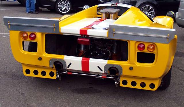

Hi everyone,
just wondering what rearlights were used on that car.
I´ve always been thinking that these rearlights were pretty much
Lucas standard units like the ones to be found on Landrovers Series II etc.
But then someone told me that the ones Lola used were slightly different,
more like those Volvo used on the P 1800.
So I´m a bit confused now. Any advice is greatly appreciated.
Thanks.
Marcus

Here are some images of the tail lights I captured on the web during a short search - I'm afraid I am no good with Photoshop so you'll need to use your imagination or find someone with more talent than I;
Big-Foot,
that`s interesting, thank you, just trying to imagine the car with such rearlights.
Any idea as to what other cars had the rearlights shown below?

Hi Marcus
I googled Landrover Series II photos and found a good 3/4 rear pic of its tail lights but couldn't repost it here. Anyway its lights look identical to the yellow Lola above ie same 2 relieved screw holes, high pointy dome and concentric circle pattern (you can see this quite clearly on the hi-res pics of the purple car on the Lola Heritage site).
As far as I can tell they also look the same as the tail lights on my 1:12 Tamiya T70. If it was me, I'd hapily go with the Land Rover lights. That said, I haven't looked for picutres of the Volvo lights to compare. Don't want to look at any Volvo parts...
yep, can cofirm what darren says . if you are scourcing Healy spares they are for the bj8. steve
So that explains why the tail lights and the indicator lights are different on mine... Looks like the red tail lights are the original ones and the Orange ones are off the Landy - I'll post a pic for confirmation.
