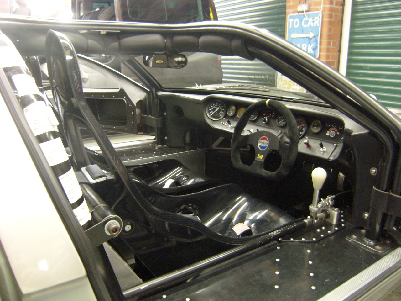

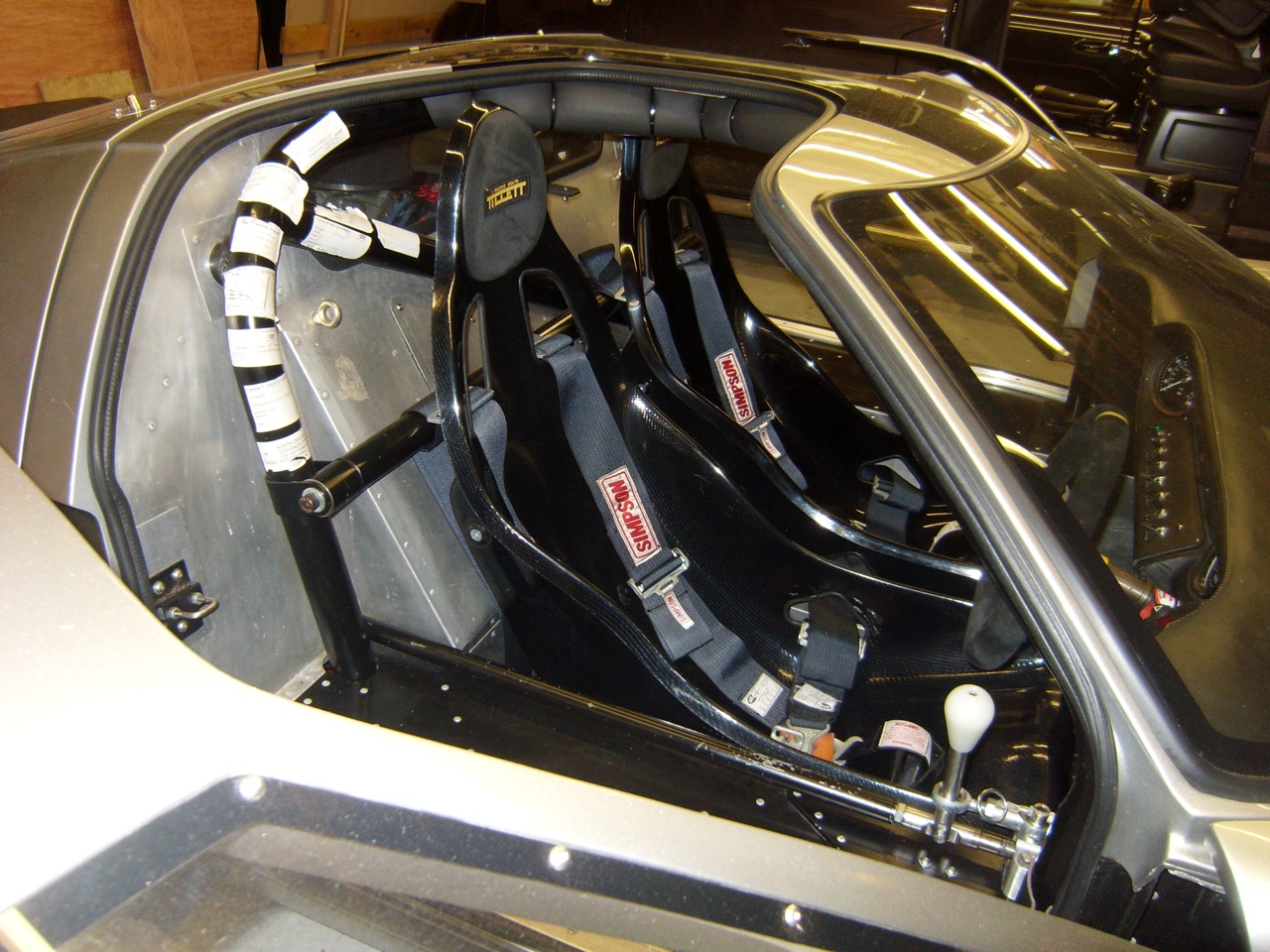

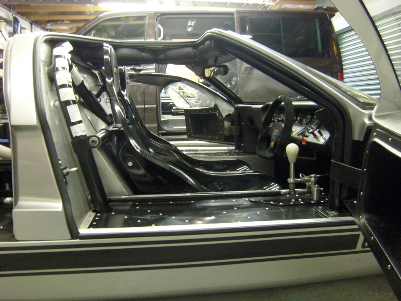

Tom,
Enclosed pictures as requested. FWIW I am about 5'11" & I have set the seats to fit me perfectly. The seat brackets allow for a certain degree of adjustment. I fabricated some additional bracing to rigidly mount the seats to the chassis floor.
I spent many hours carefully adjusting the position of the pedal box and the steering wheel aswell as the seat & tried several variations until I got a driving position I was happy with.
As previously discussed, different drivers have different seating requirements & as such the Tilletts won't work for everyone. For me, my helmet is just shy of the ceiling and my knees almost touch the underside of the dash & I am held firm by the harnesses. This alone greatly improves the driving experience.
I find the seats very comfortable despite the absence of any padding. If you decide to try a different brand of shell seat, be sure to buy a double skinned seat, as a single skin can have serious safety issues if it were to break in an accident.
I hope this is of some help to you.
Kind Regards
Julian West
