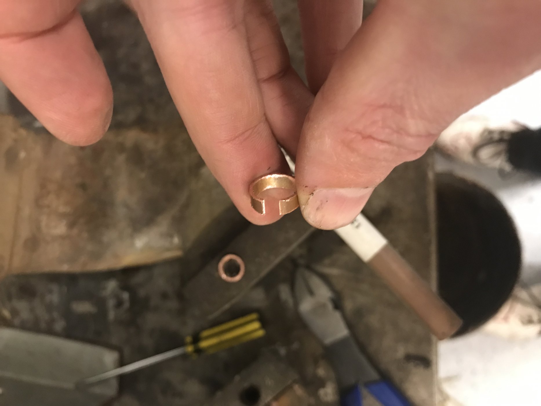

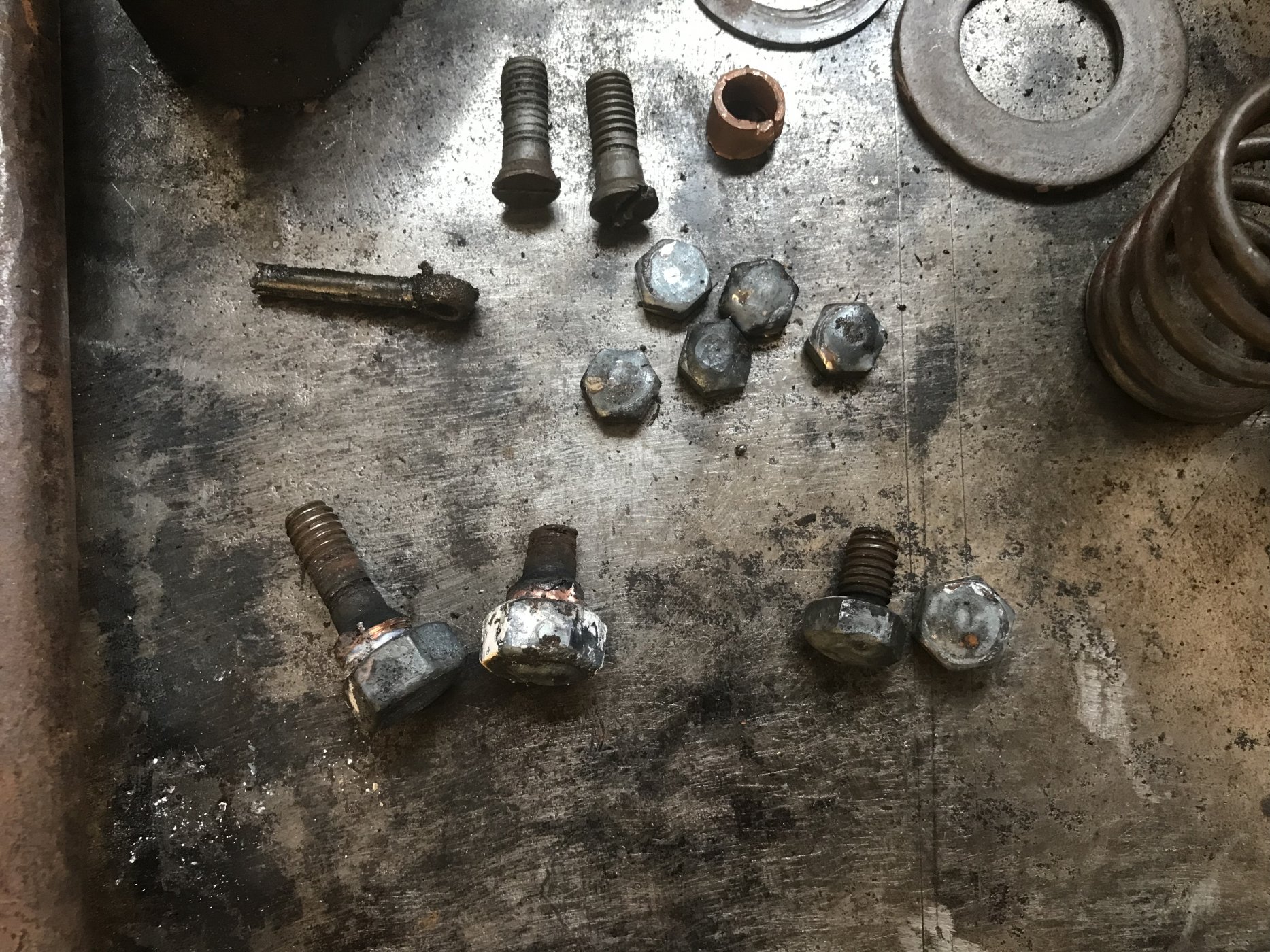

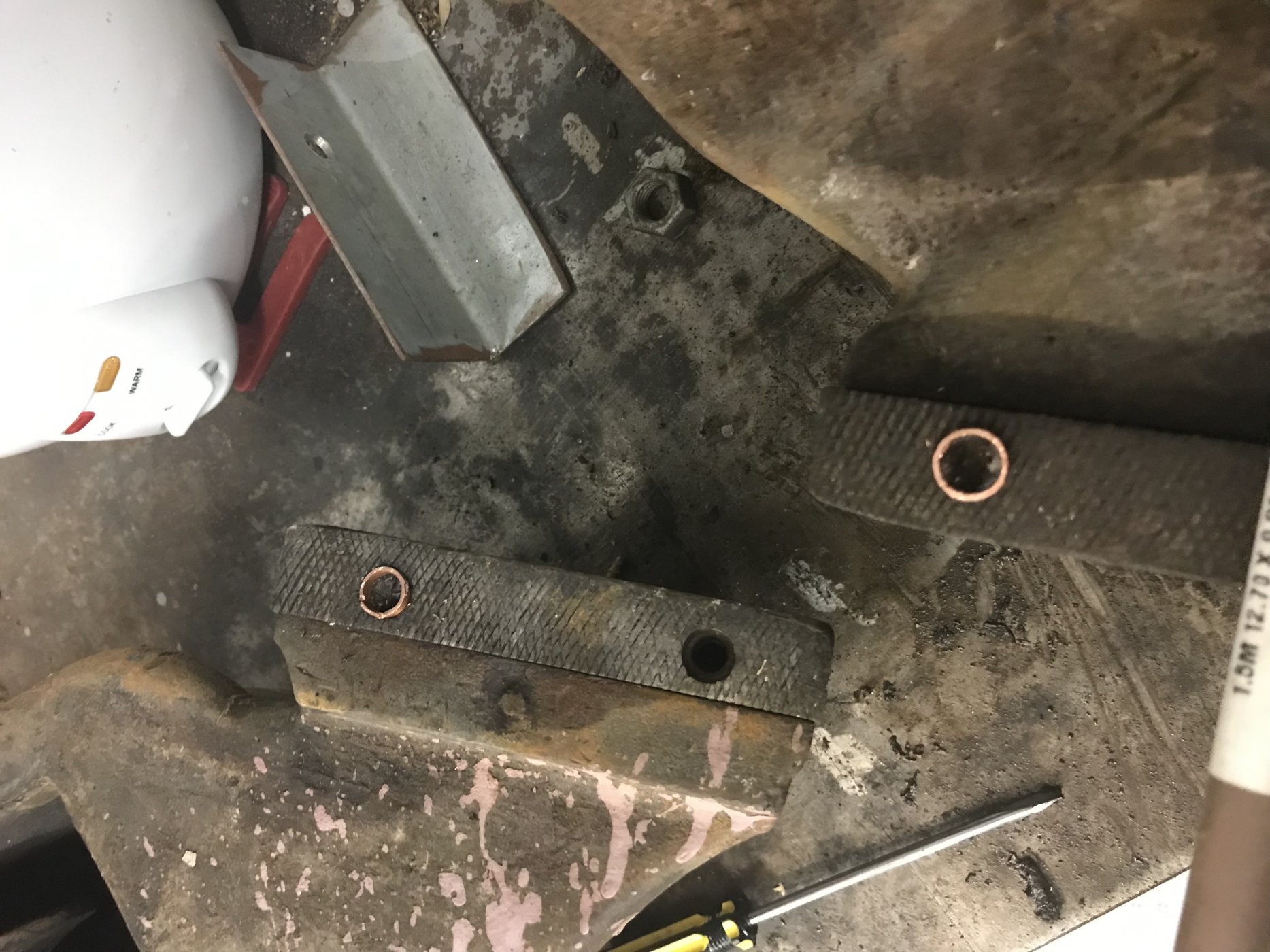

I picked up an old Dawn 5” Offset Vice, which was manufactured pre 1980. Went to remove the bolts holding the jaws on, and predictably two were rusted solid.
formed up some copper into a ring to poke down into the counter bore, then build the weld up in the centre and weld a nut on the top once it’s proud.

yes, especially for bolts that snap off down the inside of a blind hole......like exhaust studs.
You can also drill a hole in a copper penny, place the penny over the broken stub, then a nut. Weld through the middle of the nut and then turn it out while still very hot. Sometimes helps to chill the broken part with WD40 and then turn it out.
