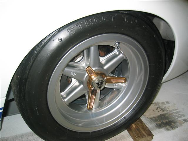

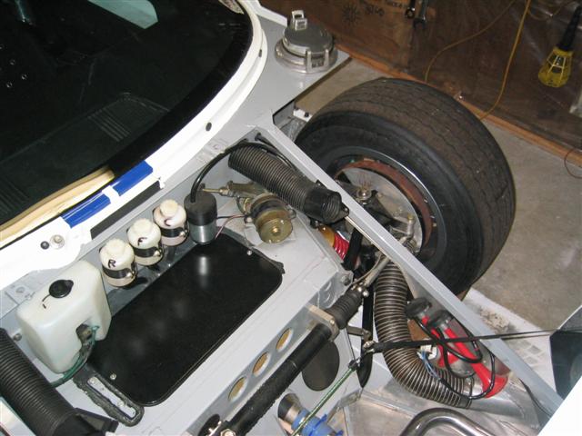

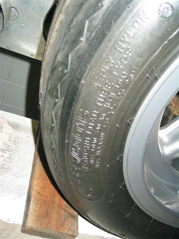

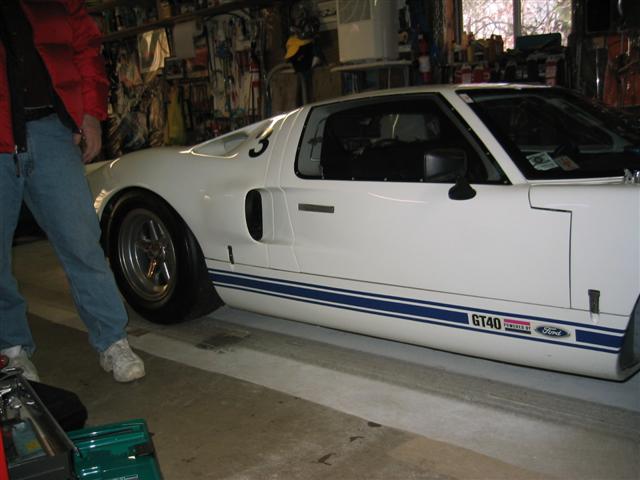

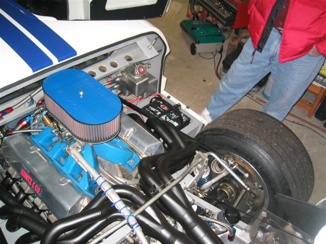

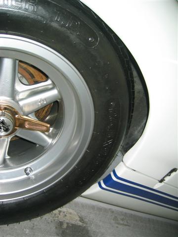

Here's a few pictures I took of a friend's MK V with the Hoosier TDs.
I think those Hoosiers are a good alternative for those that must have the superwide tires. Seem to be far less expensive than Avons and should be every bit as good. Might even respond to shaving to make a track tire out of them, I don't know. Hoosier would know though, or some the the race tire dealers like Appalacian Tire Appalachian Race Tire. We use those guys all the time at the track and they know their stuff when it comes to performance track tires.
