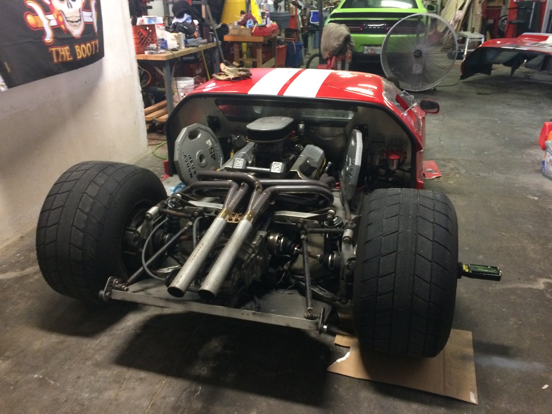

I have 15" * 14" Rears also; I have somewhat reluctantly accepted that I will fit Mickey Thompson Sportsman 29*18.00R15
A very high profile tire ... but I am not aware of any other tire except maybe (Hoosier) that do a DOT approved radial for 15" diameter and 14" wide

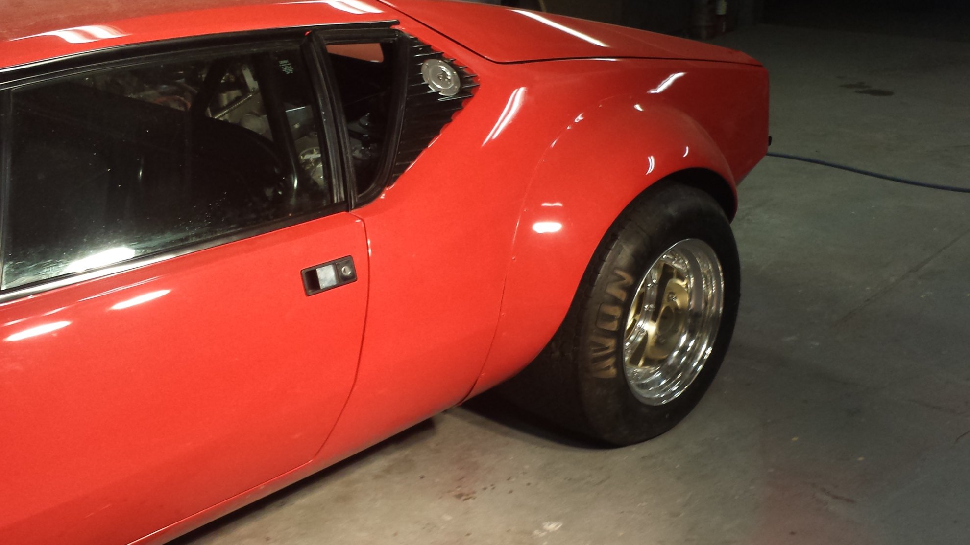

Avon 12.5/27.0-15 treaded on 15"x 14" rims on my Pantera Gr4 style. Works on the street, but race tires throw a lot of stones up into the wheelwells. Also, thin sidewalls lose air pressure quicker than street tires.

Not road legal in the UK otherwise I’d be all over that.
