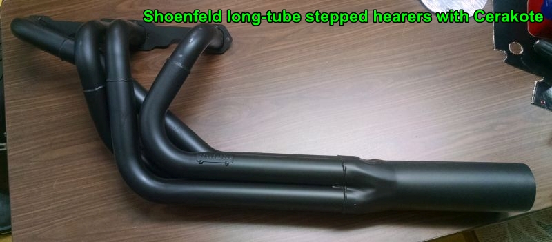

Bill, I've tried wrapping headers in the past and wasn't too pleased with the results. The wrapping tends to accumulate moisture when the headers cool down and cause then to rust. The Cerakote coating works much better. The coating does reduce the heat somewhat but it protects the surface and reduces rust & corrosion. It looks good, too.
