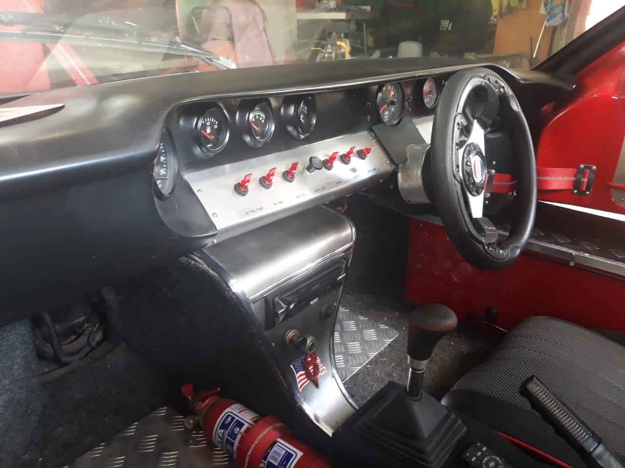

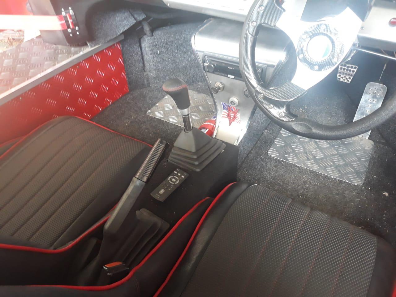

The KCC's GT40 manual has instruction on setting up the shifter on the right hand side of the driver (even with the RHD car) like the original GT40's
But mine was built with the shifter in the center. I think this change was not sorted out properly by the person that built it, so it doesn't shift very well at all now.

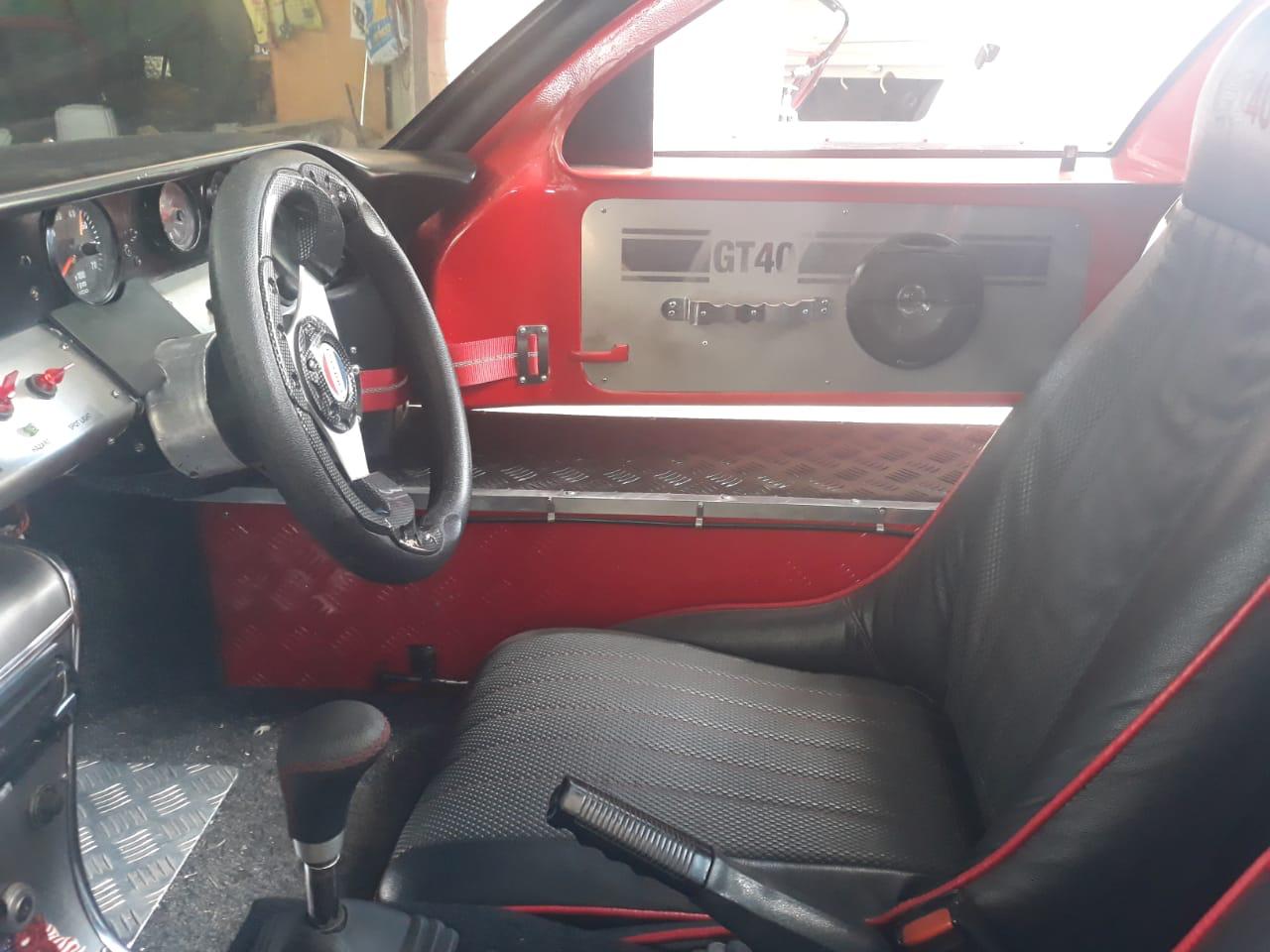

I'm going to redo the center console and cover all that diamond plate the previous owner put in, and redo the door panels, among other things
