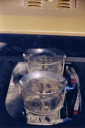

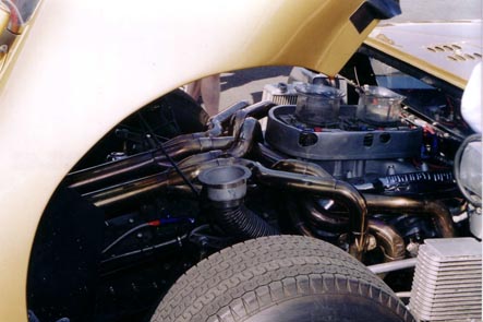

Ian Anderson
From Le Mans 2004 on Gold car No 5
