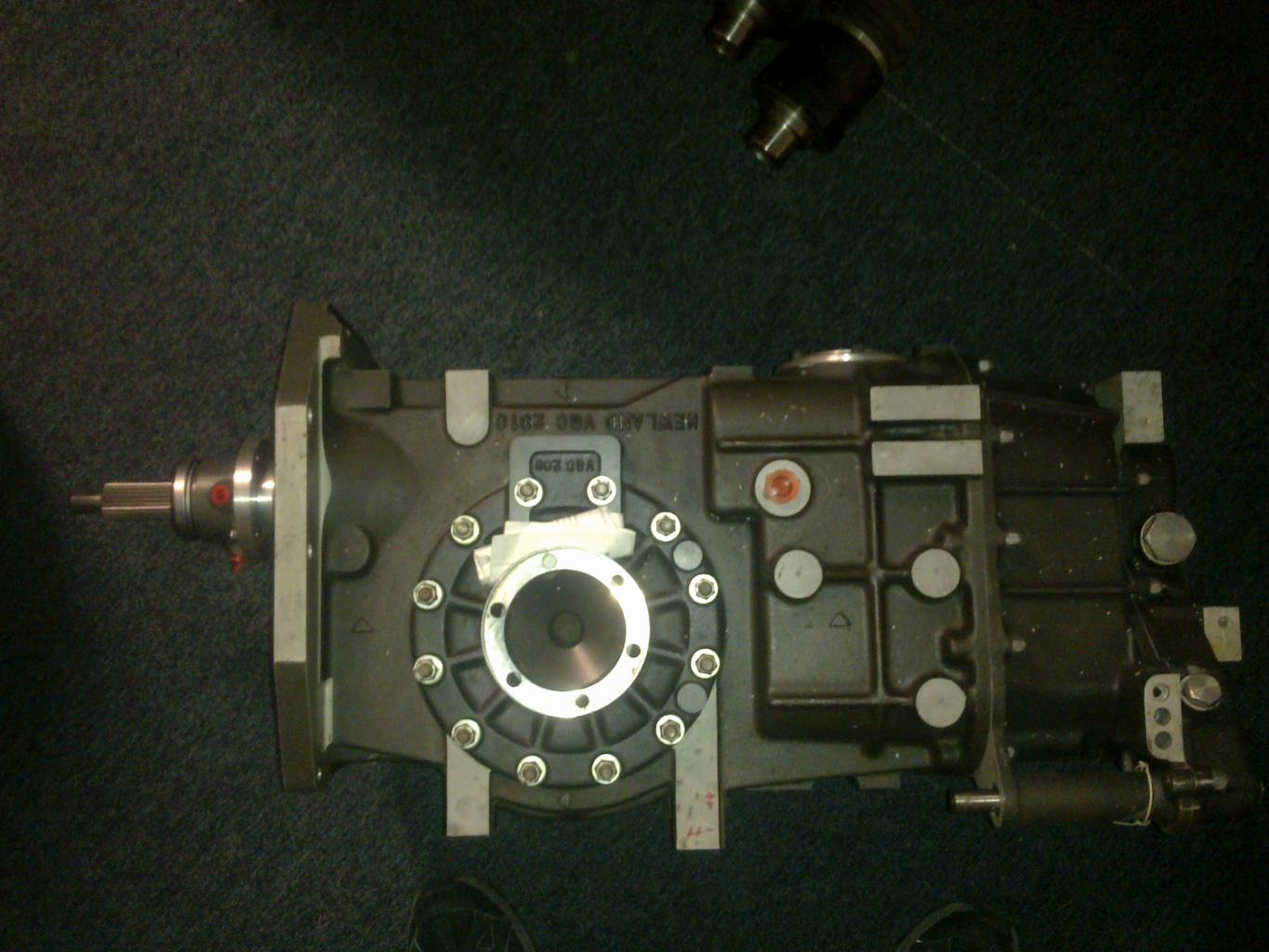

To keep things in perspective a standard G50 will cope with 500 hp without too much trouble and we ran a G97 with 700hp and no issues...and a used G50 can still be purchased for $3500-4000 all day
Fran, what do G97s usually cost? Do you see the G97s as the best option for about 560 whp and 570 rear wheel torque?
Matt.
G97/50 or GT2 /GT3 boxes will handle that with no problems...they are around 12k refurbished....Contact Erik at Gbox...I know he has some inventory
But how about hewland vgc?seems to be good til 1100hp

Question.. Fran, you mentioned using the g-50/97 transmissions in this car..
What do you know about the cost to modify one of these to handle a 1000-1200hp application? I know someone is doing it, as there are a few protomotive 997tt running around with 1200hp and a couple 9ff cars in the 1100-1300hp range..
And what exactly will it take if you were to say install a 2000hp tom nelson lsx engine in the slc? Is there a transmission/transaxle available to handle that? I mean, you see most of his cars use 3 speed automatic drag racing transmissions.. except i know of a 1800hp mosler mt900 he built that had a 6 speed of some sort. I believe it may have been sequential..
I say this because my dream is to build a standing mile/roll race/top speed dominant slc powered by a 441sbc or 454lsx race gas warrier twin turbo built by nelson racing engines. and even in low boost are capable of 1200-1500ft/lbs of torque on pump gas!

The Porsche gearbox is a great choice just due to the fact that when (Not if) you do blow it up there are ZERO issues getting parts for the box. There are also strong internals out there for a box. I myself really like GT gears internals. Much stronger then stock, you can pick what ever ratio you want, you can mix and match between straight cut or helical and their primary shaft which contains 1st and second is much much stronger. It will cost you about 15g to do an all options box with one of Guards limited slips. GT2/GT3/Cup Gears | Guard Transmission
