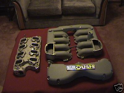

For the racers who want peak power up in the 7000,s, it seems a carb. on a high rise manifold/big plenums is the way to go (Ron Earp?) or really huge diam. intakes with low RPM drivability problems?
I am hoping that this manifold system will solve this issue.

Lynn. That's a wild looking manifold, but I'm not sure what goes on top? Where/how do the 8 T/B's go, or is it a dual Carb/throttle body set up? Also, will all that fit under the clamshell?

Mike,
The part on the left goes beween the heads like the manifold for weber ida/idf carbs. The part on the right, with the runners, bolts to the valley manifold and accepts EFI injectors. The plenum that says Roush, connects the two large D shaped orifices on the runner section. What you can just see the point of on the "Roush" plenum is the large throttle body boss that is clocked 90º to form a diamond rather than a square with respect to the horizontal (or vertical for that matter.)

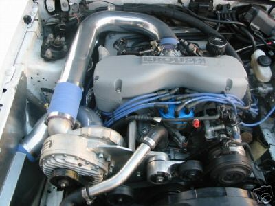

Below is a photo of one mounted on a Mustang that belongs to a buddy of the guy I bought mine from. As you can see, he is running a super charger through it. The way the Jack Roush Stage III mustangs set it up was with a cowl intake with a large K&N flat filter. As you can see also, this manifold would lend itself perfectly to placing two turbos just behind the 4-into-1 collectors of a "bundle of snakes" and routing the compressor outlets straight forward into the throttle body. (Down the road, maybe.)
