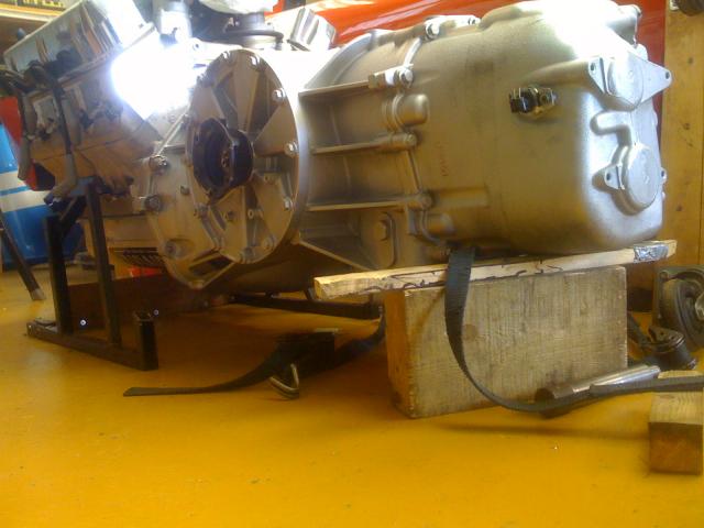

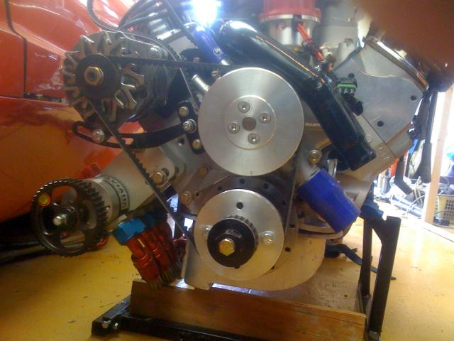

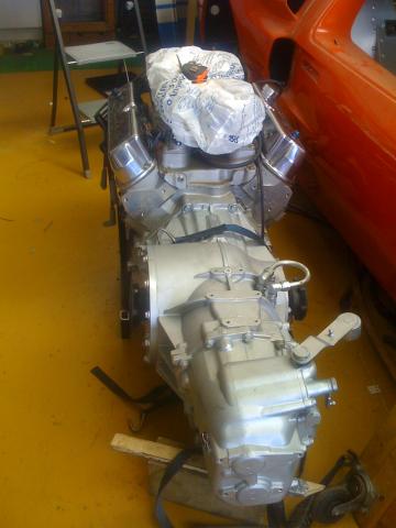

Was working on Bjorn's GTD refit this weekend and took a snap of trans/motor joined. This is with the twin-plate AP clutch / flywheel that Fran also supplied installed.
Lots of wiring being sorted at the moment, then motor/trans going back in next weekend, then off to have new headers/exhaust system fabricated.
