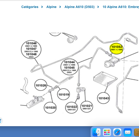

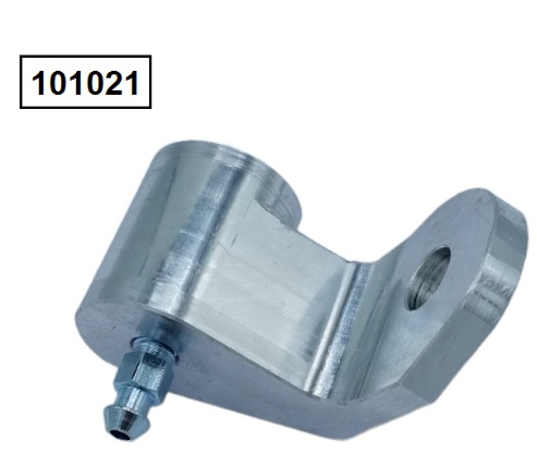

The remote bleeding of the clutch slave cylinder was implemented by Renault Alpine on the A610 in 1985
you will need to fabricate an adaptor as per nr 101052 in yellow and then you use what ever hard or flexible line to the final bleeder.
Paul
look at the website of Simon auto de alpine parts specialist
