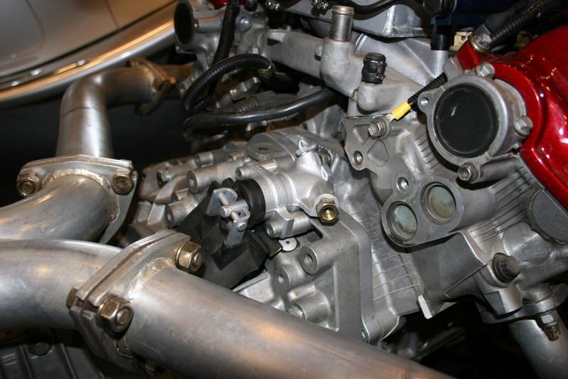

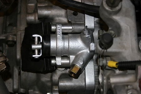

This is a UN1 attached to a 1uz same problem but the builder overcame it and it worked no problem. In a Countach Replica made here in NZ
