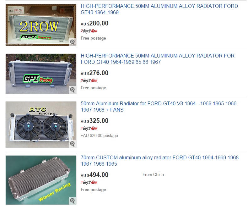

There's a few on ebay
Don't know if they are any good ????:shy:
Cheers KevinB

I've looked at these radiators also. There is also another one marketed that it can be welded and is supplied with the outlet/inlet not fitted at all. They look as though they all come from the same Chinese supplier. Would be interested to hear aslo if anyone has experience with these.
I had a special rad made up of my own design for the 5000 by Winner racing in China, and there service is great, easy to deal with, and the product is as good as any others I've seen, very happy
cheers John
