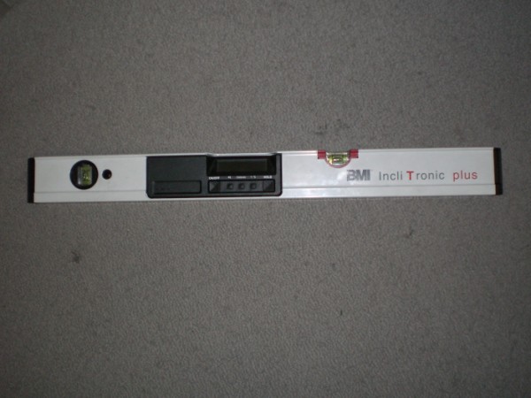

I spent a whole day yesterday working on the suspension setup in preparation for the race meeting this weekend. My friend Lindsay who is a real
setup Guru has been telling me for quite a while I haven't got enough negative camber, and I'm only using 1/2 the width of the tyres during cornering, hence I have uneven tyre wear and in Lindsay's words" you've paid for the whole of the tyre width, why not use what youv'e paid for?" Boy I have to agree with that statement. Also I've been having to rotate the tyres on the rims to average out the uneven wear. Ok so we started making adjustments and I was taking camber measurements with my trusty level when I must have bumped a button on it because it no longer was reading from zero when in the vertical plane. This got me thinking and I had to pull out the instructions. It took a while but it finally dawned on me there are 2 scales 1/ angle in degrees and 2/ angle as a percentage of 45 degrees.
Now I had incorrectly been using the percentage scale and all my readings in the past have been incorrect. What I thought was 3 degrees neg camber on the rear wheels was in fact only 1.7 degrees. Not an earth shattering discrepancy but enough to destroy handling in a racing environment. I will post a pic of the level for others to be careful of this and add that I now have 2.5 degrees negative camber on all 4 wheels and it is definately correct.
Ross

Thank's for the update and correction Ross.
Interestingly, you are now running rear camber closer to my car (3.25).
I also have 2.5 on the front.
It seems all roads may lead to Rome after all. :)
I have found the rear end to be much more progressive in corners, with extra grip; the only downside perhaps a loss of straight-line traction.
Tim.
