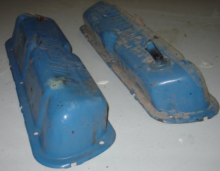

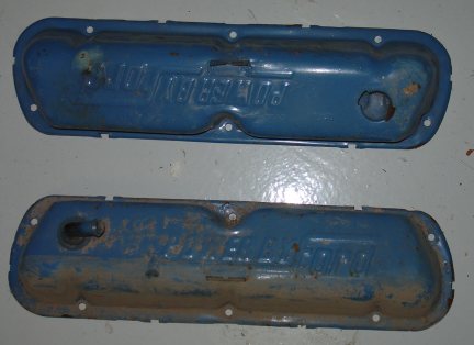

I picked up a set of old Ford valve covers and only now am wondering if a newer set of heads will fit under them? How about AFR 185's with a stud girdle? If not, does anyone macke a spacer to fit between the head and cover?

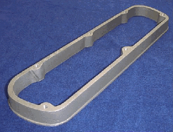

Well here is what I was looking for! A bit pricey (5 times what I paid for the valve covers), but looks like they would work. Anyone have any thoughts on this company?

I used an extra thick v/c gasket years ago on my chevy 355 ci circle track car.My engine builder supplied these to me and stated I must use that height to clear the rockers with standard height covers.You may ask around the parts world to see if these are available for ford engines.

How about a "no name" tall valve cover that will clear most everything. They are 1/2 the cost of the standoffs and you won't have two gaskets to seal. Look in Summit catalog summit part number SUM-G3322 $69.95 www.summitracing.com

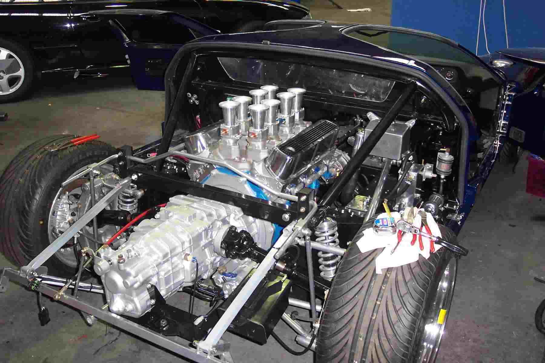

I used Edelbrock cast covers on my AFR's - they are polished with black between the fins on the top & you can get them with or without the Edelbrock logo. They are quite a bit higher than the stamped covers, so should be ok with a stud girdle.
Kind Regards,
Peter D.

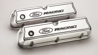

Changing over to polished Ford Racing covers.

Picture of Ford M6582-E302 rocker(valve) covers below:
