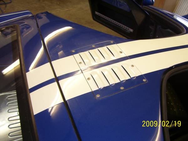

Is this the sort you refer to?
I have this one on my MkII

Thats the one,yours is 4 x 2 rows , some seen are 5x2 rows.
looks nice
where can I get one or similar ?
My item came from a forum member in the US who responded when I asked the same question.
I am not aware of any commercial source but a good metalworker may well have a louvre cutter and be able to make one. I was going to try my hand at ally forming when the item came up.

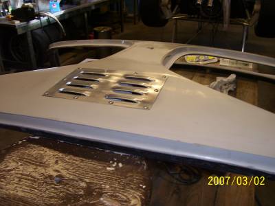

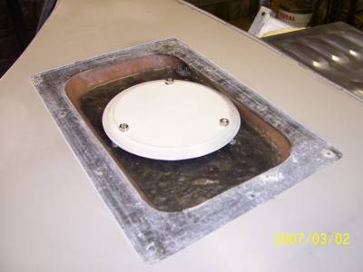

Here are some pics of the interior vent and the drain for rainwater I formed between the inner and outer skins of the spider. The drain pipe passes between and the pipe ends below the car. It works OK as yet no water has entered the car from the vent.
