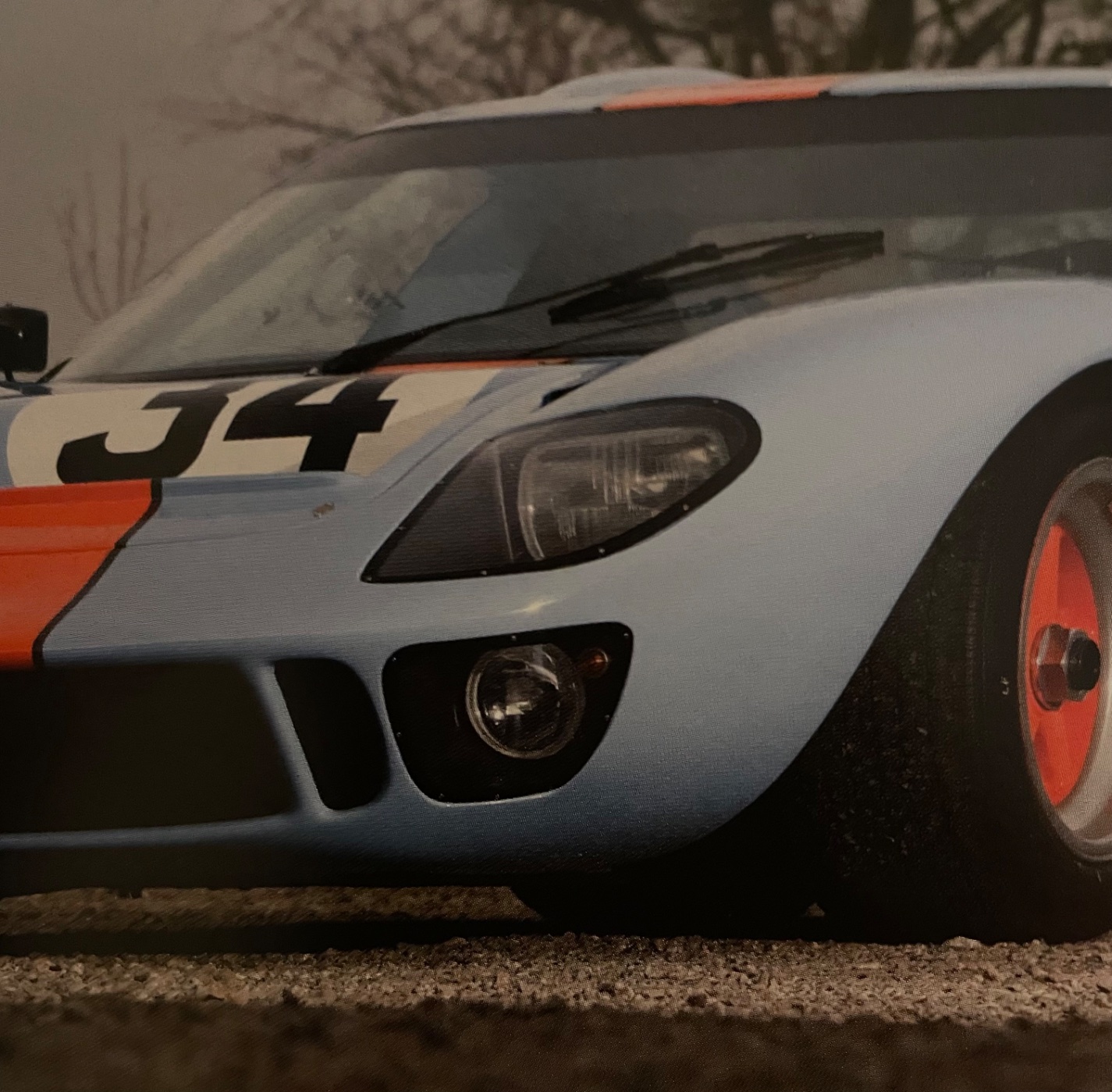

The best info I found was in the Hayes GT40 Owners’ Workshop Manual (which is actually a very nice historical overview of the GT40).
Unfortunately, from this photo I cannot tell what type or even brand.

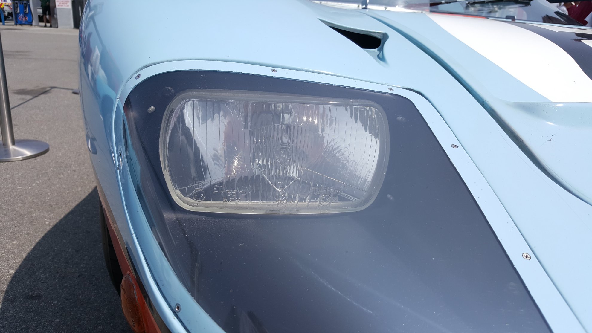

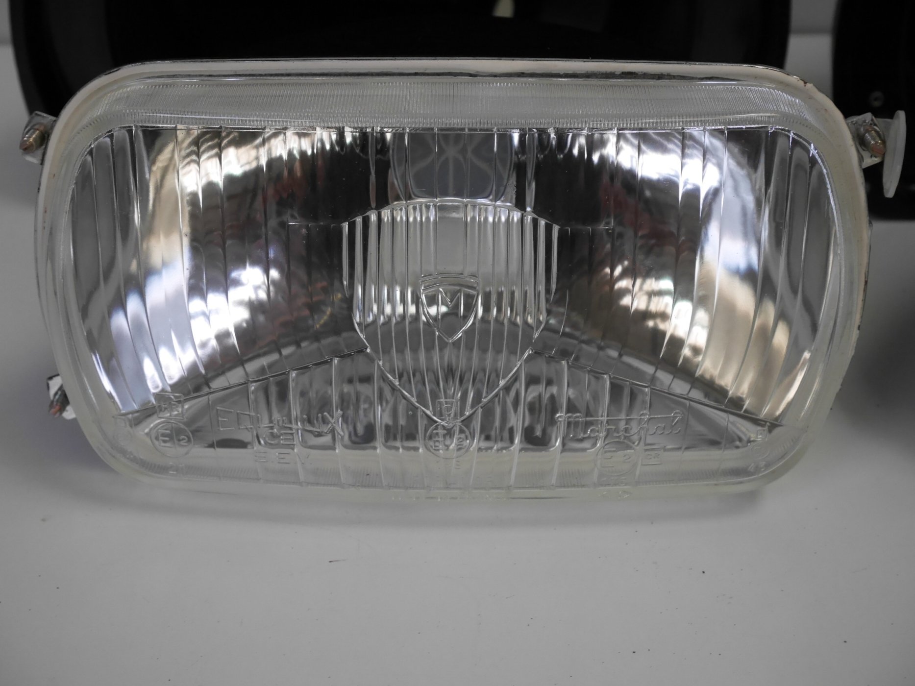

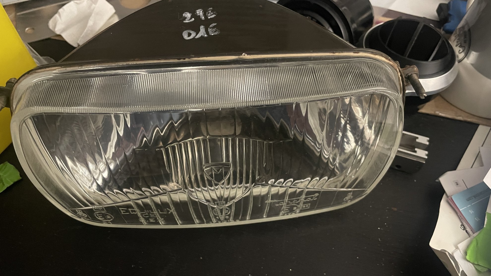

The original headlight used on all the cars was the SEV Marchal part no. 612-22303. Marchal made several variants of the light but this is the part number of the correct one. It has a switchable bulb holder for both left and right hand traffic pattern. It uses an R2 45/40w non-halogen bulb. The glass lens is 230mm across and 120mm high, shaped convex (out). if you look very carefully in the lower left hand corner of the picture below, you will see the "21" designation. These lights have become very scarce. Rumor mill said someone paid $10K for a set for a recent concours restoration........

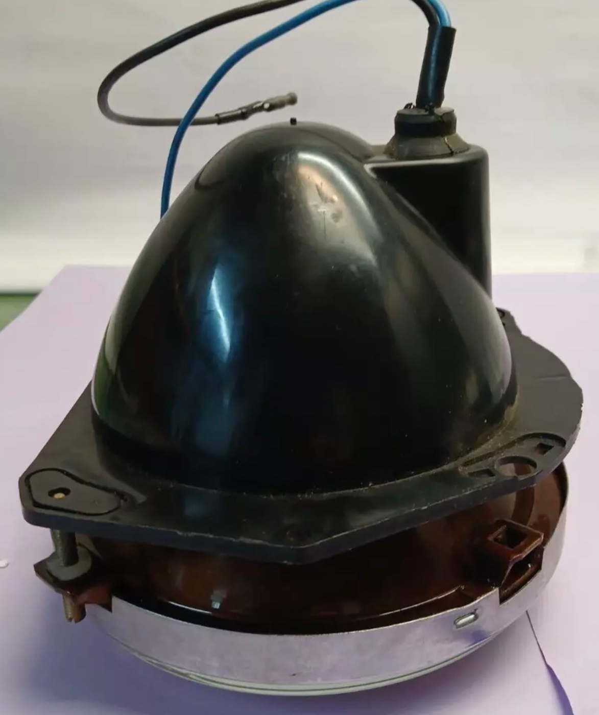

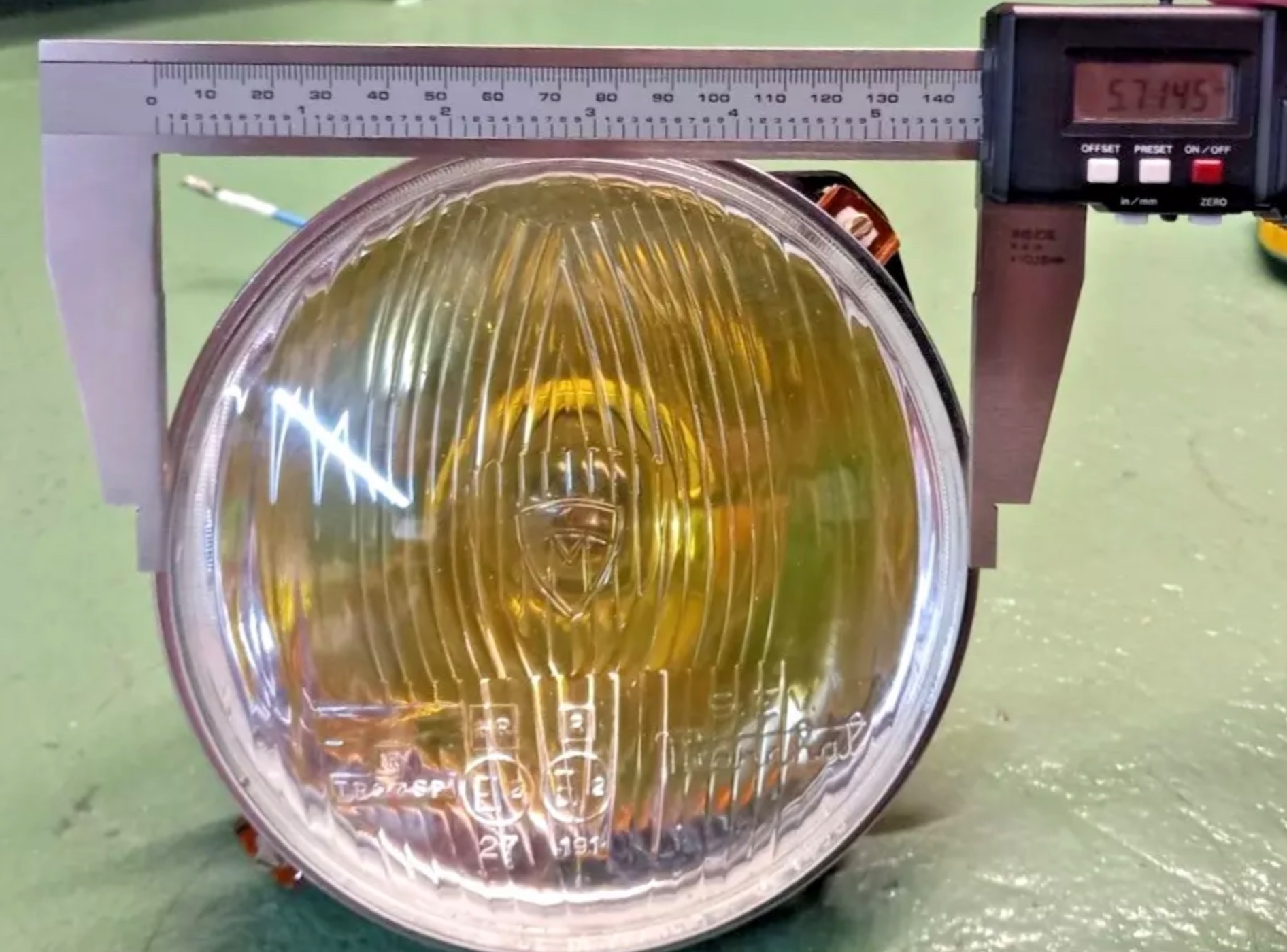

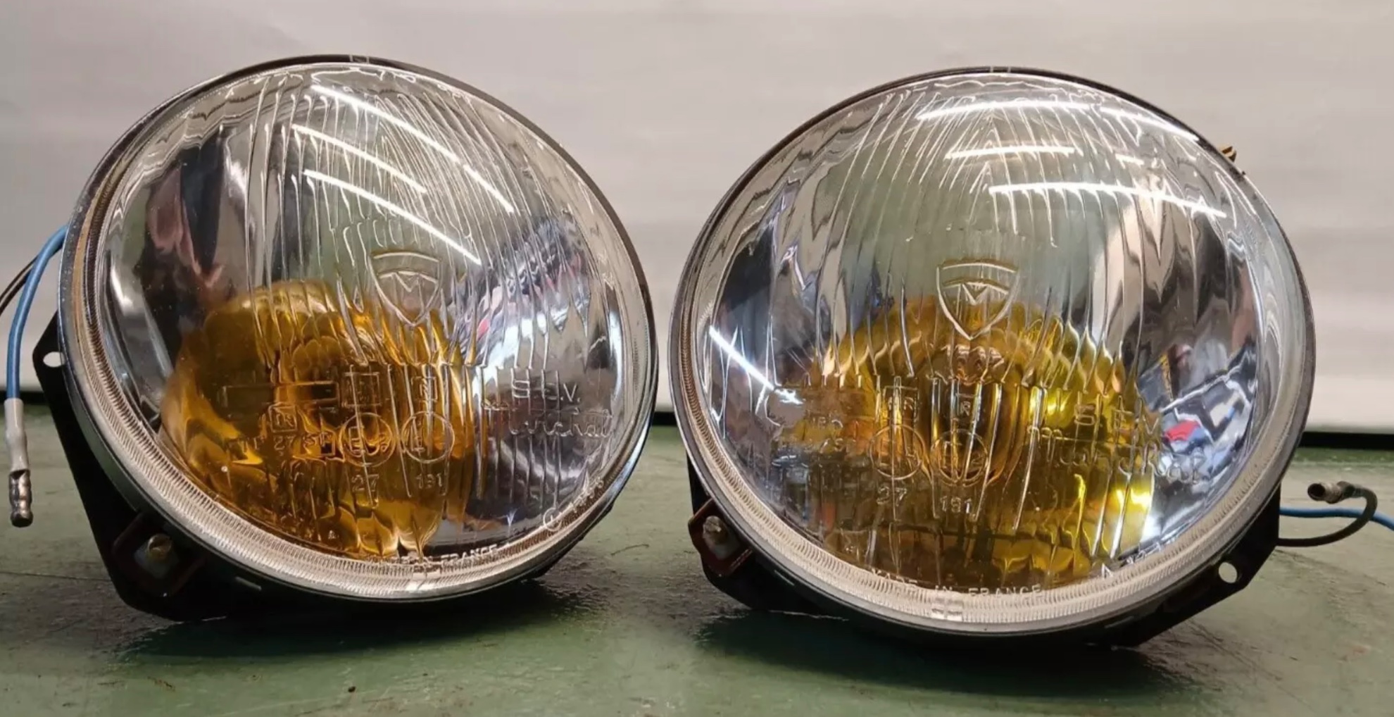

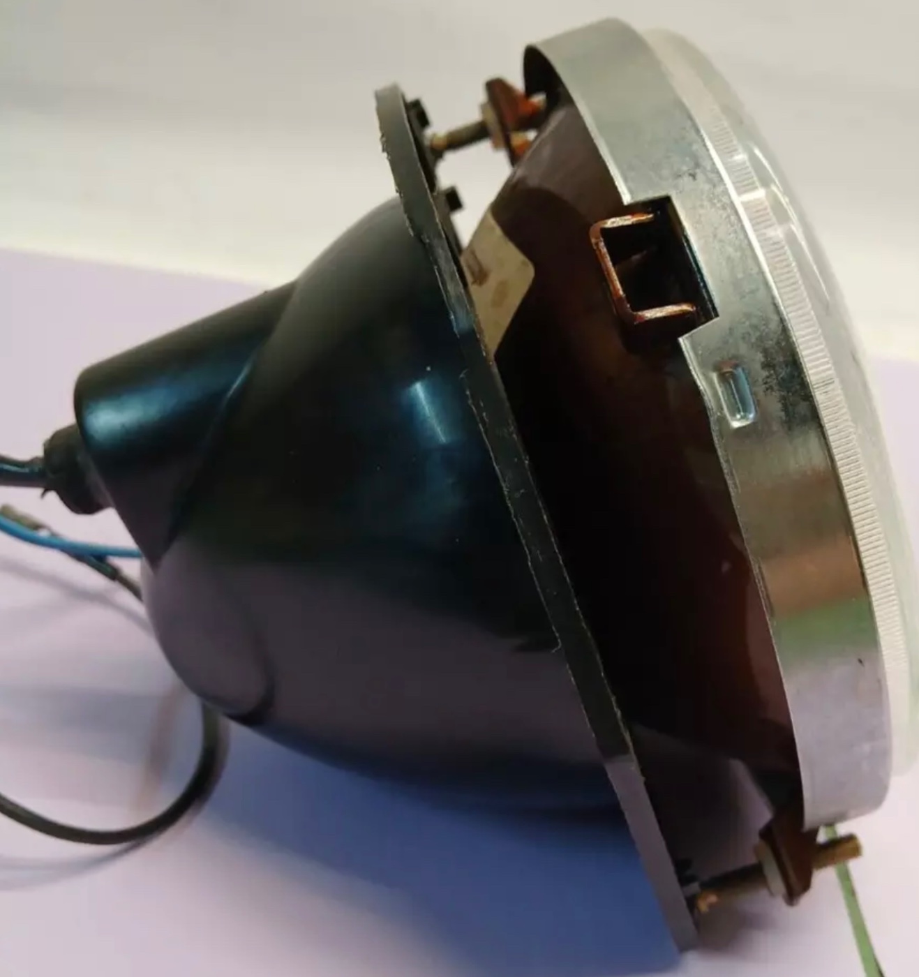

Hi, I have an original set with the matching mounting set as per the pictures attached. The lower 5.75” driving lights on the GT40 were also used on the following vehicles. All the best, Adrian
5.75" SEV MARCHAL
MAIN BEAM HEADLAMP
GLASS REF E2 191 TP 27 SP
PART NUMBER 61265403
WIRED UP AND WORKING
WITH PLASTIC MOUNTING BOWL (P/N
61323002)
THAT PROVIDES HEADLIGHT ADJUSTMENT
FITS
ALPINE A110 (1962-77)
CITROEN DS/ID (1955-75)
PORCHE 911/12 & PORCHE 901 (1964-73)
MATRA 530 (1967-73)
MATRA DJET (RENE BONNET) / JET (1962-68)
SIMCA COUPE 1000/1200 S (1962-71)
CG 1200 S (1968-72)
CG 1300 (1972-74)
