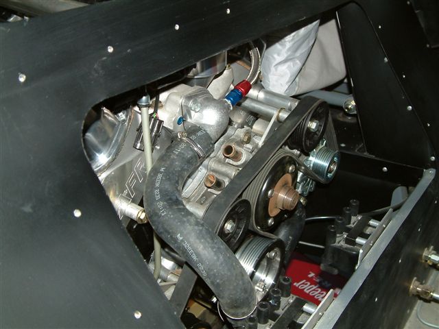

Two quick dumb questions. What to do with the heater ports coming off of the water pump? What are the fittings on the back of the intake manifold for?

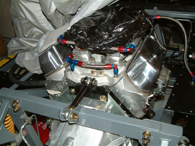

and the intake manifold? /ubbthreads/images/graemlins/confused.gif
Plug the heater ports, that is what they are for, you do not need them. Easier to do with the pump off the car. With the pump on the car, fit two short pieces of heater hose, then put a pipe plug in the end and secure with a clamp.
If you have the pump off the car you cut the pipes off, tap the holes, then put a pipe plug in the hole.
R
well, I was going to say water to take to the front to eliminate steam pockets, but you have those. And, since those brass fittings do not go into a water passage, since there is none there, then I don't know. I suppose those brass pieces go down into the lifter valley - maybe they are a vent. I don't know, never seen those on an injection manifold.
One guess - they are somehow tapped into the runners for each bank and can provide a vacuum signal. That would be my offical guess. Blow some air in there and see if you can feel/hear it come out in the runners.
Rolf,
The brass nipples have to be vacuum ports, assuming that the plenum runs the full length of the manifold. It seems kind of odd that they are at the back of the manifold though. /ubbthreads/images/graemlins/confused.gif But, remember how far South, Australia really is. They do everything upside down and backwards Down Under! /ubbthreads/images/graemlins/tongue.gif
Rober Logan called me from Australia tonight. The one fitting is vacuum the other is for a pcv valve. As usual the Roaring Forties support is superb. Thanks all for your comments and help. /ubbthreads/images/graemlins/cool.gif
You can buy heater hose caps rather than have to use a short section of hose with a pipe plug.
Rick Merz
Just a thought on the caps... I used them but I had both of them develop a pin hole leak after about 2 years, nothing serious but if you use them keep a spare set on hand.
