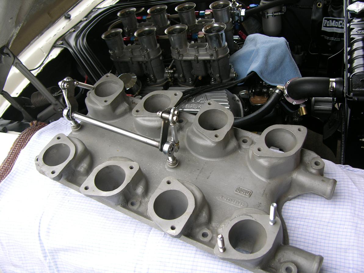

Weber intake manifold and potential cooling issue

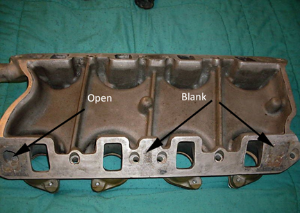

The intake below is a 289 FoMoCo aluminum manifold (C6AE 9425-A) for the Weber 48IDA carbs, and the only head to manifold water inlets are the front two; all the other water inlets from the heads are blanked, and there was never any provision for getting the water from the rear of the heads out. I used to figure the engineers at Ford knew best, but I have come to think that the heat buildup in the rear of the heads could lead to steam pockets, poor cooling overall, and detonation. It just seems odd.
The only way I can see to get around that would be to drill passages through the manifold interior to the area of the water passages in the heads and run tubing from there to the existing outlets at the manifold front. That seems like a big potential source of failures in itself, and I'd hate to come up with a failure prone solution to a non-existent problem.
Thoughts?

The fundamental error that led me to ask the question was thinking coolant flow through the manifold was necessary. After more reading, I think this is what seems to be the case.
1. The rear water port in the 289 head was there to permit them to be interchangeable left to right. The only time the two rear ports are connected ordinarily is to permit fitment of an additional water temp sensor, not for circulation of the coolant, since flow is through the heads from the rear to front. (For some reason, I had thought there was circulation through most intake manifolds.) Frank, I'm assuming your caution to use small tubing if connecting the front and rear head passages is to avoid diverting very much coolant from around the 2-3, 5-6 cylinder water jackets. Is that close?
2. The "steam holes" aren't actually for steam, they're to allow the heads to "burp" air when coolant is added. most say an important passage from block to heads, heads to manifold, not at all.
3. Mark R Is correct in that the holes I miss-identified (and show blocked off on the manifold center) are exhaust crossover ports which improve warm-up of the manifold. (Why that would be helpful in a pre smog-controlled era is not at all clear to me though). Anyway, I confused them with the infamous steam holes, so Ron, may I edit and re-label the photo to avoid misleading anyone in the future?

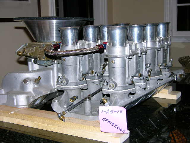

I too had these thoughts of a potential hot-spot bubble in the system (back of the head). I own both the Cobra Weber manifold and the C6AE. I had both sides of the Cobra manifold drilled and tapped for a (3/8 NPT) radiator petcock. (see pic)
As it turns out, in retrospect I should have never don’t that. It is totally un-necessary. If you think about it, the head gasket is blocked towards the front block to head surface. The direction of coolant flow is; water pump to front of block flowing towards the back (flywheel) up through the head then forward out of the front of the head. No issues what so ever. The next time the manifold comes off, I’ll have the holes plugged and welded closed.
Cheers,
~Earl J
