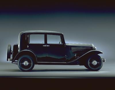

monocoque is italian!!
The FIRST moncoque car was the Lancia Augusta,done by Vincenzo Lancia, 10th April 1934rockonsmile
Registro Lancia Augusta

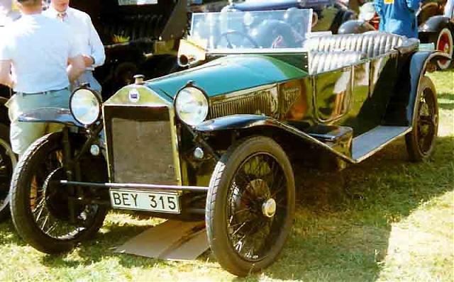

from wikipedia.....
"The first automotive application of the monocoque technique was 1923's Lancia Lambda. Chrysler and Citroën built the first mass-produced monocoque vehicles, both in 1934, with the innovative Chrysler Airflow and the Traction Avant, respectively. The popular Volkswagen Beetle also used a partly monocoque body (its frame required the body for support) in 1938."
