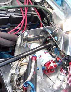

I would guess everyone is right with their answers here. When I bought my car, the builder told me he had fitted two separate switches for the pumps instead of a right one on or left one on type switch. He told me he used to switch the pump off slightly before he got anywhere on a hot day so the fuel was drained from the carb and refilled with fresh, colder fuel on startup.
Also he fitted two polished ali "guards" either side of the engine (see pic, rhs shown) to cut down on the radiated heat from the manifolds.
