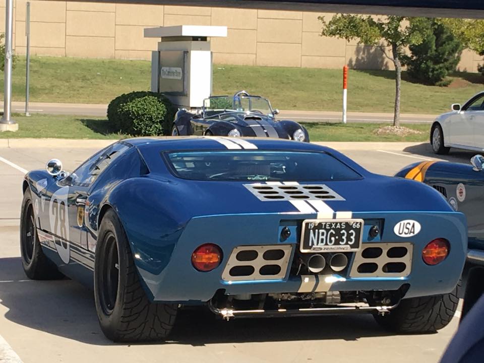

To each their own I suppose. Other than the wide body Gulf cars you never see the original MkI's running wide rubber like 225/295. These cars look better running tires with less width in my opinion. 215/275
I'm running 215 front and 275 rear on my GTD (standard body), I initially ran 225 front and 295 on rear, but I found them too large. I'm happier by far in 215 front (no more rubbing in the arches), and in 275 the tires are more inside the rear arches. Better looking, IMHO.
Thanks all for your input. I always like the the way the earlier GT40s look with the big tall tire in the back.

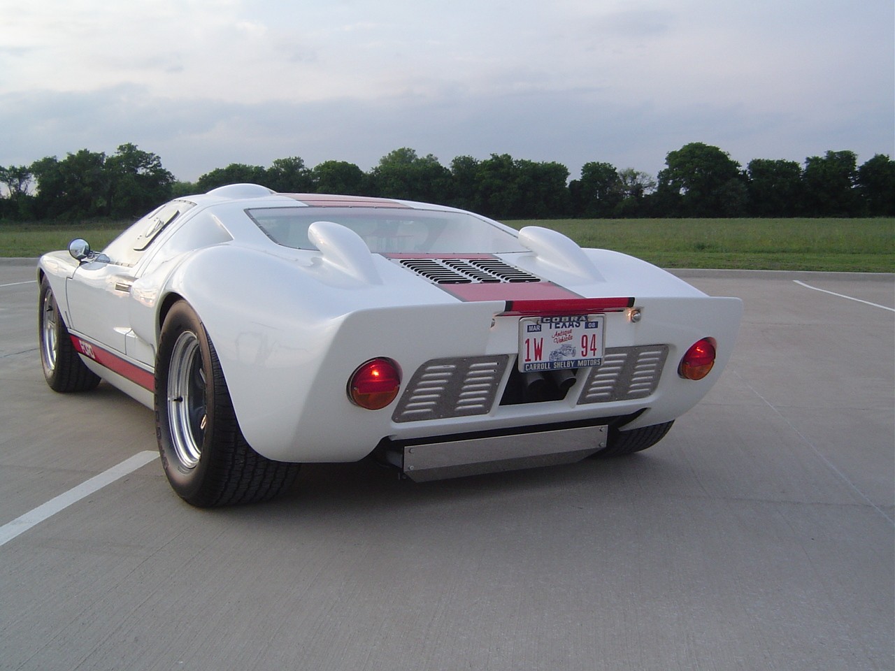

Hey Gary.... Doesn't Eric have your old GTD?

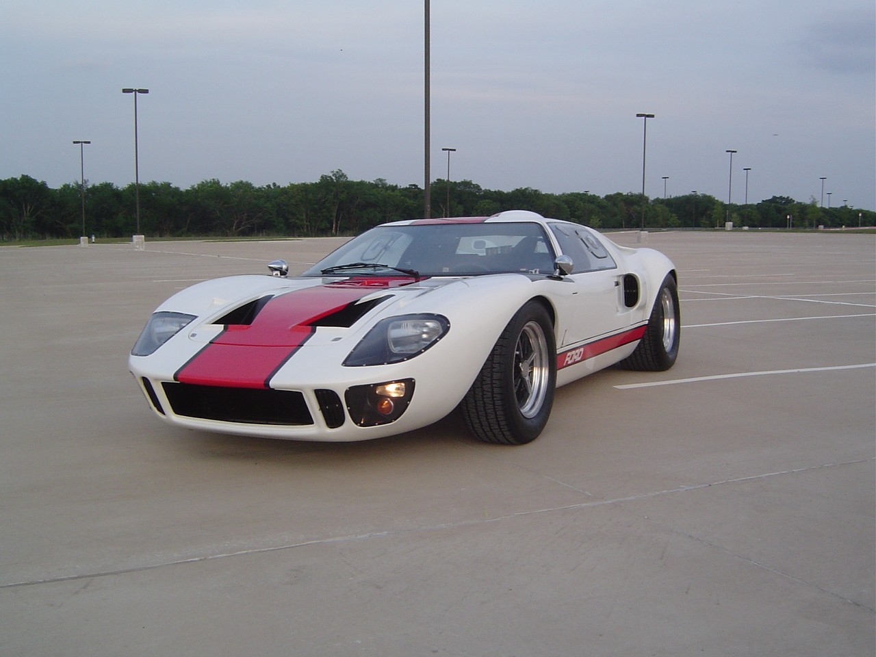

Wide hip on my car, 295s and 215s! Still love them!
Pretty sure that is my old GTD GT40 as it went to the east coast. I traded it for a Kirkham FIA 289 back in 2005 but not sure what the gentleman's name was. It was really a nice car one of two show cars GTD built to show in the US to sell their cars.
