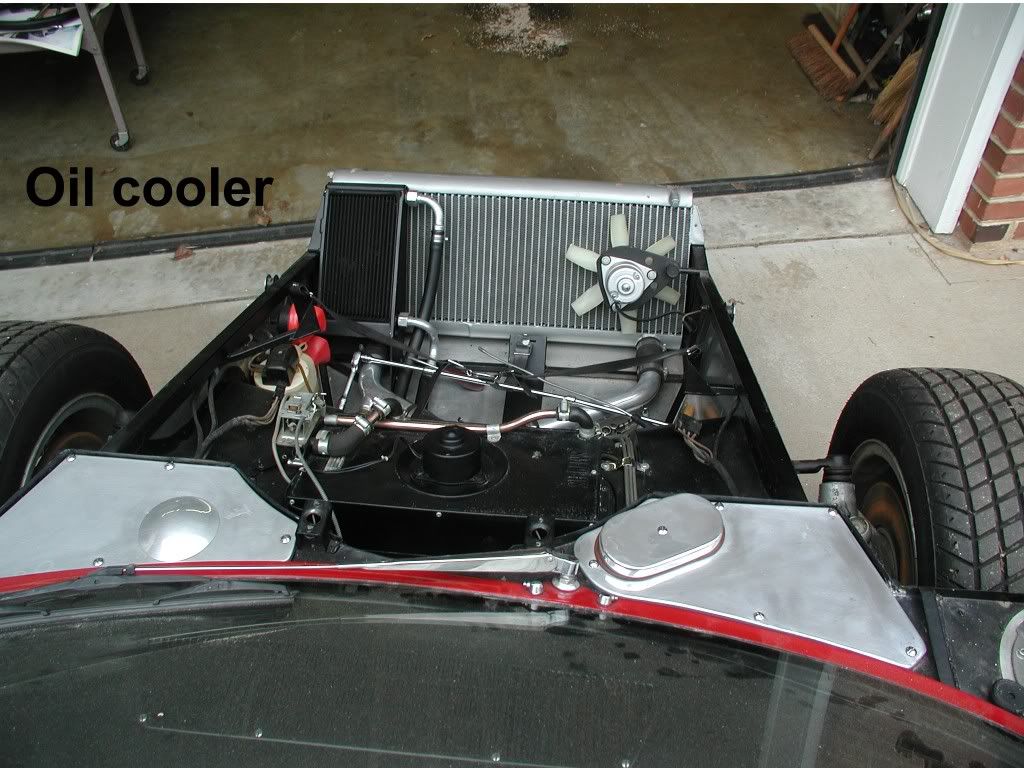

PS, my kirkham had a 550hp small block and a oil cooler in the nose - the oil cooler was never hooked up. I know the previous owner drove the car REAL hard.

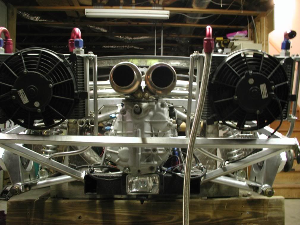

Most of our cars don't need coolers. If you add a diffuser, then you might need one. There seems to be enough air movement in the rear compartment. I liked the bling factor with mine so I added a cooler/fan for both. The rear vents is a good place to put both as you have two there so use them. The originals had a smallish one in the front mounted on the radiator.
Mine are 12x8 with 9 inch puller fans with a stainless mesh screen.
You can control them with a thermostat and then you won't have to worry watching the temp guage. I did thermostat and switch as I had to dedicate a bunch of switches. I wired idiot lights into them as well because of the dash.
