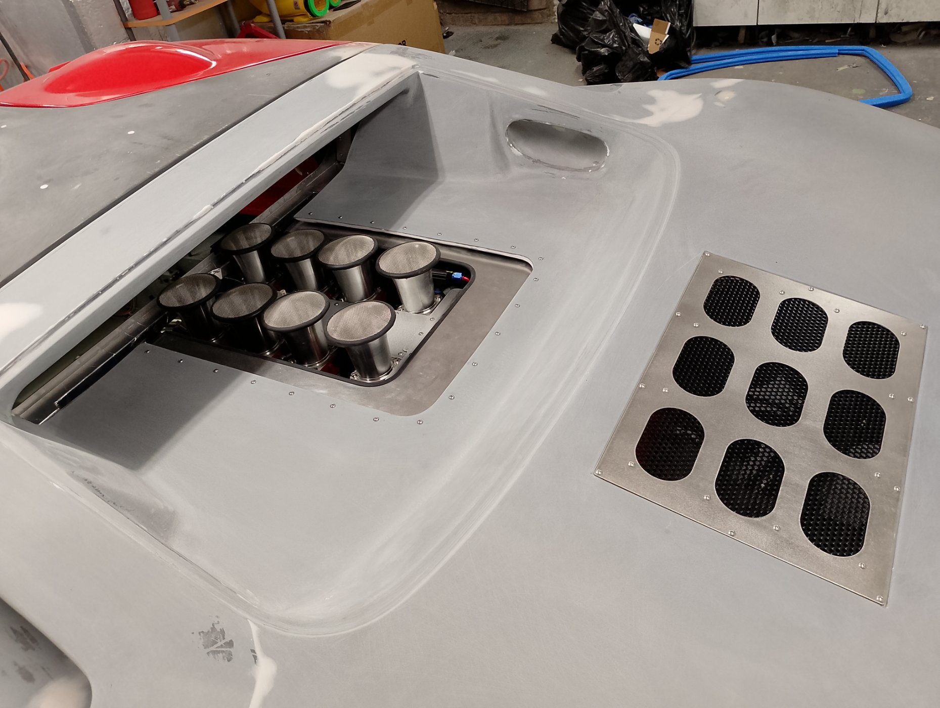

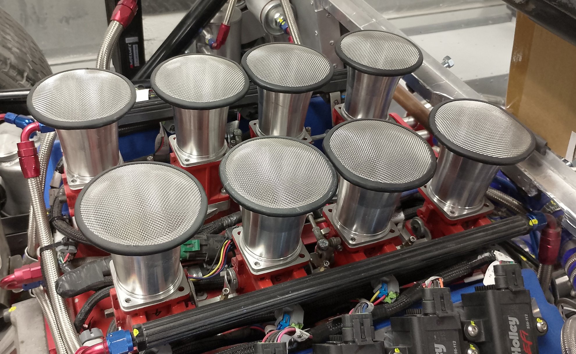

I decided that I needed some form of air filteration on the intake trumpets.
Not wanting to put huge air filters and cover up the trumpets i came up with an idea that might be of interest to others.
As this engine will be doing a low mileage I decided that I just needed something to keep out the large particles ( small stones. )
Again quite involved in making these so i have made a video and its here :
and picture below :

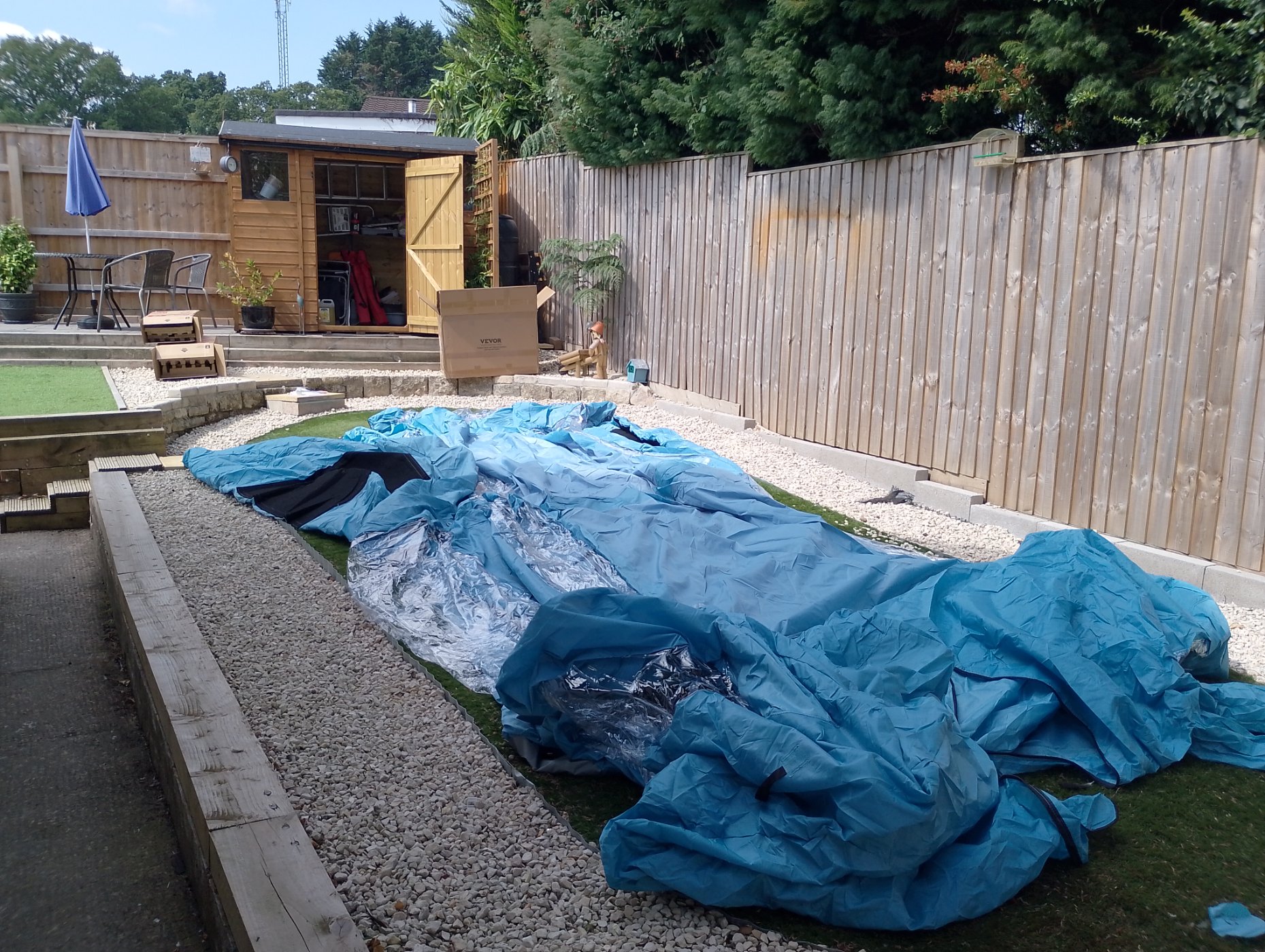

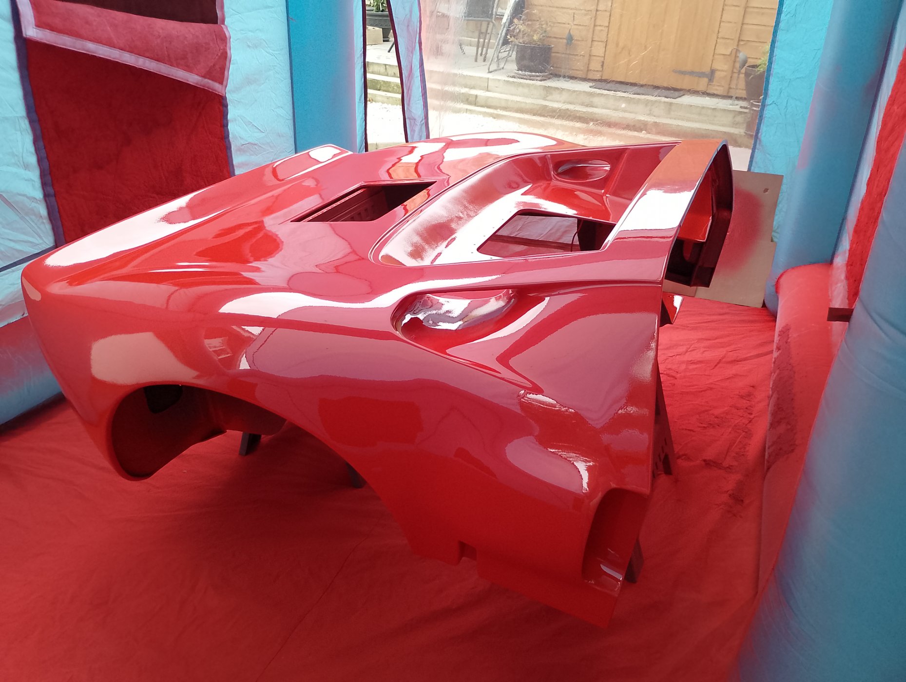

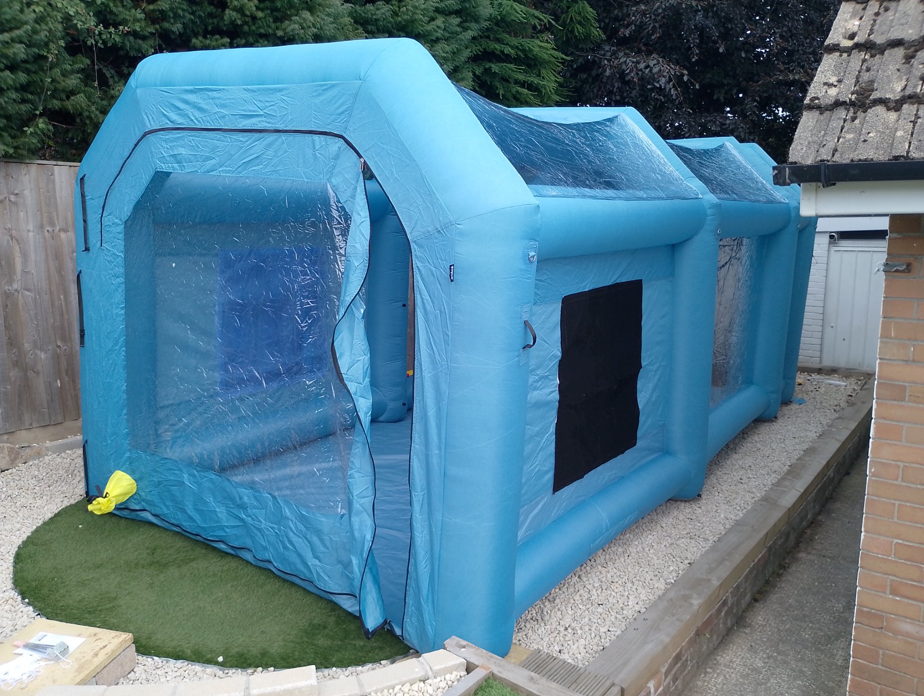

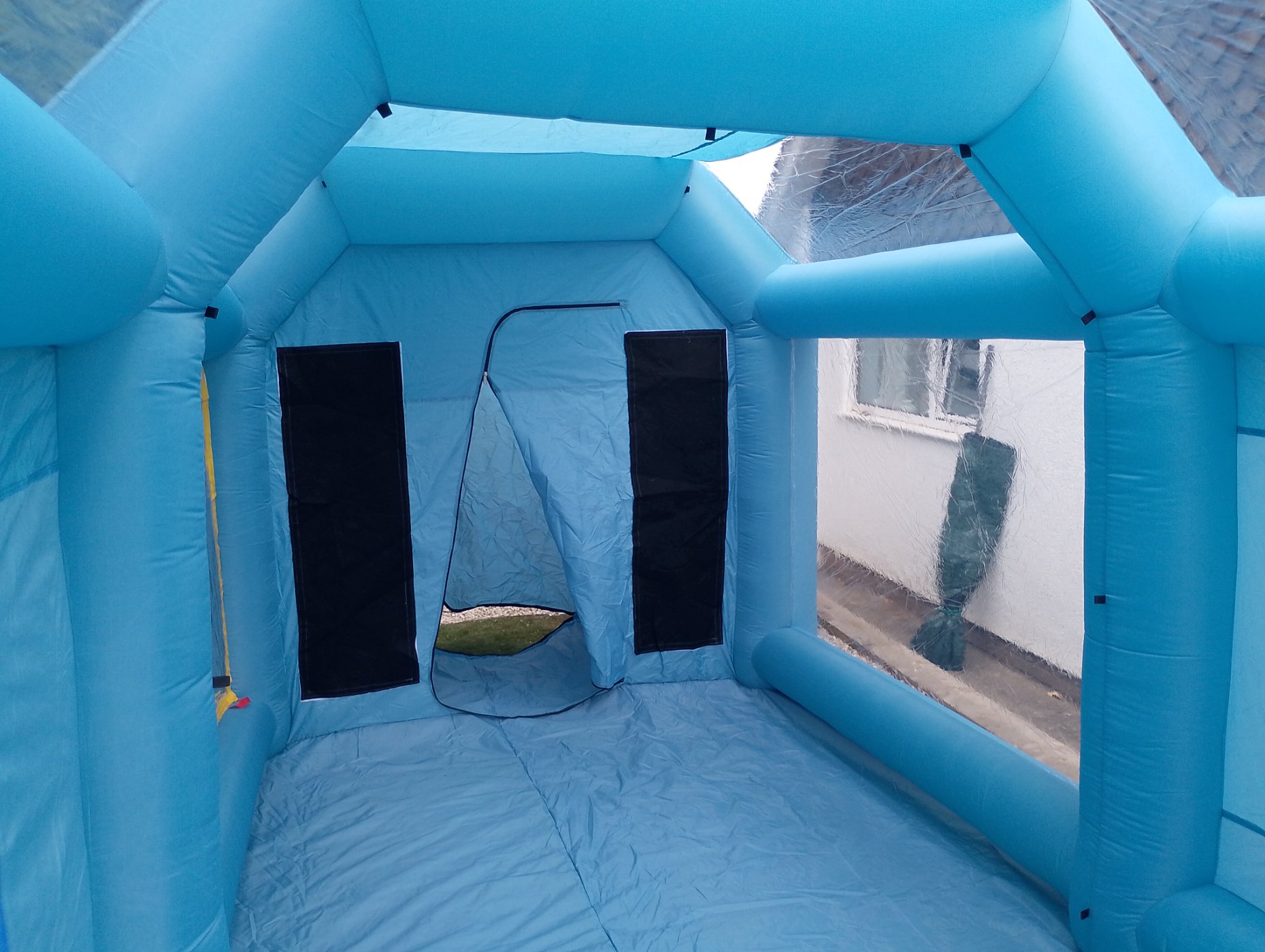

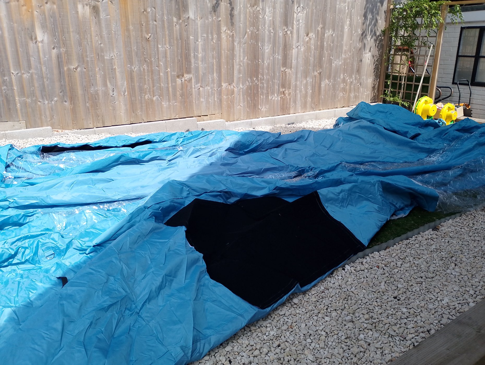

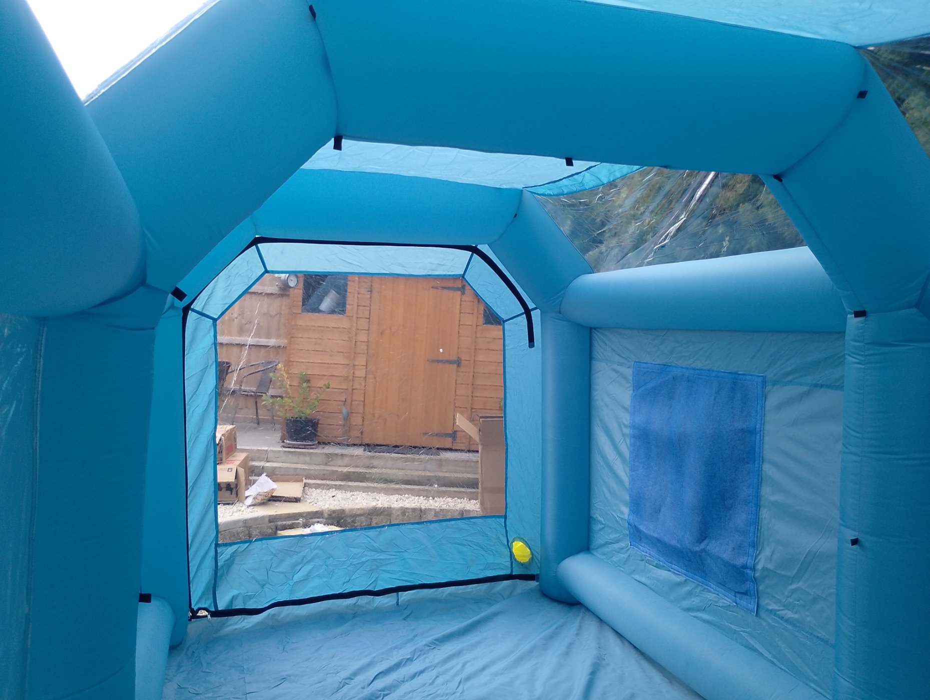

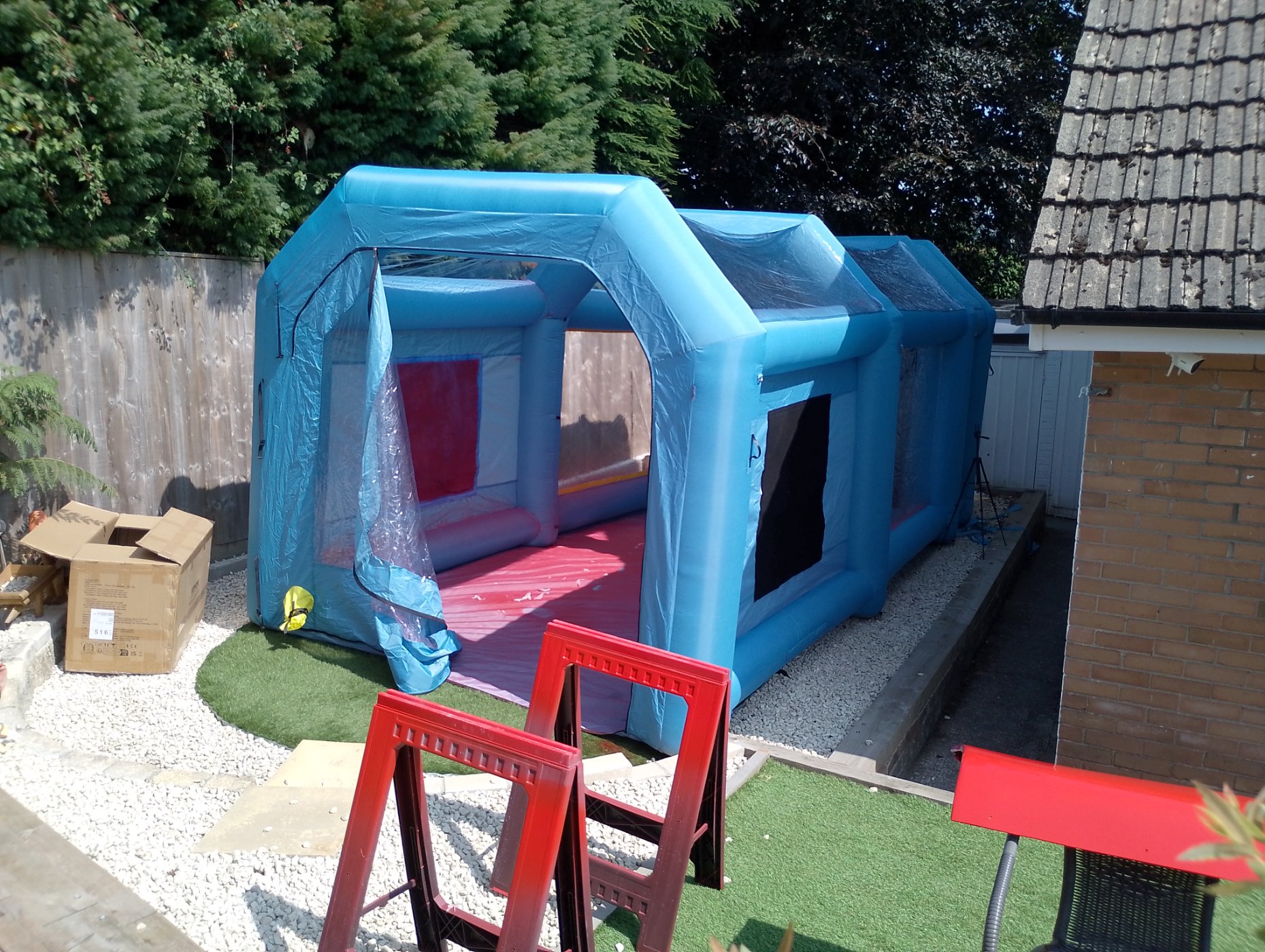

DecIded to have a go at some spraying as the weather is nice and hot at the moment...
Bought a VELOR 2 compartment blowup spray booth and an £80 spray gun...
Last time i did any spraying was 50 years ago....things have moved on since then so this is first attempt using a HVLP with the paint pot on top...!!!!!
Tent went up a treat
video is here :

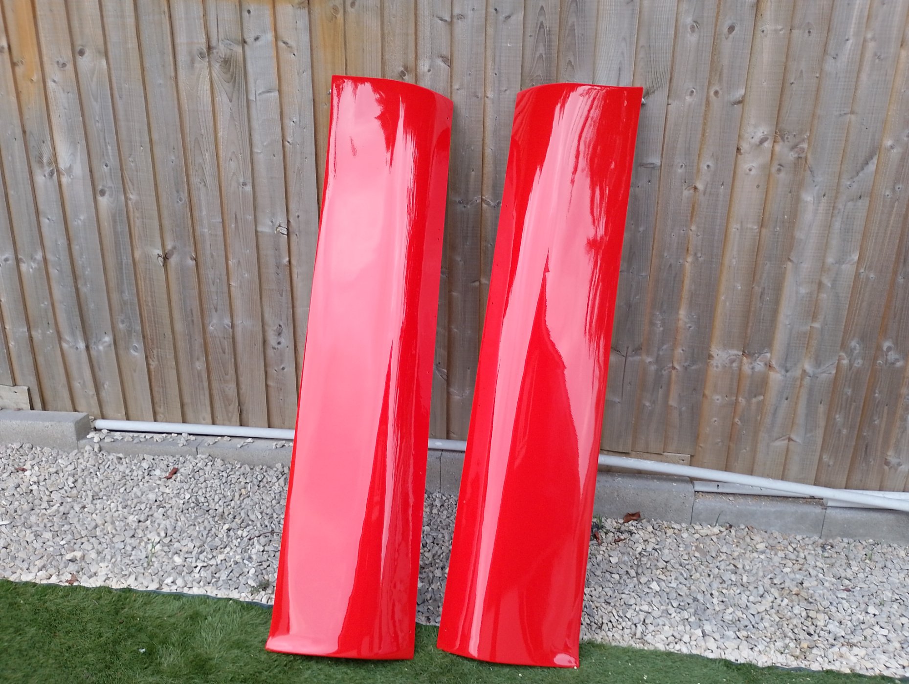

Spraying 2 part gloss solid red ( mazda red , 2 to 1 with 20% thinners ) so NO laquer required...

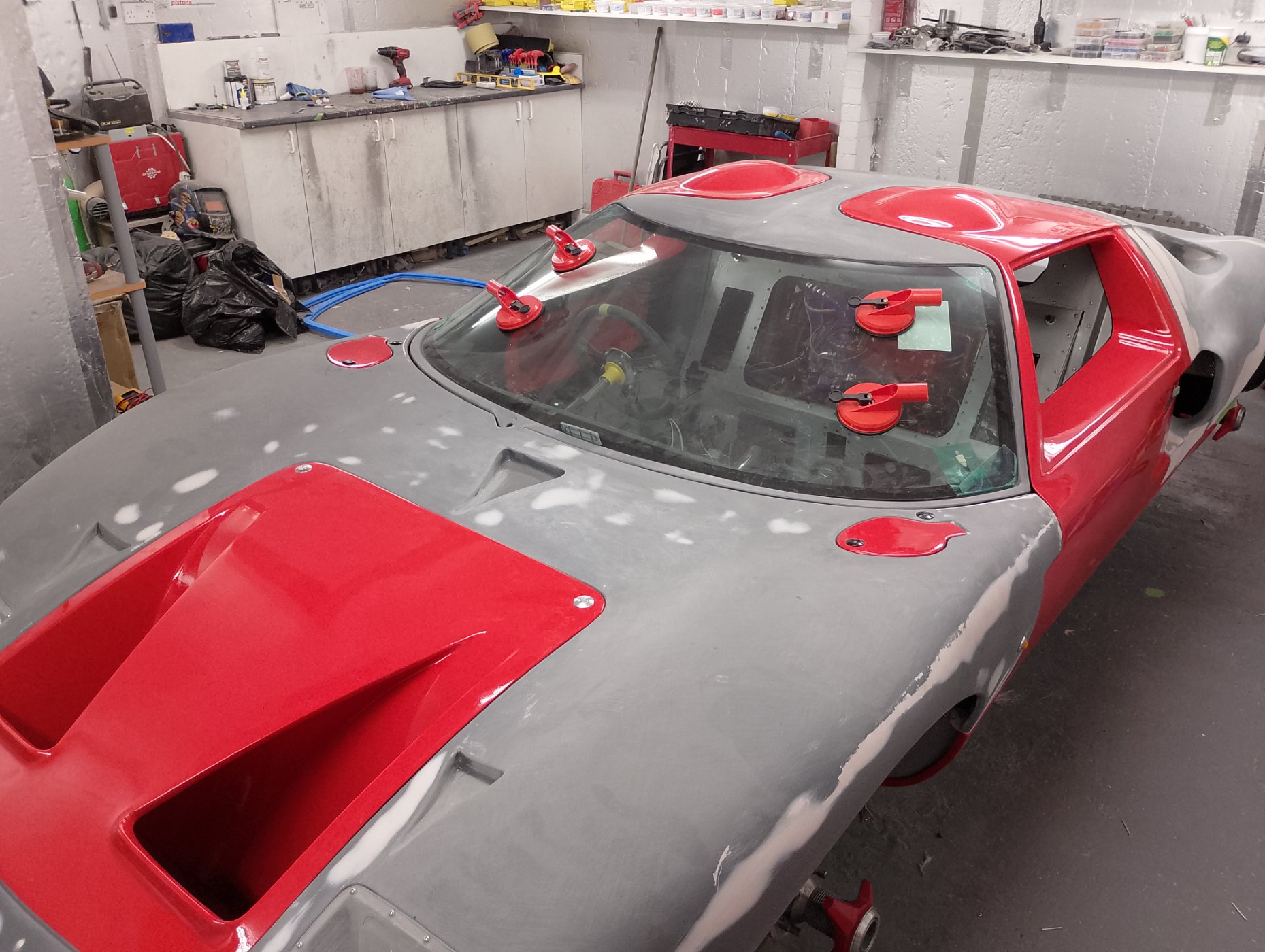

Thought I would try spraying the sills first as a nice uncomplicated shape.
filled and sanded with 400 grit for prep.
2 coats of 2 part high build primer.....very orange peel effect.....lots of sanding ( too low pressure / too much paint. not atomising !!!
Changed gun setting for red coat...more pressure and less paint...
Laid down 3 coats allowing to flash off in between. in this heat wave about 3 minutes !!!
much better and a far better finish that i could have hoped for..
Will need a bit of work when finally cured but 100 times better than i had expected...
If the rest of the spraying comes out like this then i will be a very happy chappy.
some pictures below :

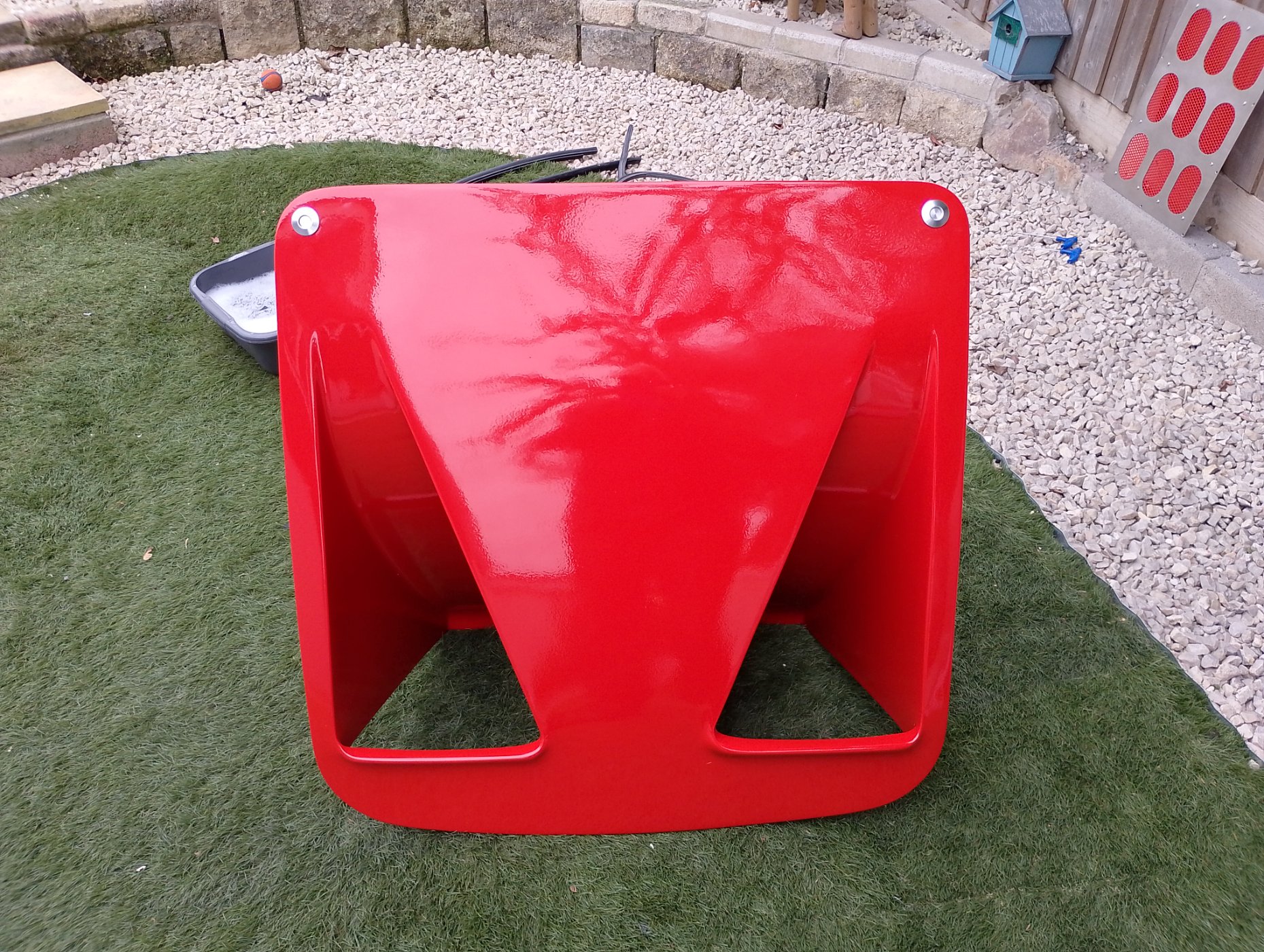

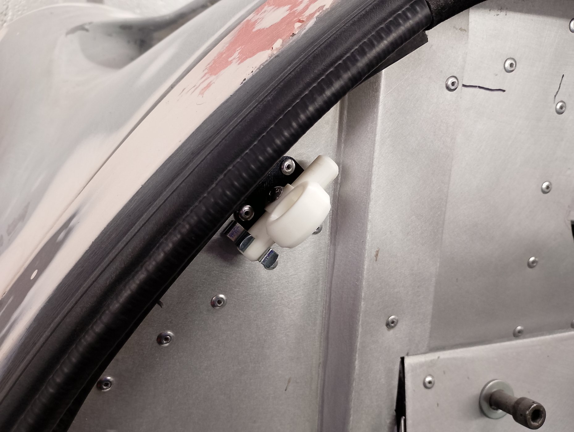

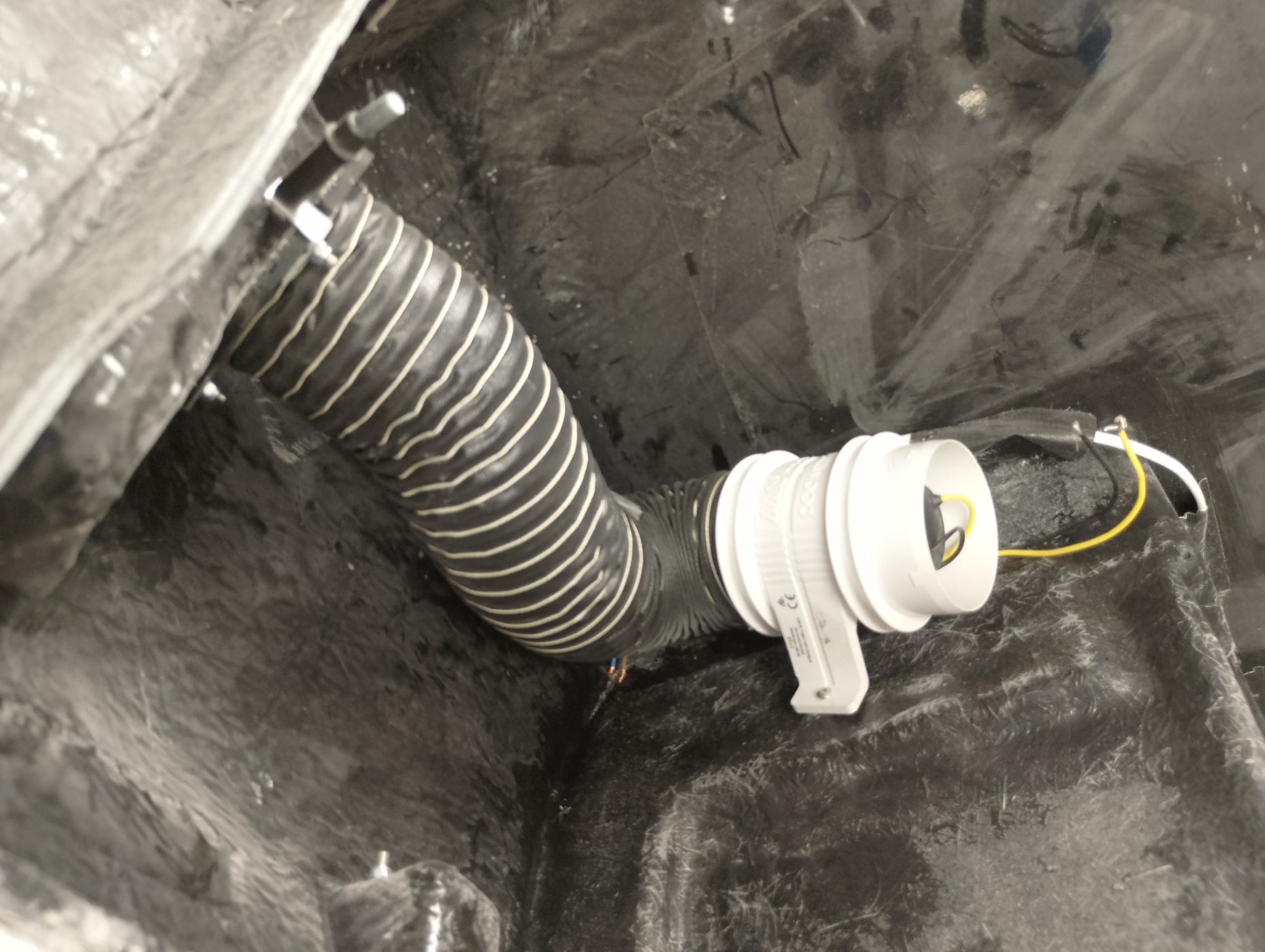

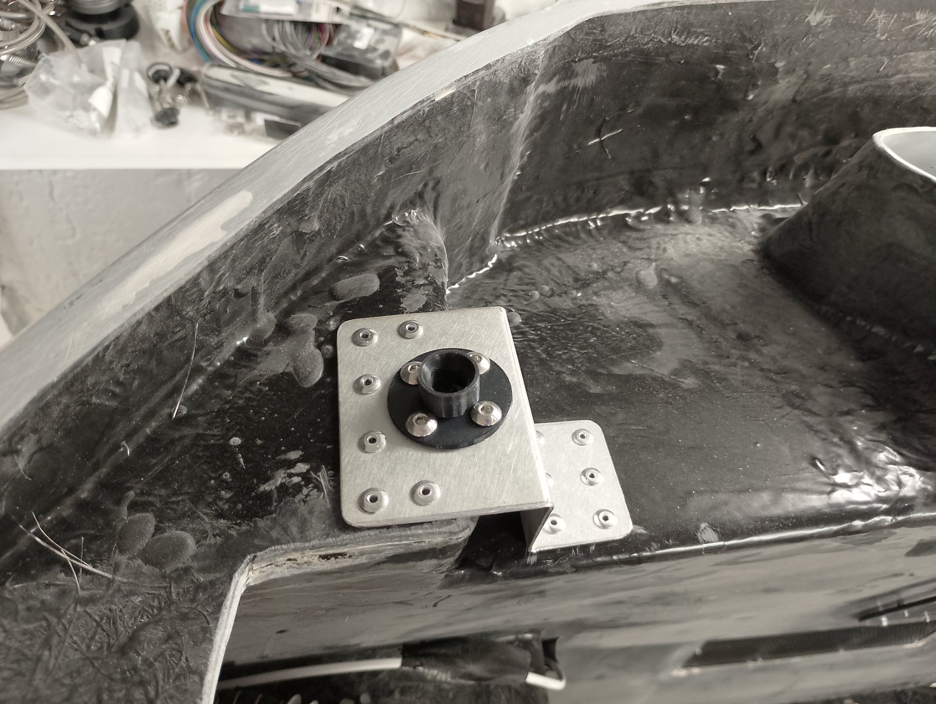

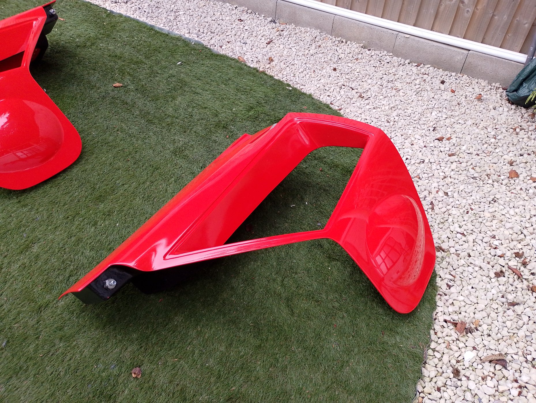

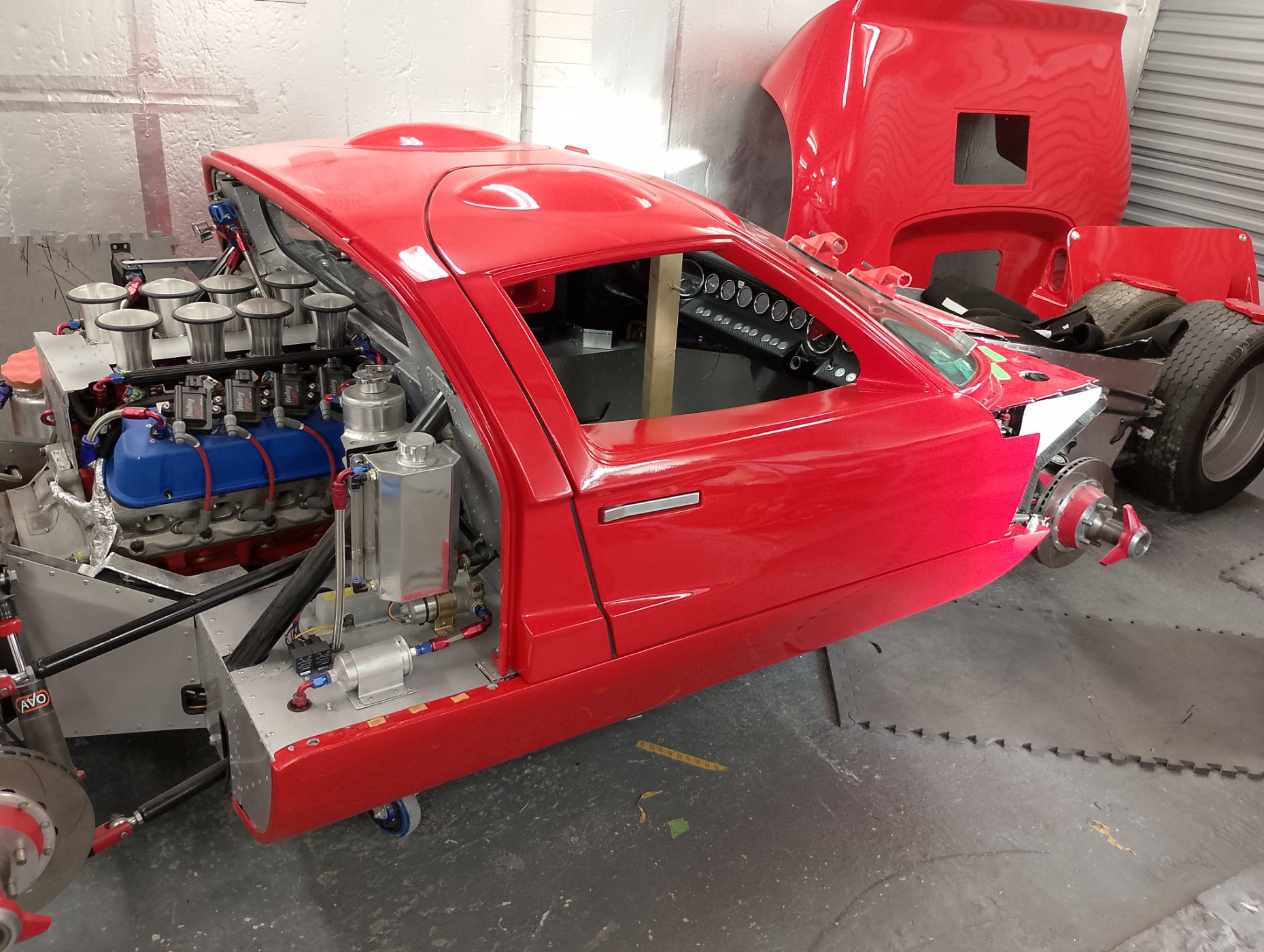

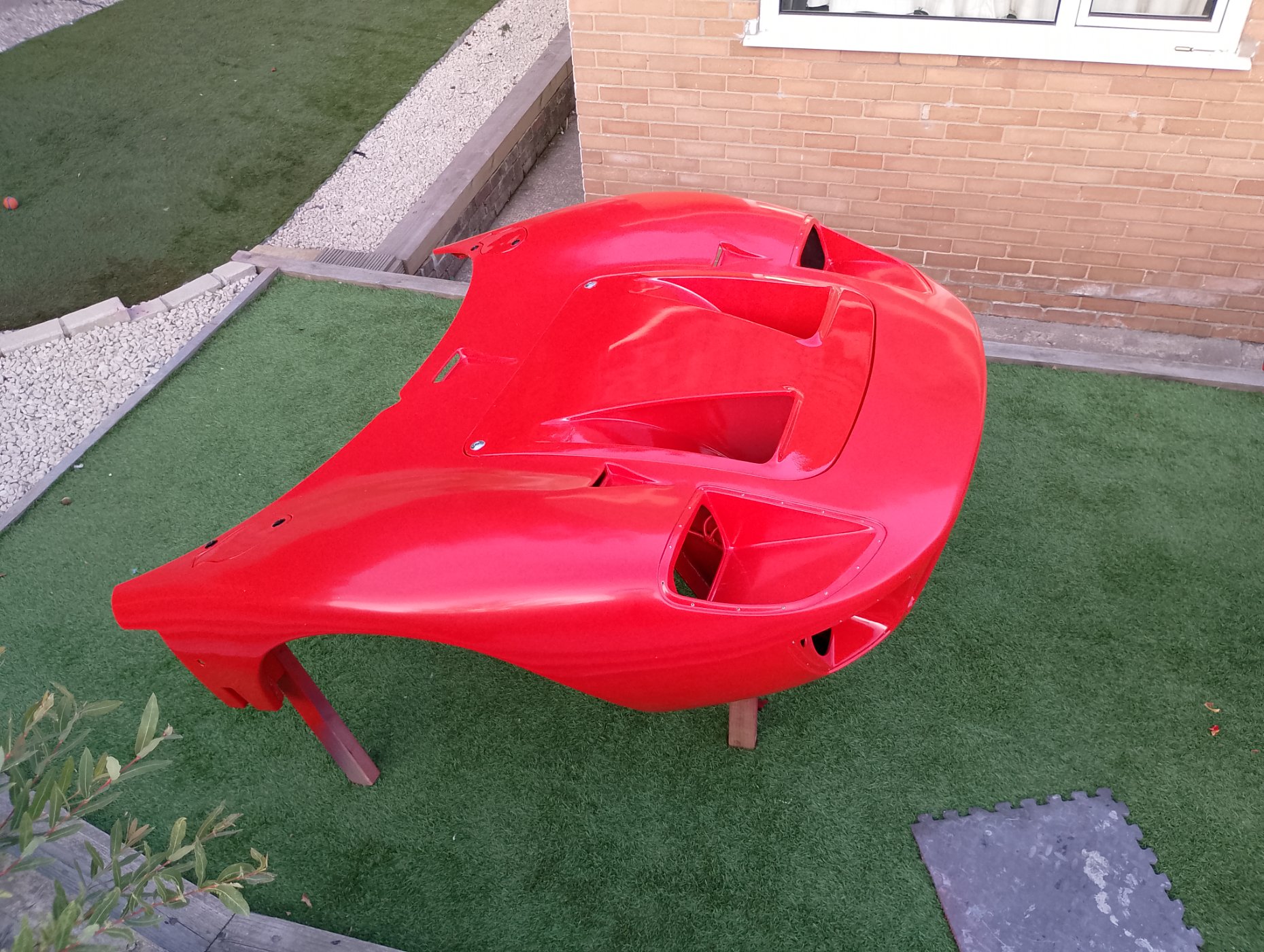

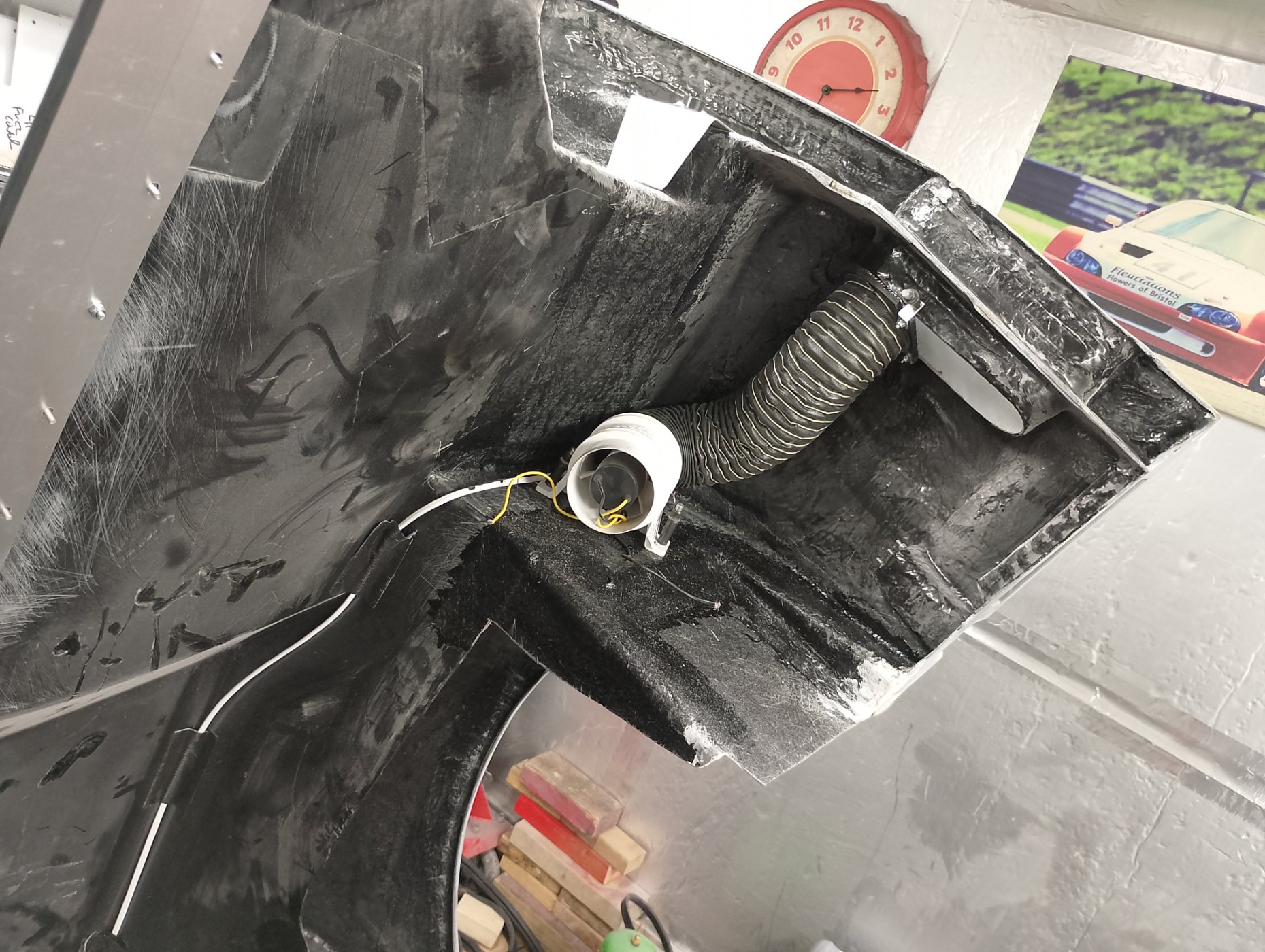

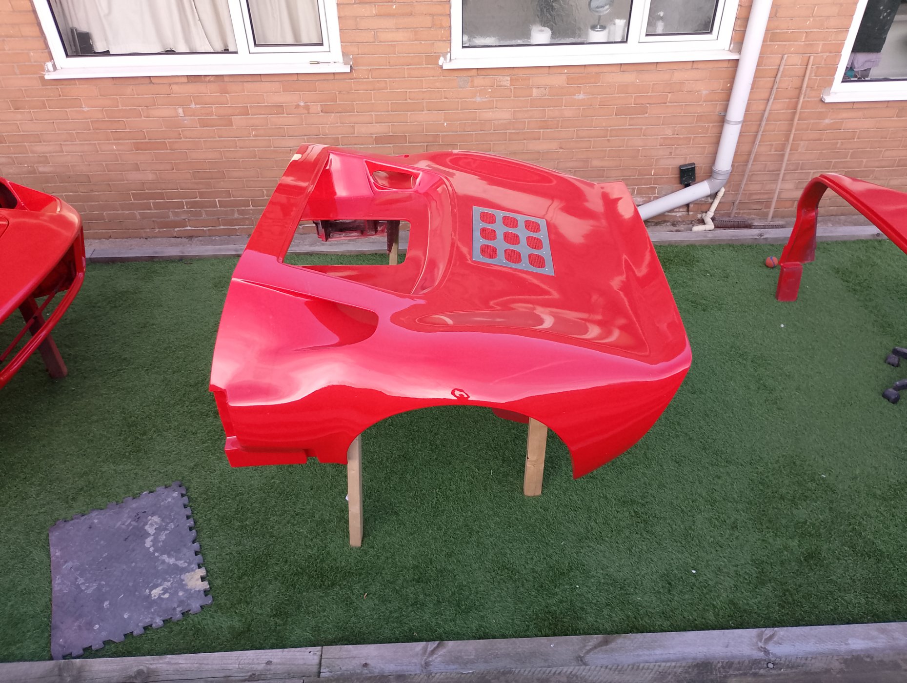

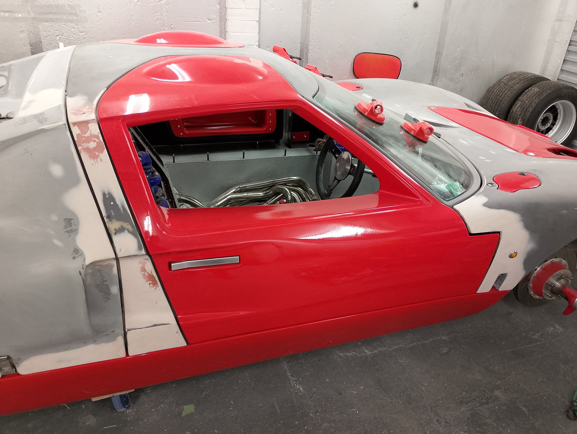

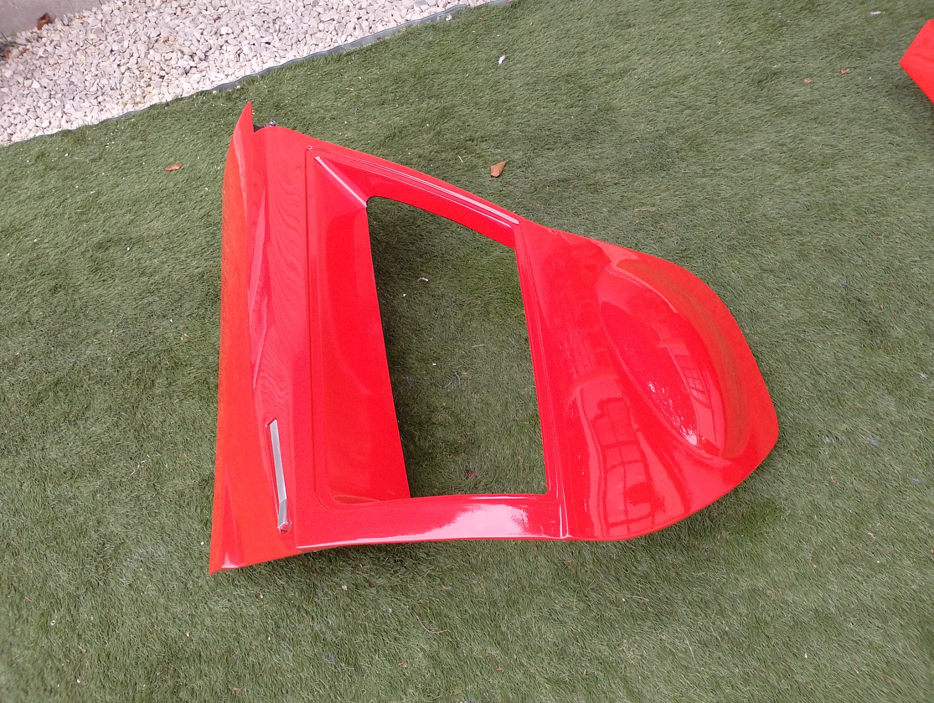

I have now sprayed the doors and trimmed them out together with the rad cover and fuel cap covers.

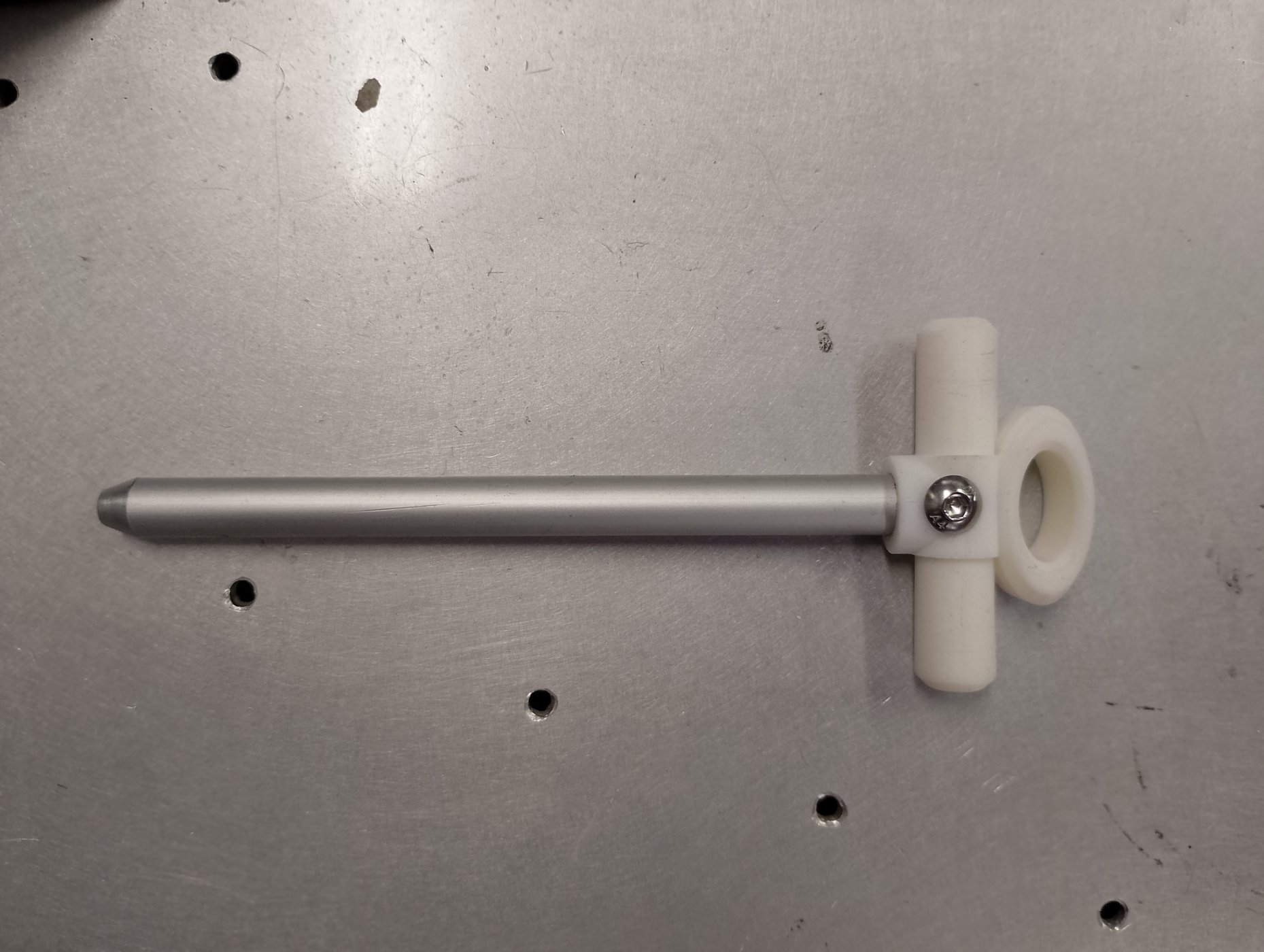

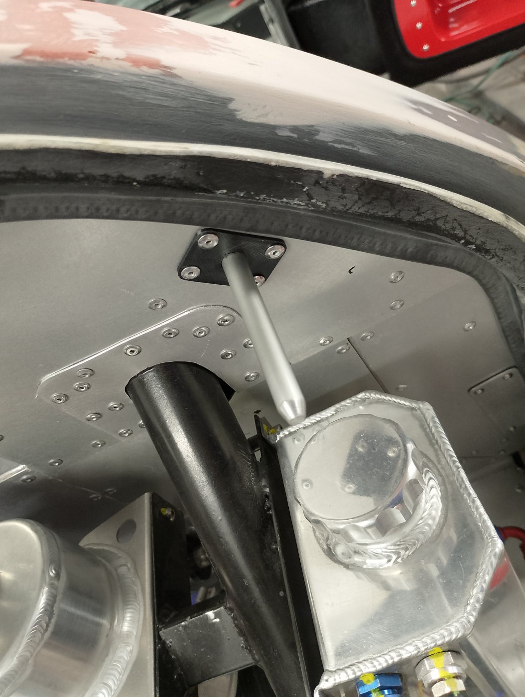

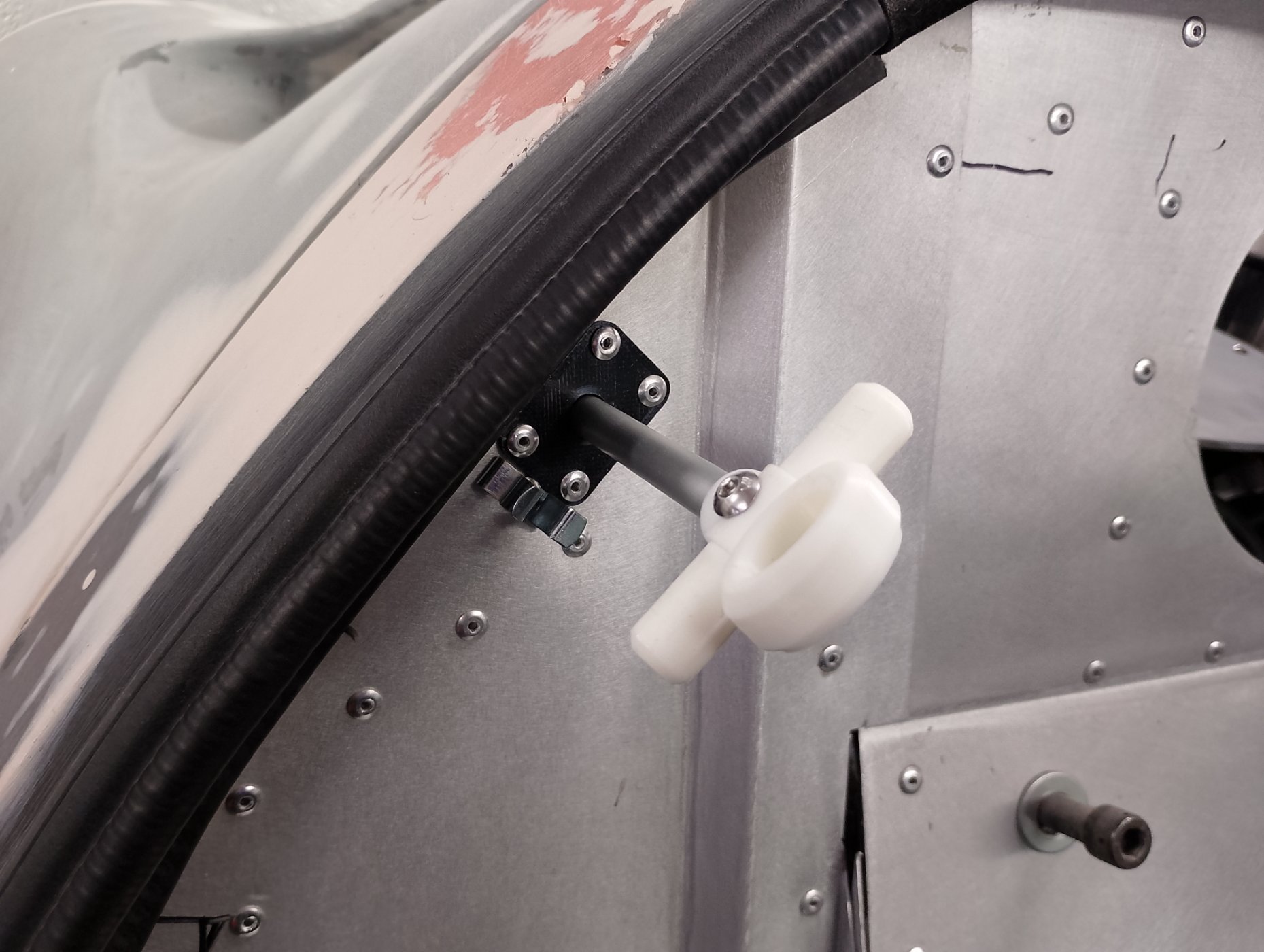

Also fabricated / 3 d printed up a couple of simple security locks for the rear clam.
Added some rubber protection to stop the rain coming in !
And a couple of fans to cool the headers..
pictures below :
Also made a youtube vid as usual.... see it here :

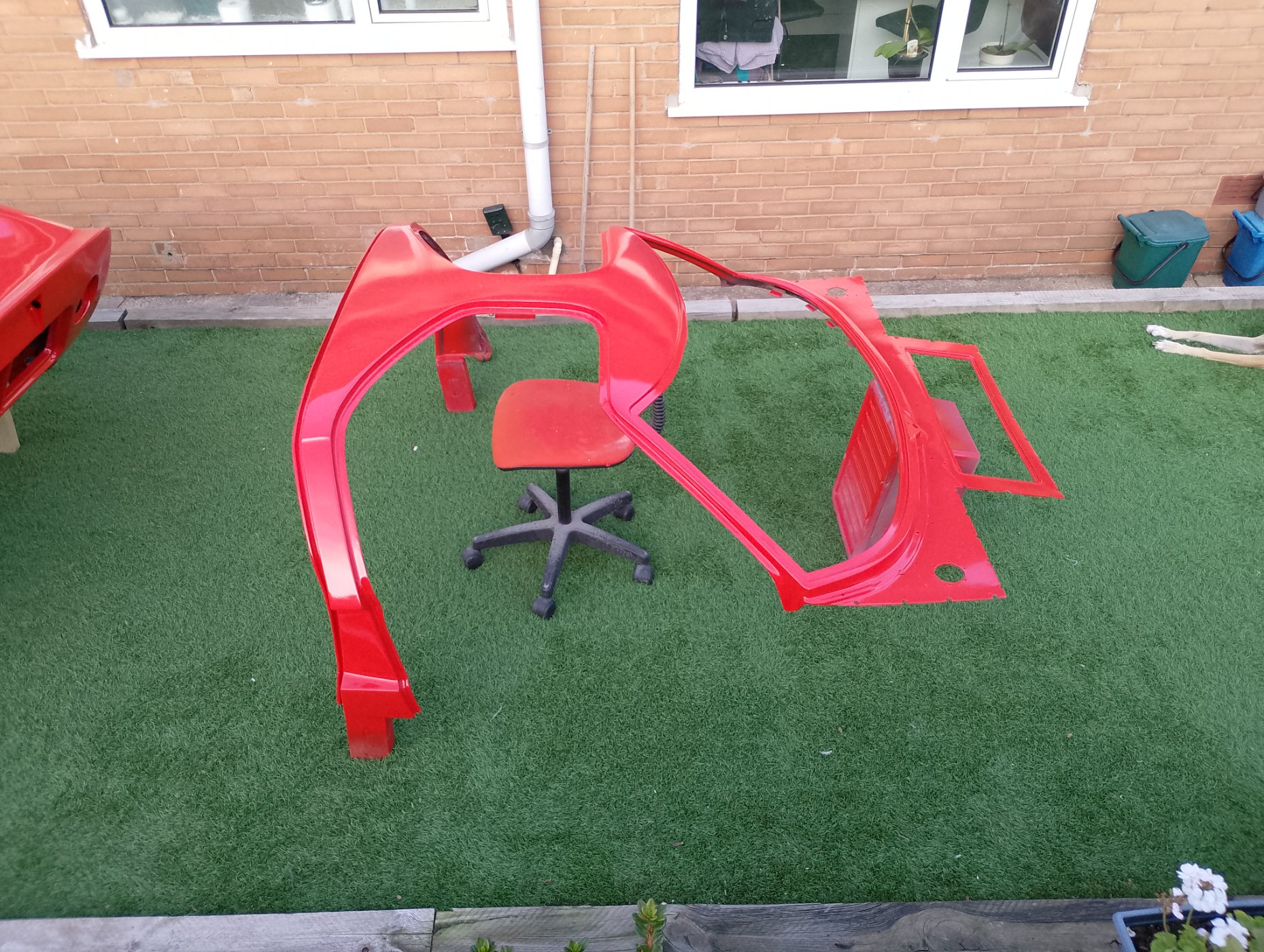

Weather been good here in UK SO .....

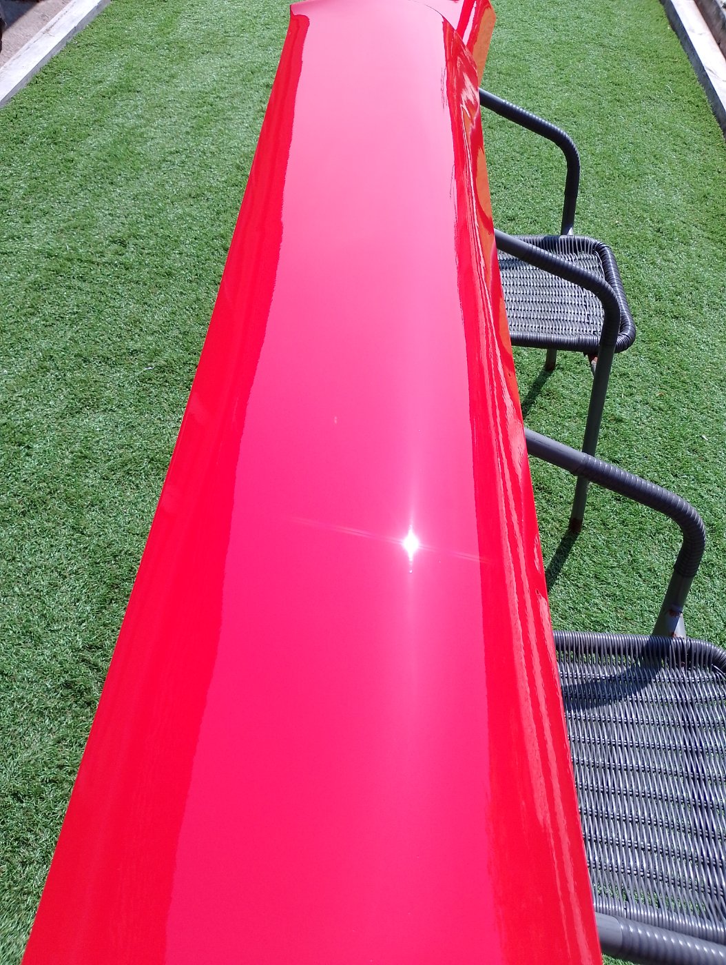

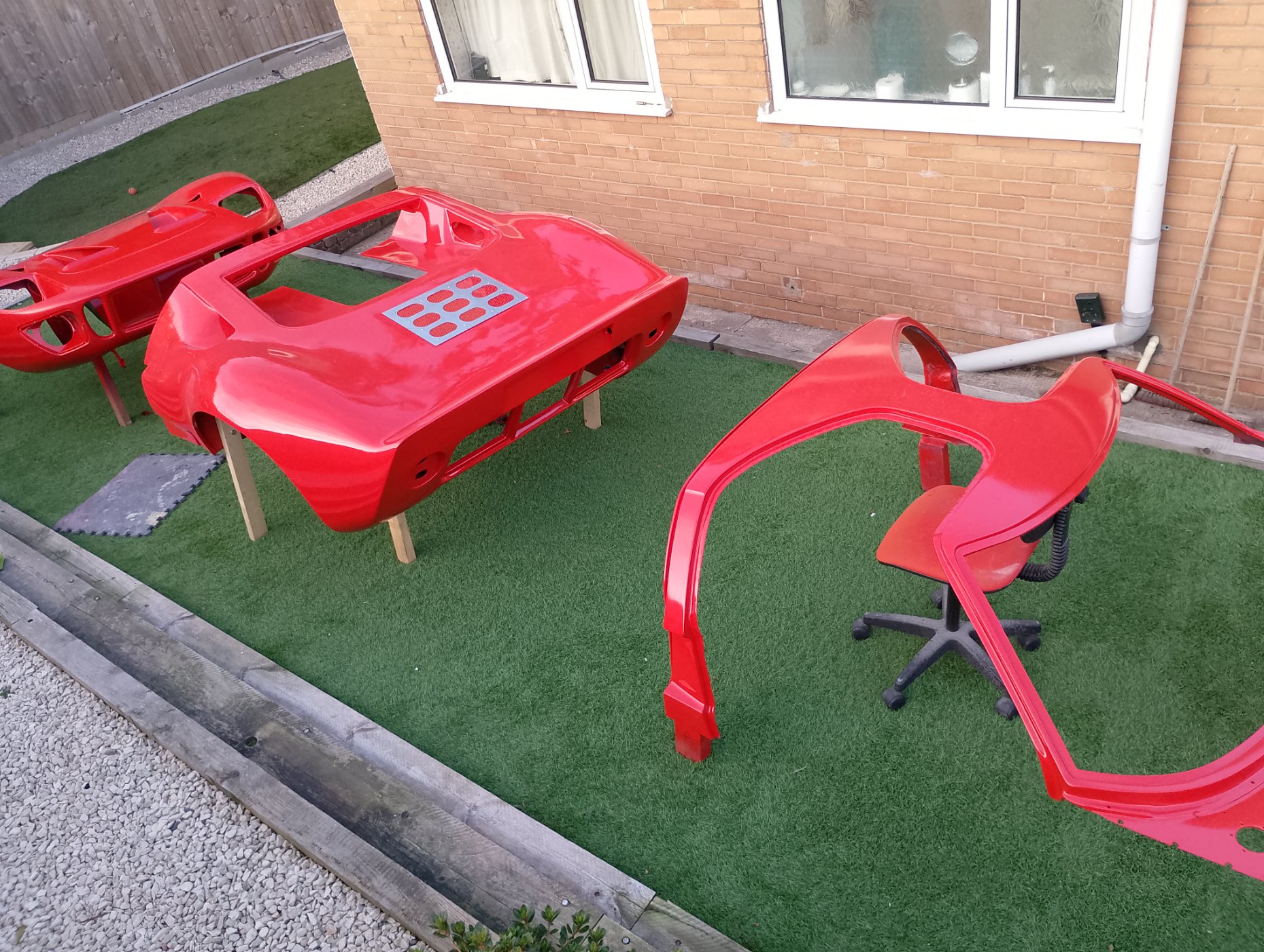

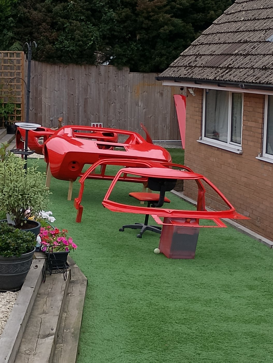

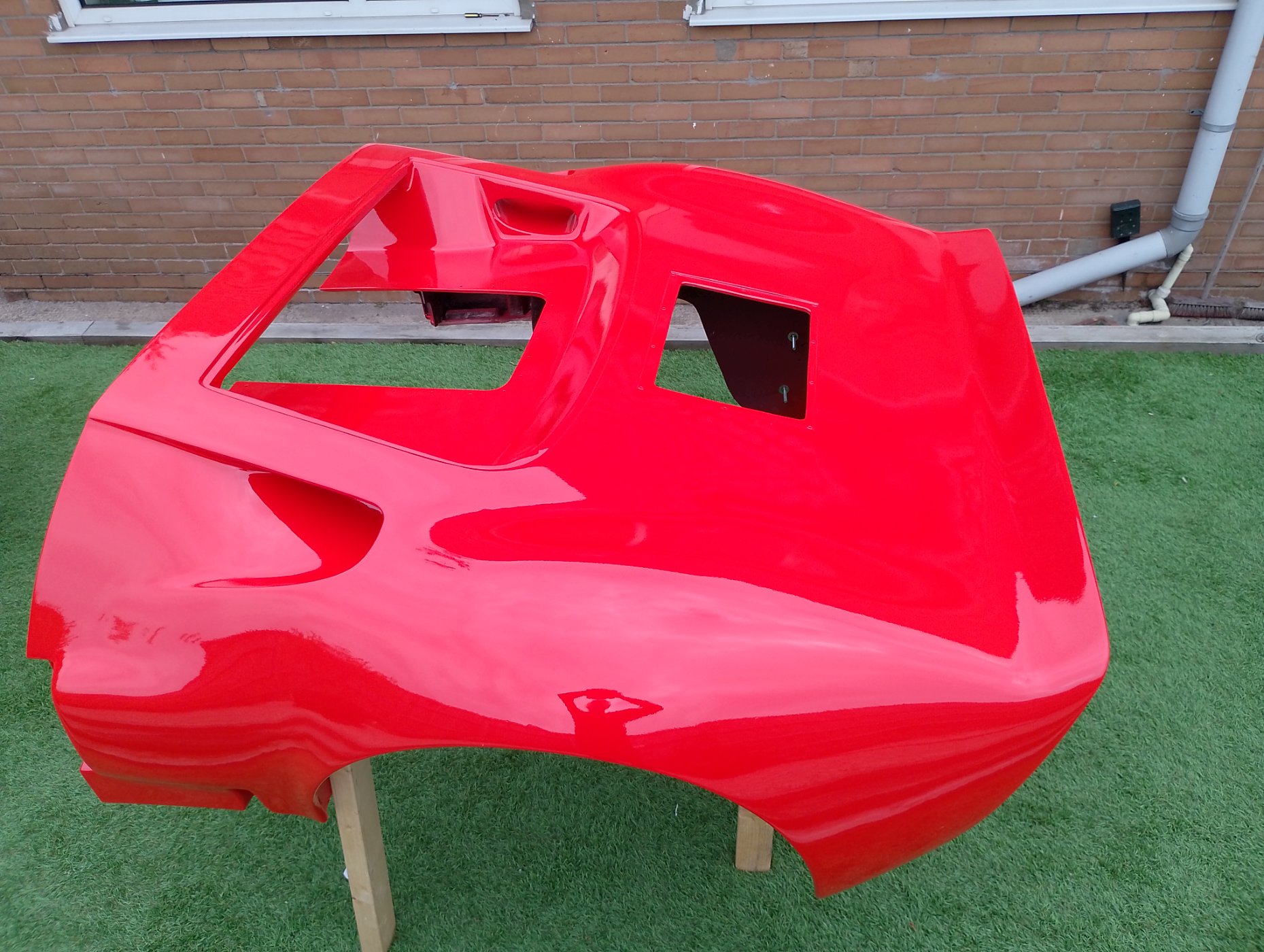

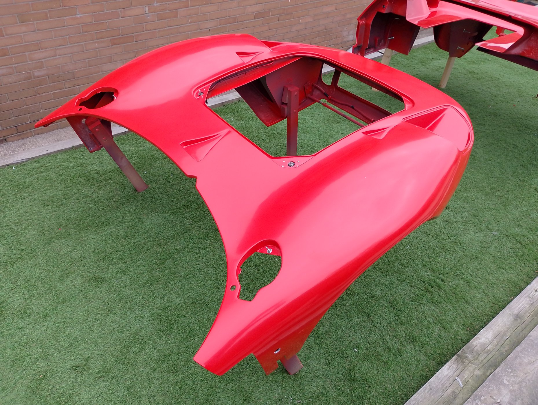

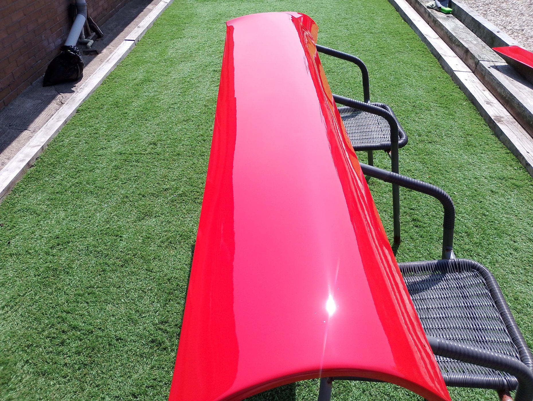

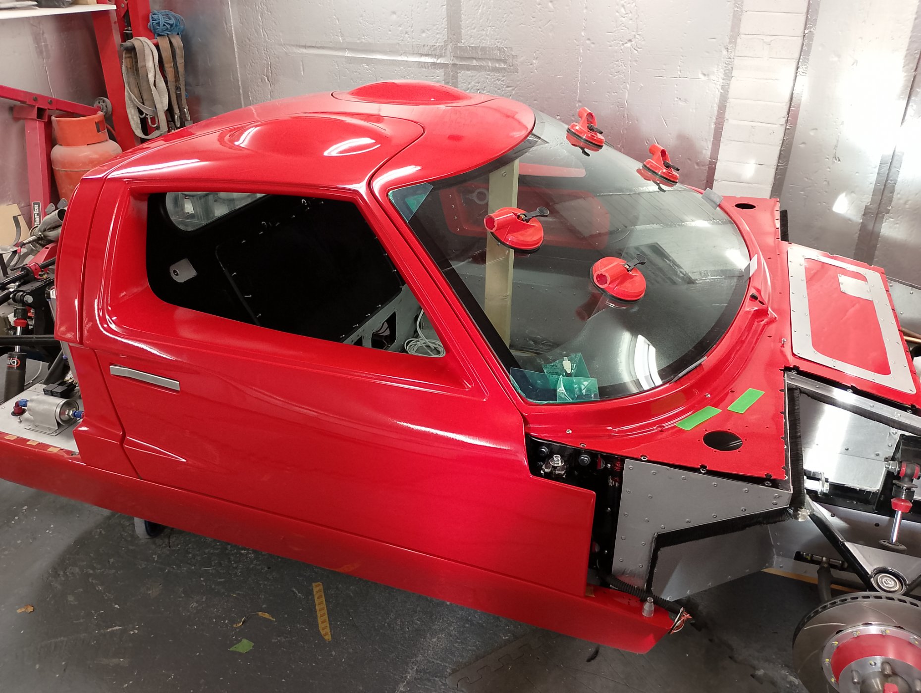

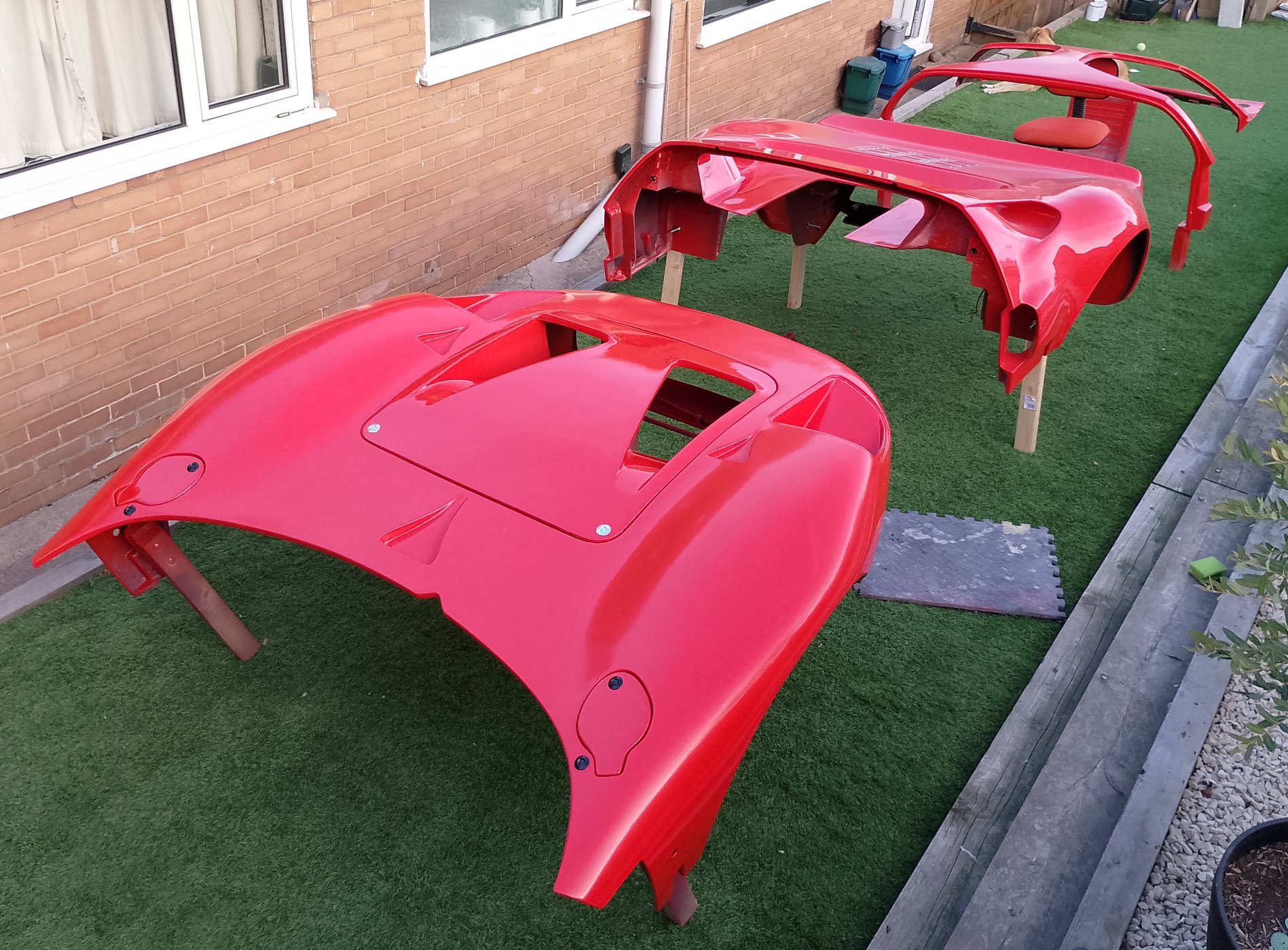

Lots more spraying now completed, IN FACT , no more to be painted ......
pictures attached...
not the best spray job in the world but good enough for me....
just need to let it harden off before doing a machine polish ...

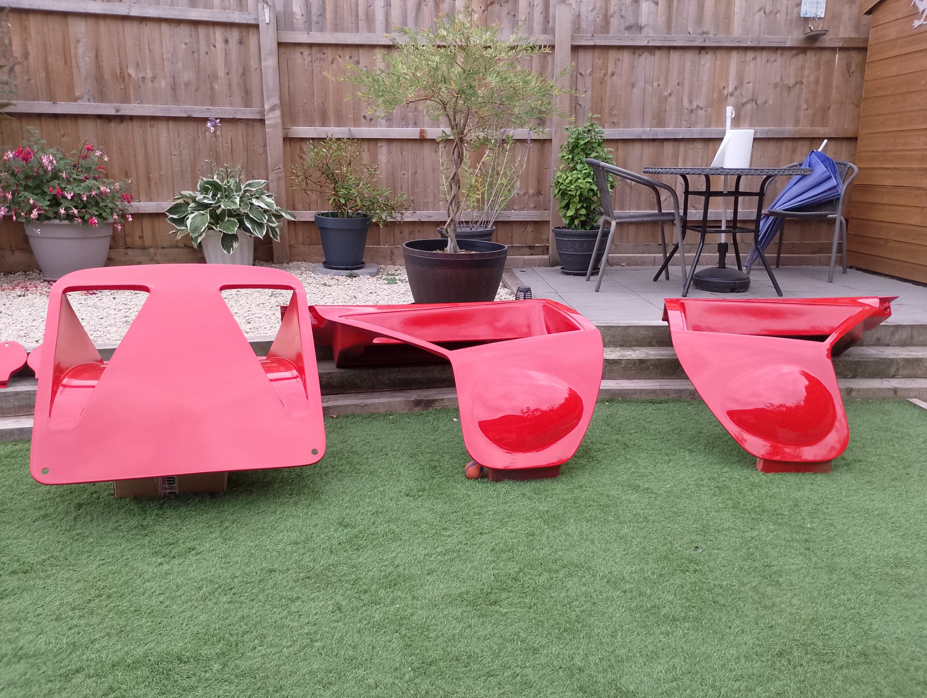

Great job on the paint.... but you might want ro reconsider the setup of your bodypanels!?
Sorry, I could not resist ;), keep up the good work.
well....it would certanily attract some comments ......lol.......yep...could have laid it out better......thats the order it came out the spray tent.....
