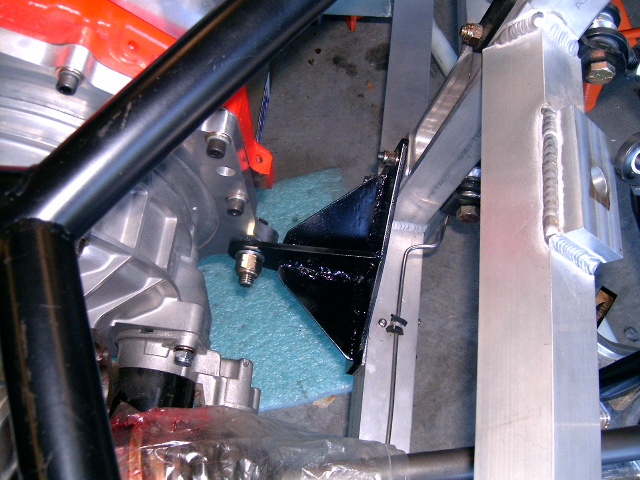

Howard Jones
This is what I'm talking about. One on each side. It also serves as a chassis triangulation piece at the opposite corner from the one at the upper rear that is welded into the chassis. This could be made from 6061 T6 as well as 4041 CM as I did. I may well do it over in aluminum to reduce the weight at some point. I won't bless extrusions used in fabrications that must be used in high strength applications because too many times the material is intended to be used as cosmetic pieces and have very little relative strength. But a correctly welded fabricated piece like mine made from either of the above materials should be fine and very strong.
I like to be careful recommending materials as I am not a structural/applied materials engineer. My background is in electrical engineering with a bit of self taught homemade racecar best guess work thrown in. Buyer beware.
Howard Jones
Ya the memory is the first thing to go. It might as well have been built for a Panzer. That was the first thing I made with my new welder about 10 years ago now I guess. No way I needs to be that heavy. If I made it again now I might even try to box it with much thinner material instead of the gusset system I used then.
