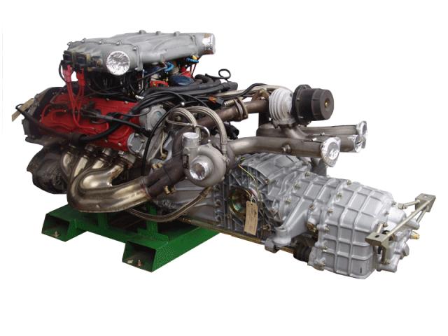

What about one of these, from a different kind of "40"...
