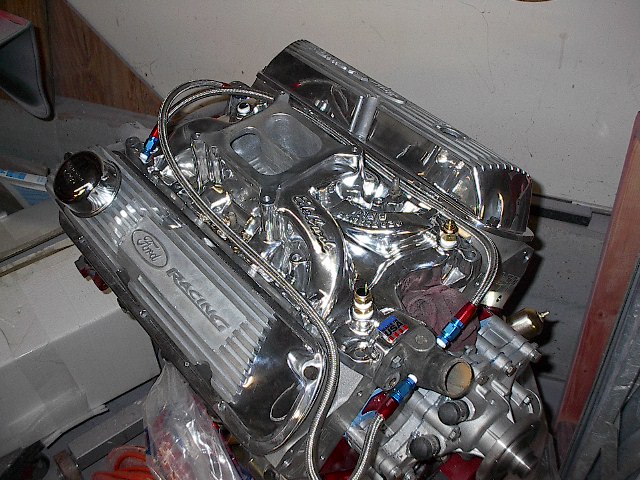

If your manifold is like mine you will need to drill two holes, one for each head. To do this you will need to pull the intake to make sure you it the coolant port in the head. This photo may help:
Dave Bilyk
Dave Bilyk
Thanks Jonathan, the manifold looks very similar, and I can see that the connections are angled to go through into the head port. Since there is one each side, I guess there is no passage in the manifold. I think that answers my question, and yes, I would have to be extremely confident on my ability to get into the head port before I would try without removing the manifold.
