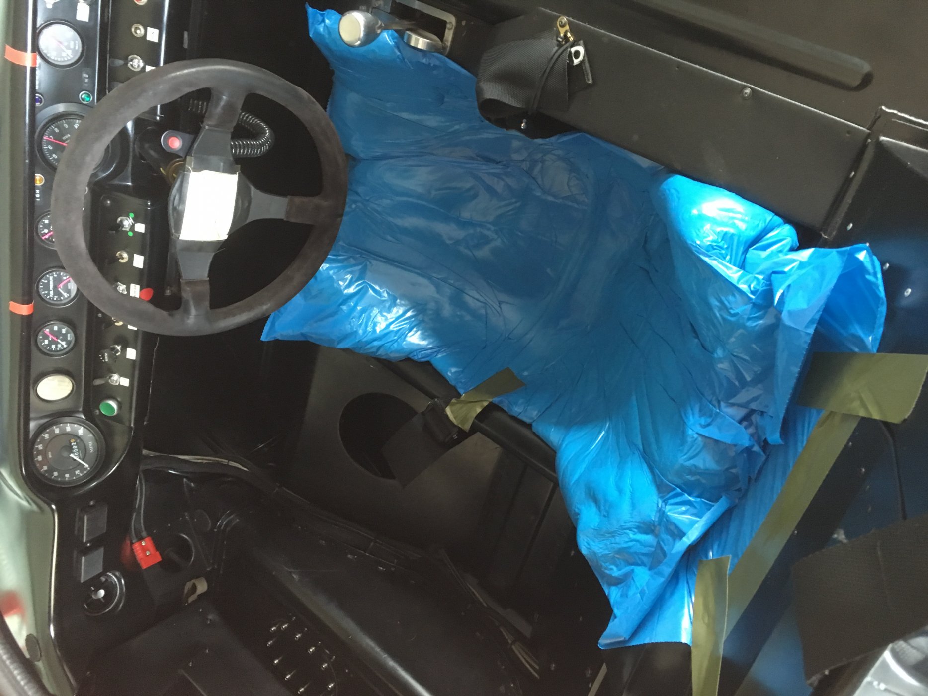

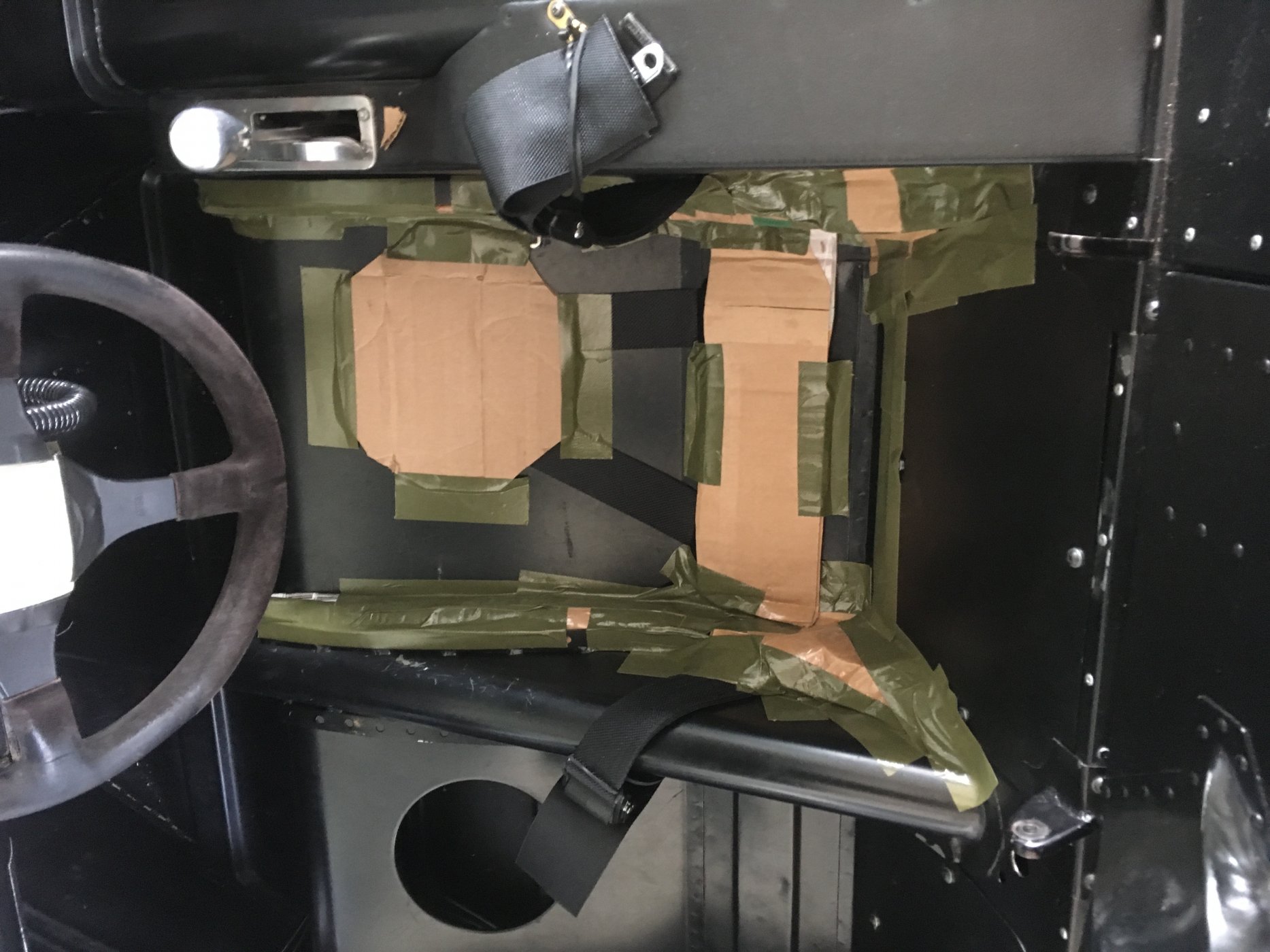

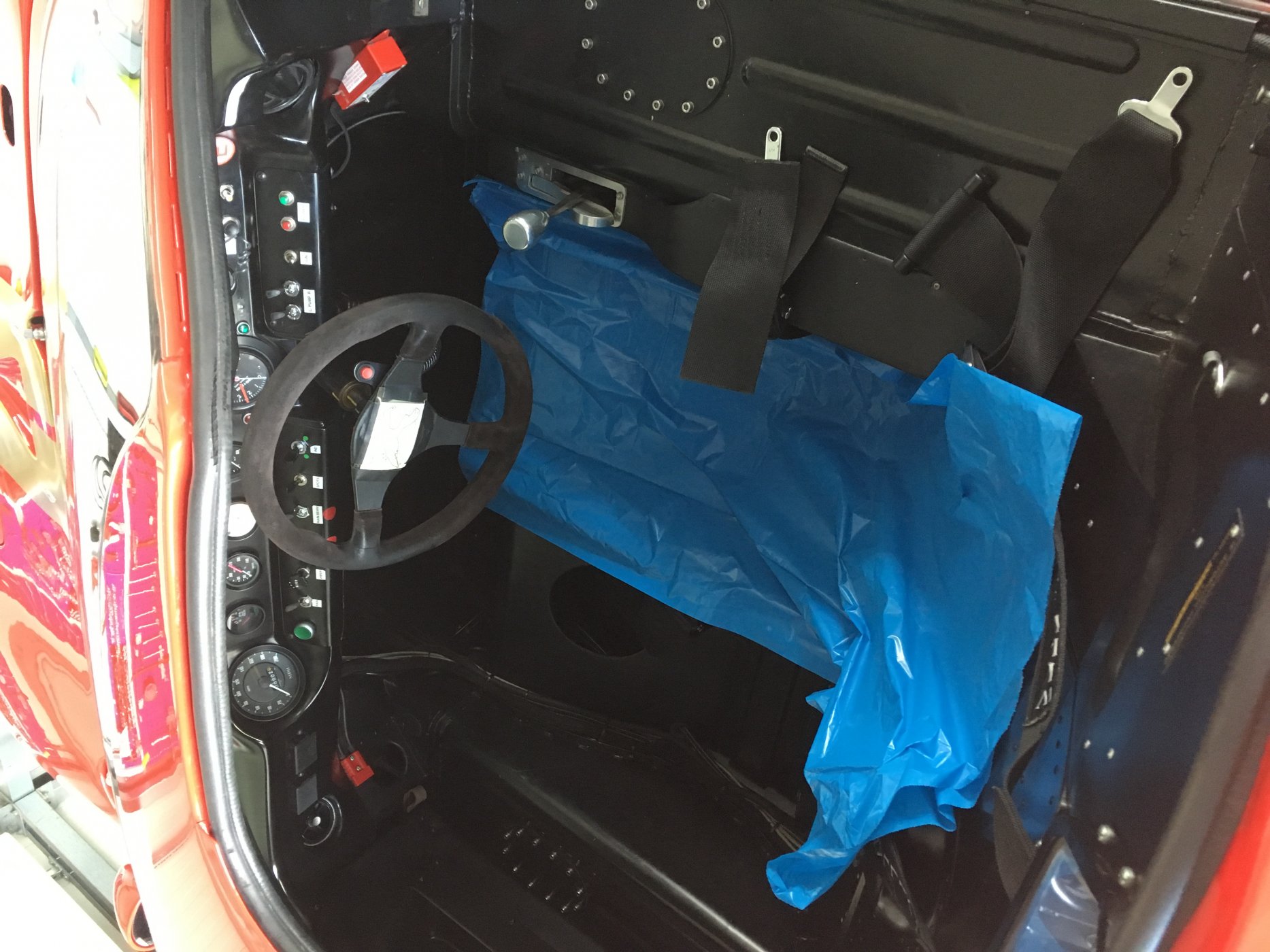

Since our GT40 will be almost exclusively driven on racetracks, I plan to mold the seats directly in the tub, using the old " sit on a big trash bag filled with solidifying polyurethane foam" method.
Would you have any recommendations as of which polyurethane to use ?
