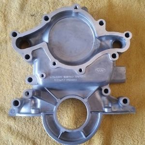

Cheers that is a point I missed....Never thought about the timing cover, will take a look

Timing cover reference:-
I'd be interested in the answer to the water pump question - there are some "shorty" pumps such as M-8501-E351S which might provide some much-needed extra room between the front of the engine and the SGT firewall.

Mick at SGT says its a 8841 R/H pump I need have asked Real Steel, the markings on my timing cover are AF-RF-E7PE-6059-AA which does come up when I Google albeit with the AF- normally ignored.
I'll update once I know more, thanks again

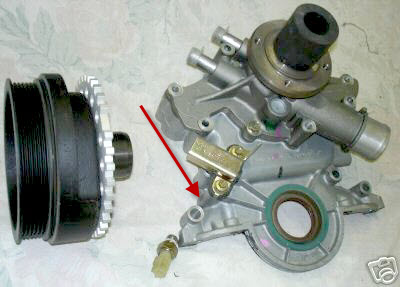

Realizing this is slightly off-topic to the OPs question about 1971 302 - There is one timing cover not shown in the handy chart above. That’s the late Mustang 5.0 cover that also saw use in the Ford Explorer and Mercury Mountaineer.
This is a very short cover/pump assembly that would work well in a GT, but you must use the special harmonic balancer with integral serpentine pulley..
((Pay no attention to red arrow, that was to illustrate something else))
