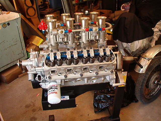

I have dealt with Pierce manifolds and have been very happy with them. I bought my webers from some one other than them and they helped me grt them right. I have a split duration cam and have no problems. Throtle response is awesome!

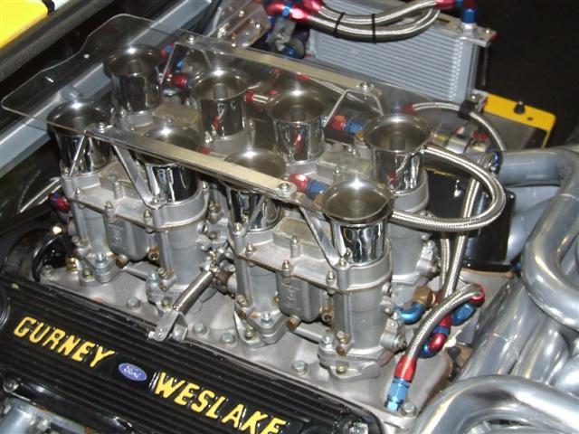

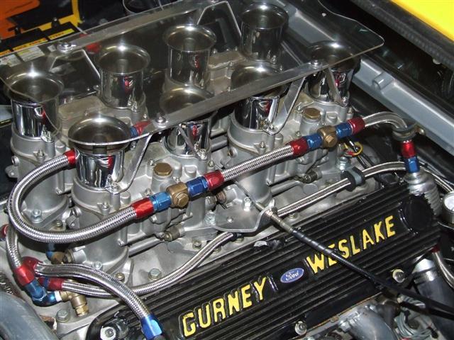

Split duration, no problem.
Isky cam 284/294 duration 544/573 lift 110 lobe center
I have about 1" of clearance at the rear stacks.
BTW they are 48IDAs.
Couldn't resist :)
