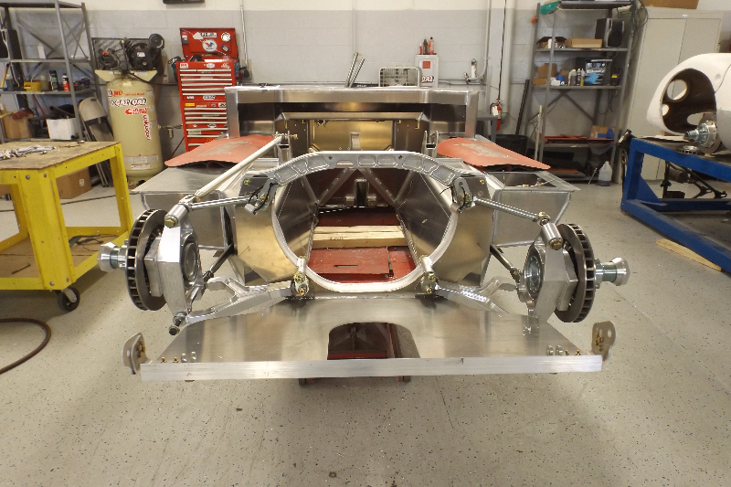

Look! It's finally a thing, not just an open PO. Look at it's naked goodness all billety and stuff!!!!!

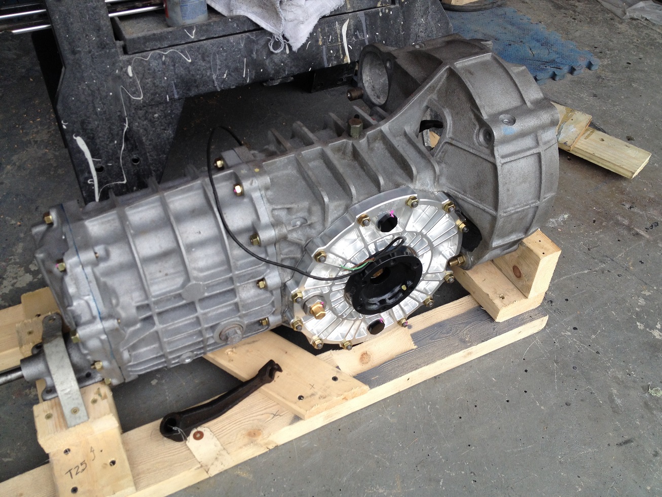

Got my 930 gearbox back from Steinel Autowerks in Twinsburg, Ohio. Wavetrac LSD, CMS side cover, and gears gone through. Great people to work with. Great communication which seems lost today.

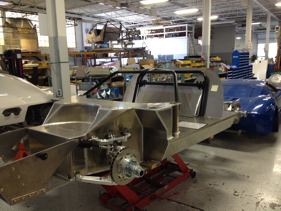

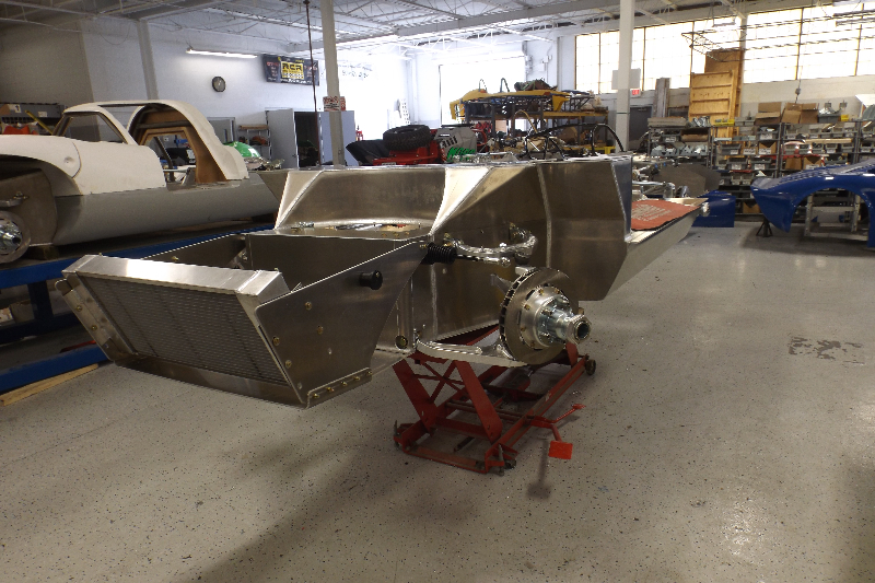

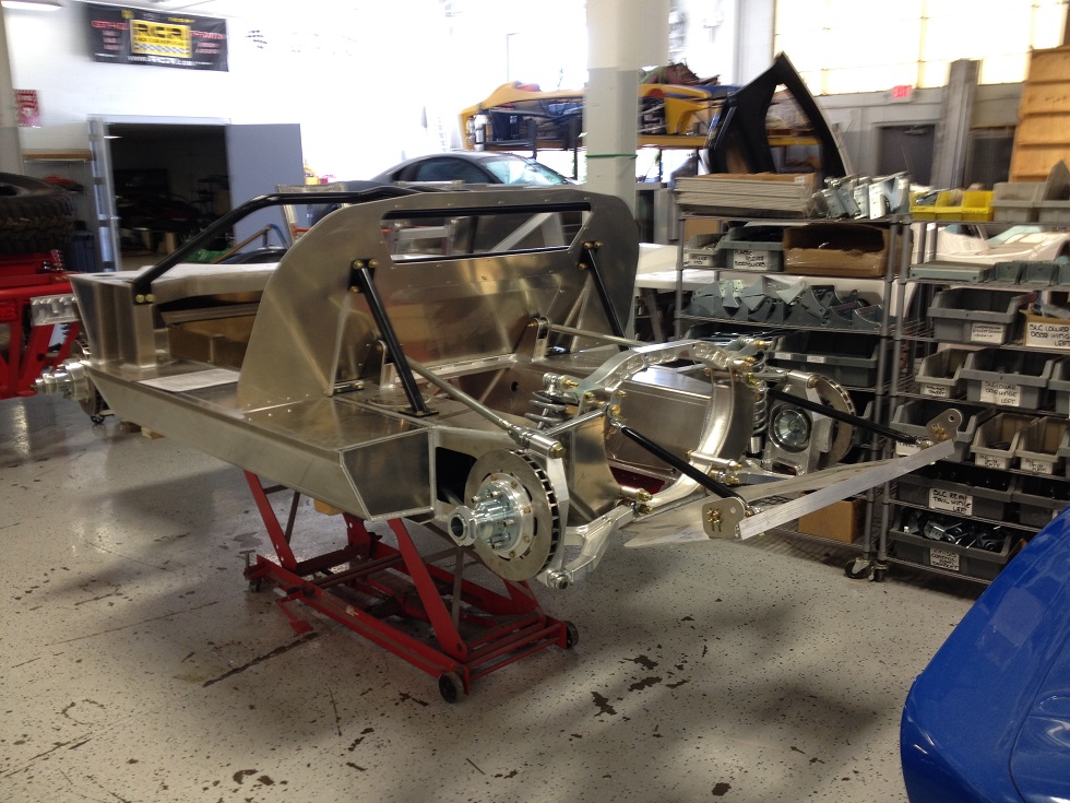

Stopped up to RCR to check on the car a couple weeks ago. Things are moving along. Can't wait to see the wide body and wheels installed.
Fran has got a pile of cars in various phases of build. Apparently he also bought a decommissioned fighter jet.

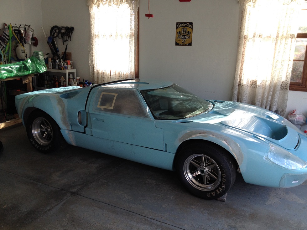

It's home. Missing a few parts but RCR is on top of it. It's funny though. I've spent the last year and half researching everyone's builds. I get this thing I my garage any now I've got more questions and a splash of doubt, not that I can complete it, but exactly what I want to complete. The wheels are loaners as there was an issue in widening them but you get the idea.
Congratulations Adam!
Interesting to see that front flares are added now! Hmmmm.... What size wheels and tires will you be running?
My wheels, (car delivered July ~3) are still missing as a result of them widening on the wrong side as well. Fran has always delivered on backordered parts, and I think he is working to make things even better.
Is your car a +2 or +4? Mine is +4 and I do not have front flares like you do? Was that extra?
