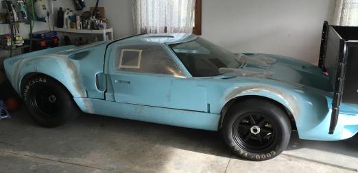

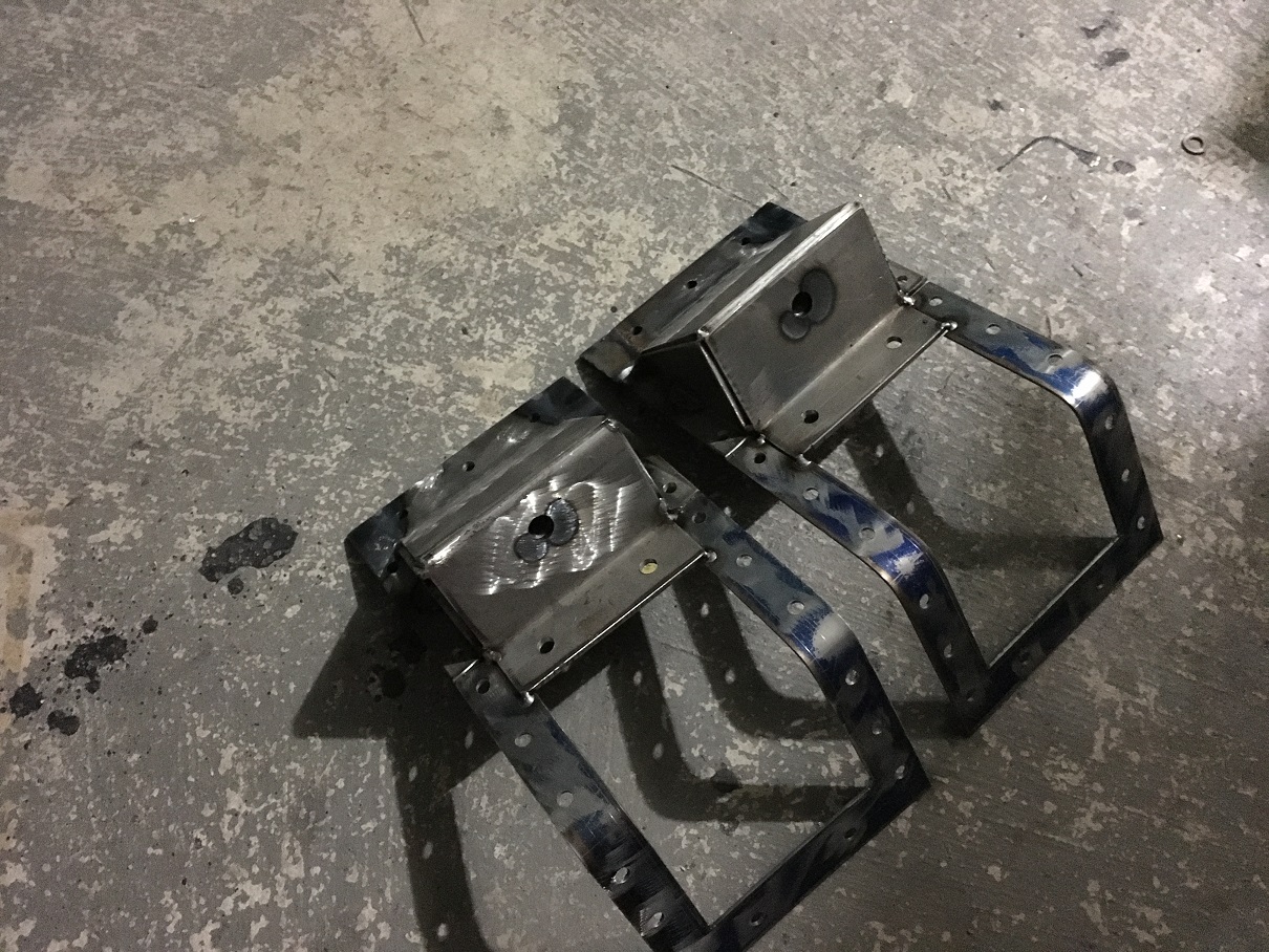

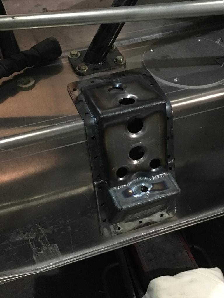

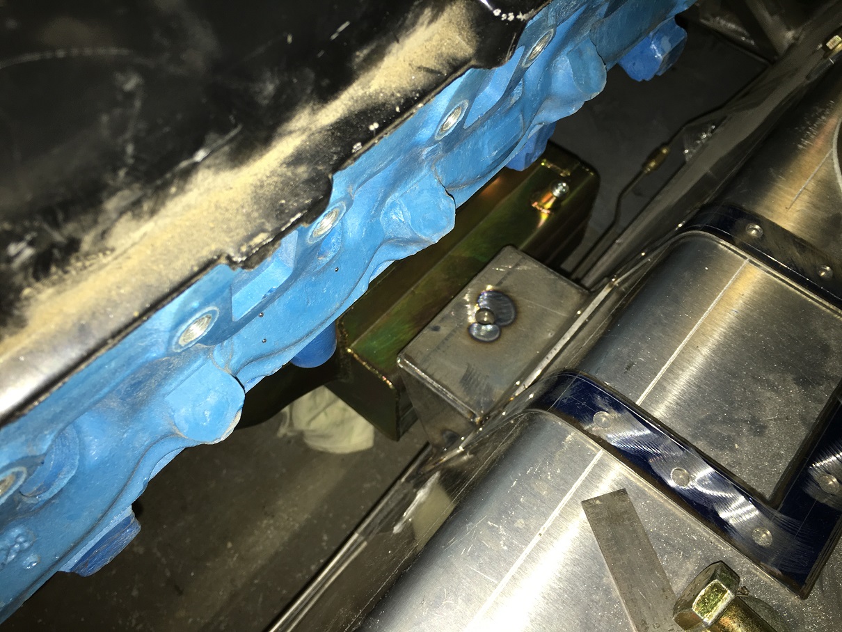

Some progress.
Installed foam mock up engine and started creating engine mounts that are more reminiscent of the original. They are also more self-locating making them easier to hard mount once I pull the engine. I'll TIG weld them to finish off then move onto the mounts that actually bolt to the engine.

Adam

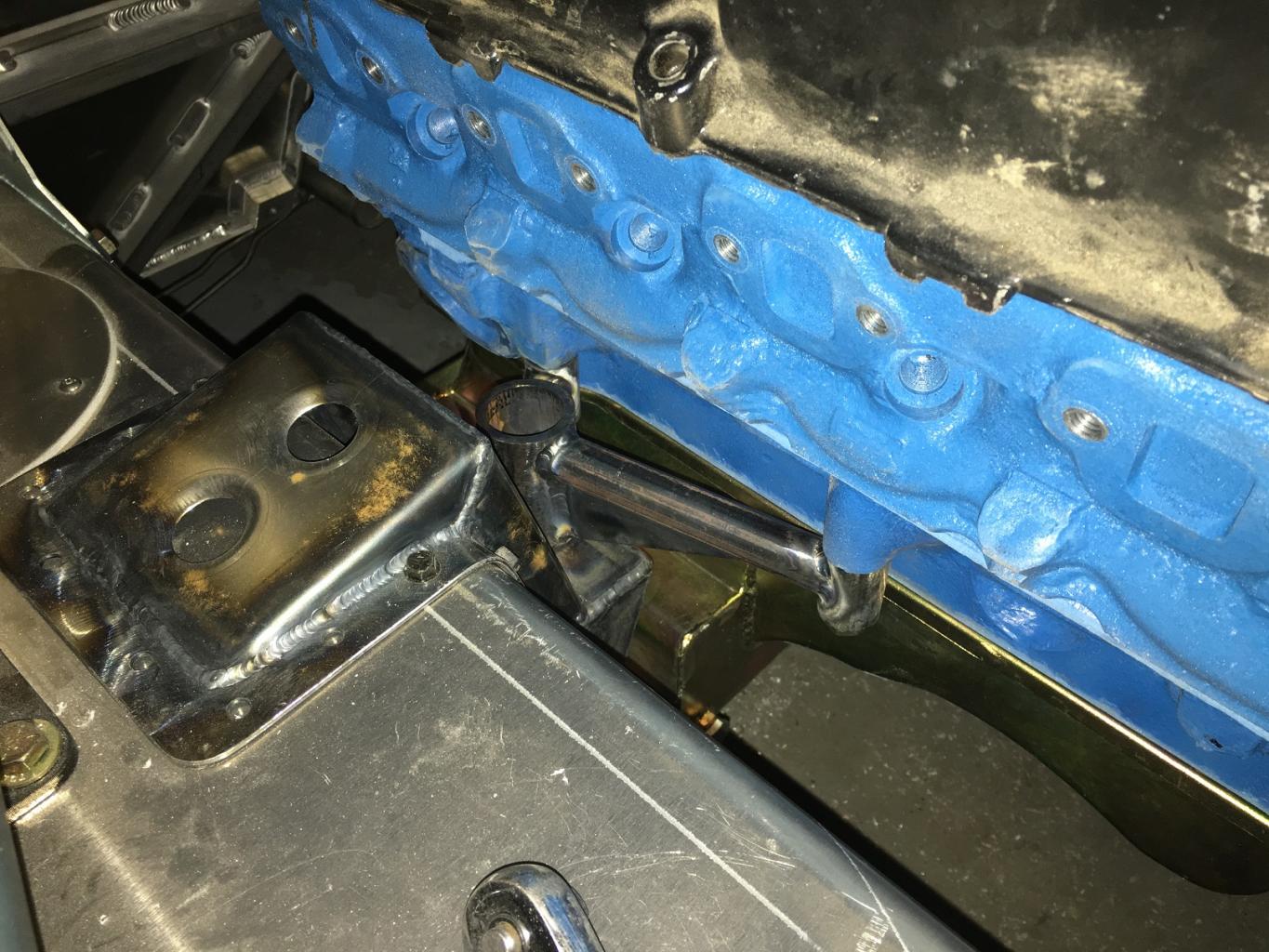

Got the engine mounts done and temporarily mounted in preparation for the fabrication of the part that connects directly to the engine. What I love about the RCR chassis is the simplicity and all the beautiful machined parts. Aesthetically though, I wanted to dress up some of the areas to bring an original feel back.
Another thing I wanted to address adding a little stiffness to the adapter plate. Some people have added support brackets that attached the bolt ears to the engine mount. I'm taking a different approach. Stay tuned.

Adam
So I wanted to anchor the adapter plate in a way that better tied the engine to the chassis and held the position for me to construct the motor mounts. The whole system is going to be solid mounted so we'll see how that works out. I don't mind the vibration as long as there are no mount area fatigue issues.

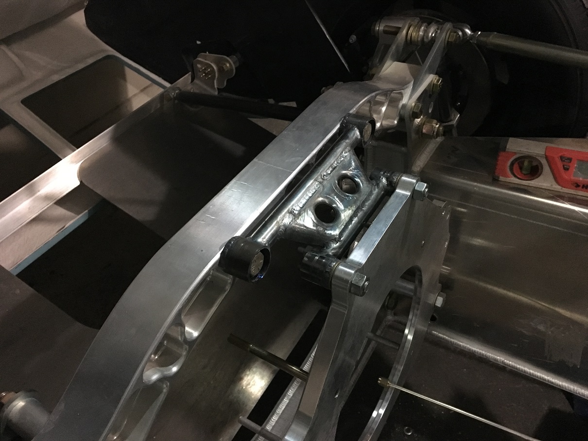

Adam
Got the solid mounts all finished up. Wanted them to be inspired by the original mounting systems but be a little beefier for "everyday" use.

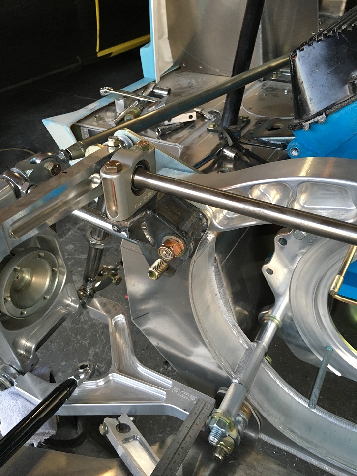

Moved onto mounts for the rear sway bar. I wanted them to perform 2 functions. To obviously position the bar mounts but also tie the rear upper control arm mount to other things (eliminate the single shear on the 5/8" bolt). I'm going to use the 1/2" bolt that mounts the cross support to attach rear subframe down-tube...kinda like how the original cars connect their tubular subframe.

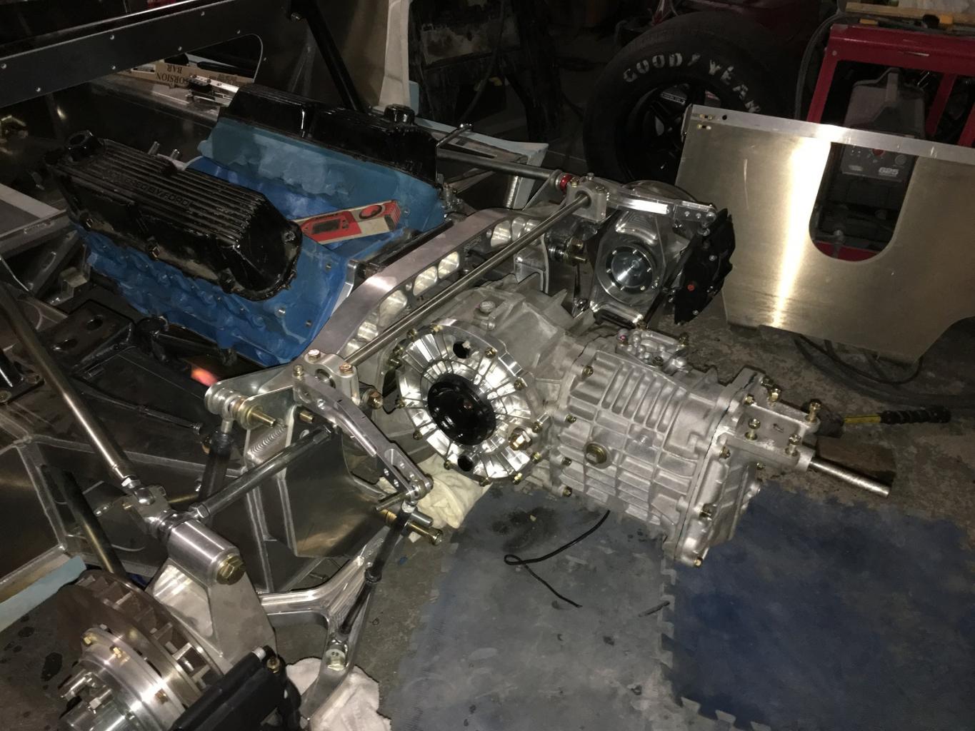

Adam
Finished mocking the sway bar assembly. I wanted to check that it all cleared the transmission. I do love the look of the 930 box. It has the vintage race look without actually buying a Hewland LG.
I'm using a 7/8" end X 28" long bar. It seems to package nicely and are available readily with the circle track crowd. I wanted to have more "off the shelf" options to help with build cost and long term attainability of parts.
D. Nye
Nicely done Adam, very similar to my solution. I'm with you on "off the shelf" parts, it makes it easier to change bar rates if needed in the future.
