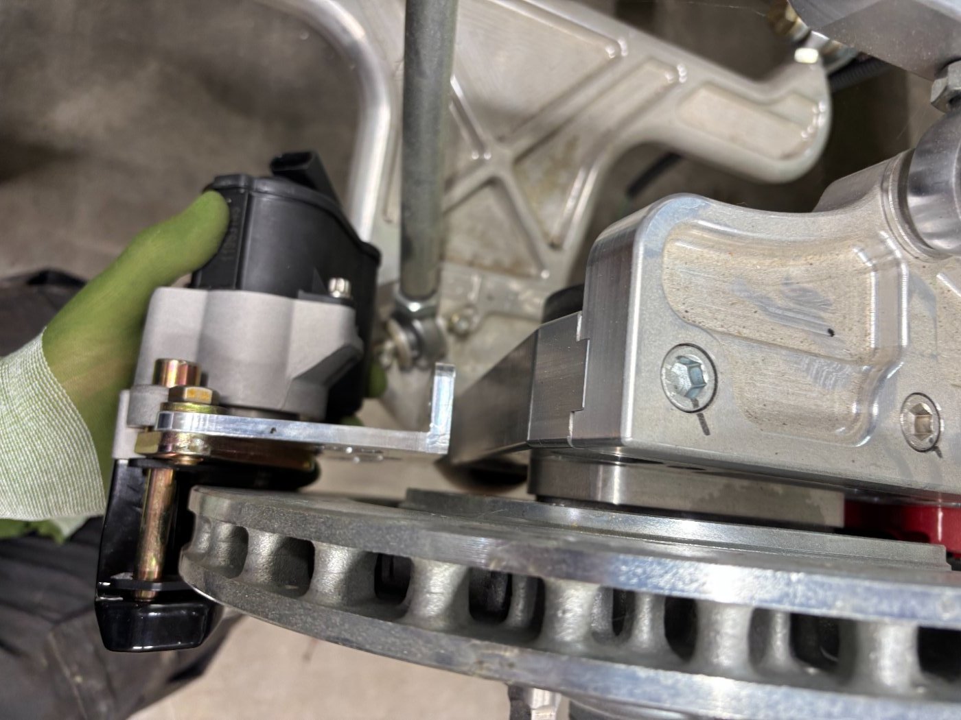

I received my calipers last year and just received the mounting brackets.
I understood that holes need to be drilled and threaded in the knuckles but i can't figure out how. it looks like dimension are not of, or they need a spacer maybe?
Anybody completed this installation yet?

That bracket looks like it would work on an RCR40. Might be you received the wrong ones first your car.
I just communicated with Bill and apparently when the Brembo calipers went to the internal crossover it changed the the knuckle design. Mine do not have the crossover in the rear so I have the newer knuckle and according to Bill the current bracket will fit on mine.

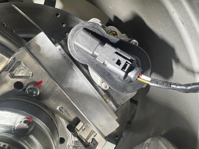

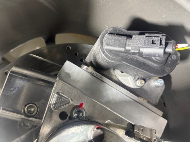

I'm working on a RCR Superlite GTR. I needed a spacer. See picture.

FWIW I just checked mine too, they arrived about a week ago. They also do not fit, short by about 1/4". My brakes are the Brembo with the external crossover.
Just got mine in the mail, I'm having a similar issue. I have the external crossover Brembo calipers and the brackets are about 3/4" too short no matter how they're positioned.
