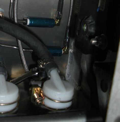

On the residual valves, one end is 1/8-27npt, any idea what the other end is? It's the one with the black nut.
This would be so much easier if they listed the sizes of the inlets/outlets on their website, haha!
If your brake setup is simlar to mine, that residual pressure valve will thread right into an elbow in the kit which threads into your in-line tubing flex line. I had a post in my build log: I got all the flex lines from fran and my residual pressure valves for the brakes. I copied what has been doen with the valves on the other SLC's but the MC arrow pointing toward the calipers, not the master cylinders. The fitting wouldn't work the opposite way, so i followed the other builds. To me it seemed backwards. You put them in becuase the masters are lower than the calipers so i'd think they are directional. Does it look like these are wrong to anyone?
i got a reply that was answered by someone in Australia who said they took apart the valve and pulled out the spring that operated the valve. he said it gave the brake pedal a spongy feel.
I hooked them up "as is". Maybe "MC" doesn't stand for Master Cylinder? I don't have brake fluid in the system yet to see if it's right. Lemme know what you find out....
Pretty sure MC does stand for master cylinder, can't think what else it could be.........
Although the black nut in your picture is the one giving me "trouble" - I'm trying to identify it because I don't know if I should use teflon tape on it or not.
It's some type of flared fitting for sure, so I don't think you teflon it - the other end obviously yes because it's 1-8/27 npt, but this one, don't think so but wanted to check.....
Okay, double checked with them and the outlet on the residual valves do NOT use any type of teflon tape/paste/sealent/etc......, just the inlet is NPT.
Cool Alex! remember, the arrow on the residual valves point AWAY from the Master cyl's, in the direction of fluid flow.
