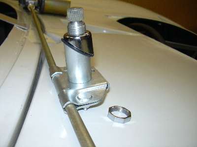

I have just bought a lucas motor and all the bits that come with it.
It seems that where the spindle of the wheelbox pokes through the bodywork is designed for a level surface. It has a 45 degree angled spacer so the wiper spindle is parallel with the screen. The spider mount where the wiper pokes through on my 40 seems to be already parallel with the screen so I would presume you just have a normal collar with 90 degree ends. What do you guys do here - have a new spacer made up ?

Paul
I had a similar problem...a little time on the lathe and a few minutes on the buffer wheel produced a fine looking spacer out of stainless. I think even a small lathe could make this part easily. I used a plastic washer between the body and spacer and all looks good.
Good luck
Phil

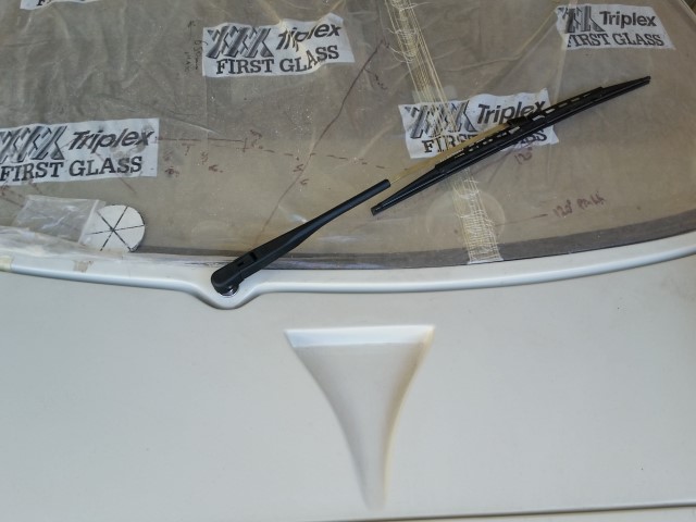

Pat, I purchased an eBay Marine 2 Speed Wiper with a 120 degree sweep.
Has Park feature for left or Right hand drive as well.
Easy istallation, just the motor with spindle.
Seems to be OK, sorry my car is not on the road yet so I can't comment on how effective it will be.
