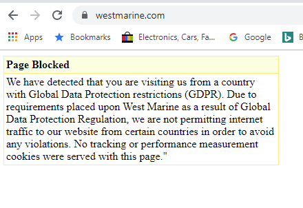

Hi
This is what I get when trying to visit their website:-
I'm in UK, so I guess they are a US-only supplier.

Ill check it out for you. I know they must have a web site. I go in one of their chain stores from time to time .That's whereI saw them.I spoke to Mac Mclendon and he uses the 2 speed model in the cars he builds.( Mclendon International Lola)
The address on their site is WestMarine.com Try it just like that. They have at least 20 different motors on there. I used fuse boxes,fuel filters through hull fittings for fuel tank vents and lots of other stuff from them on my Lola.
