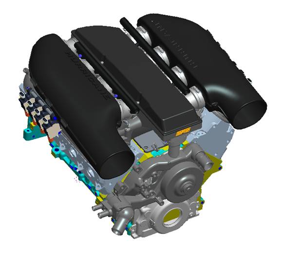

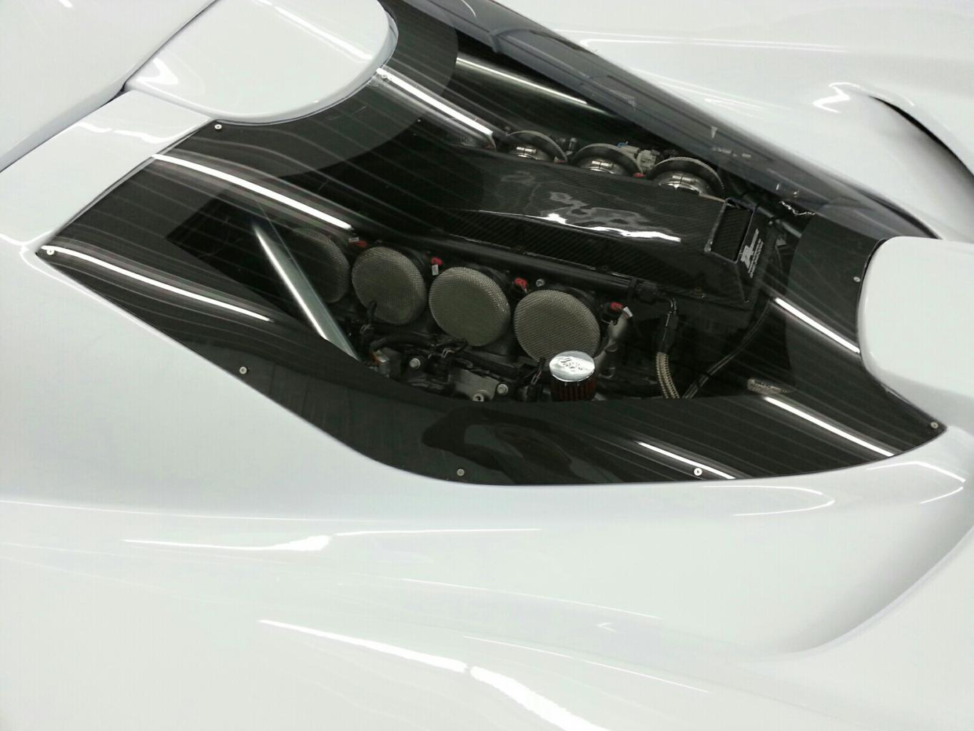

As discussed I'm interested in the Harrop manifold.
What is your plan for those trumpets on the Harrop manifold?
Are you going to leave the trumpets exposed and just attach individual filters to each trumpet? OR
Are you going to inclose the trumpets within an airbox (as per pic below) and then run twin pipes towards the top of the transaxle and mount filters there?

Hi JR
Stuart
just run velocity stack filters; minimal power loss. I got turned onto BBR's from Roberto (although they seem to be, hopefully just temporarily, closed for business at the moment)
proper sized airbox is a nightmare to design and will probably just end up costing you power

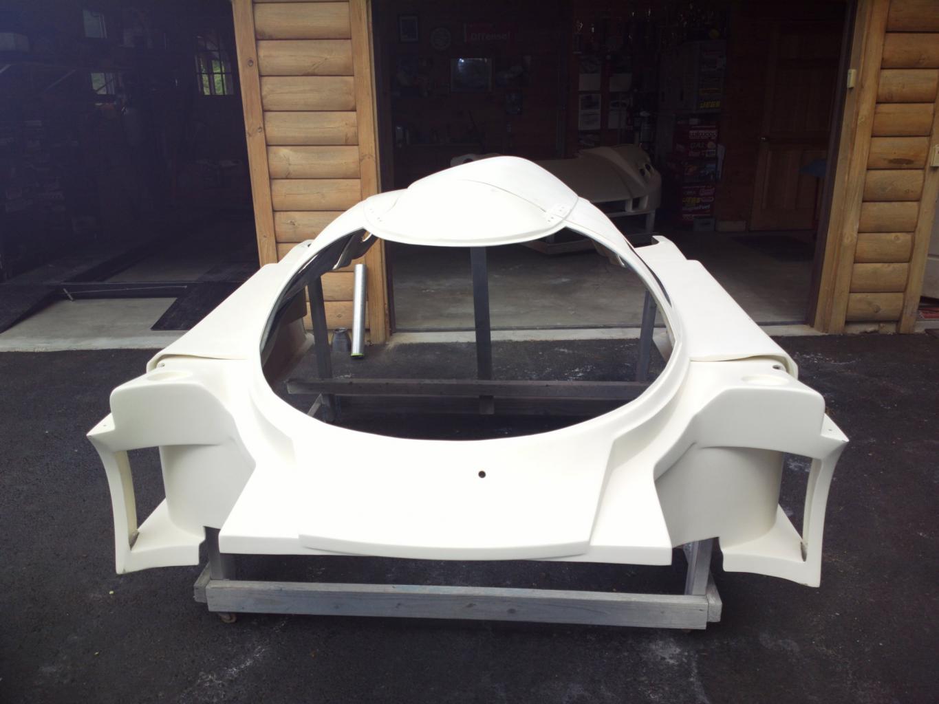

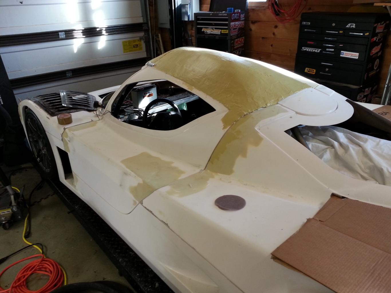

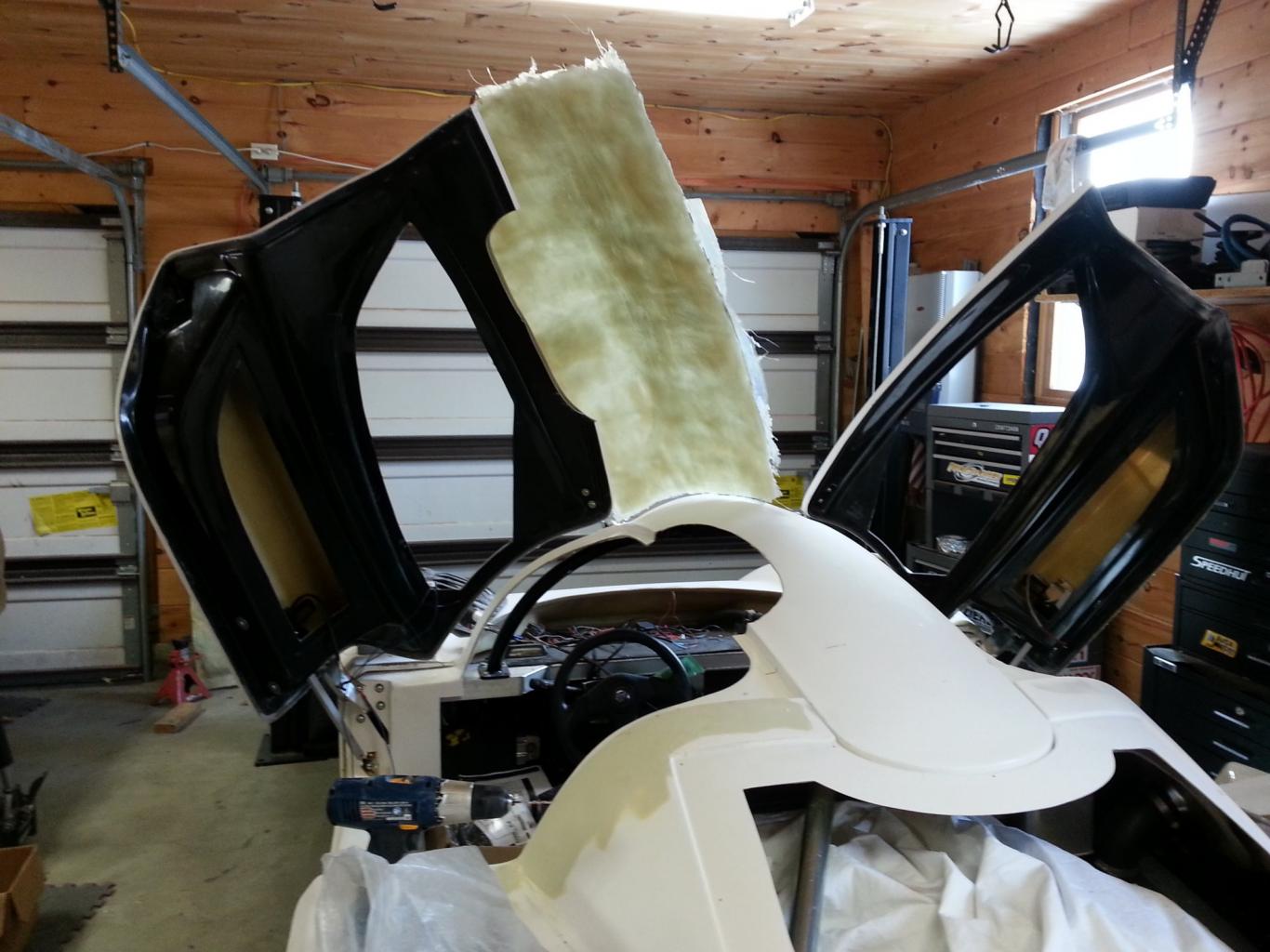

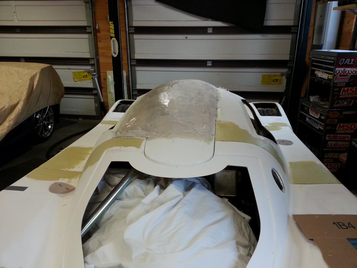

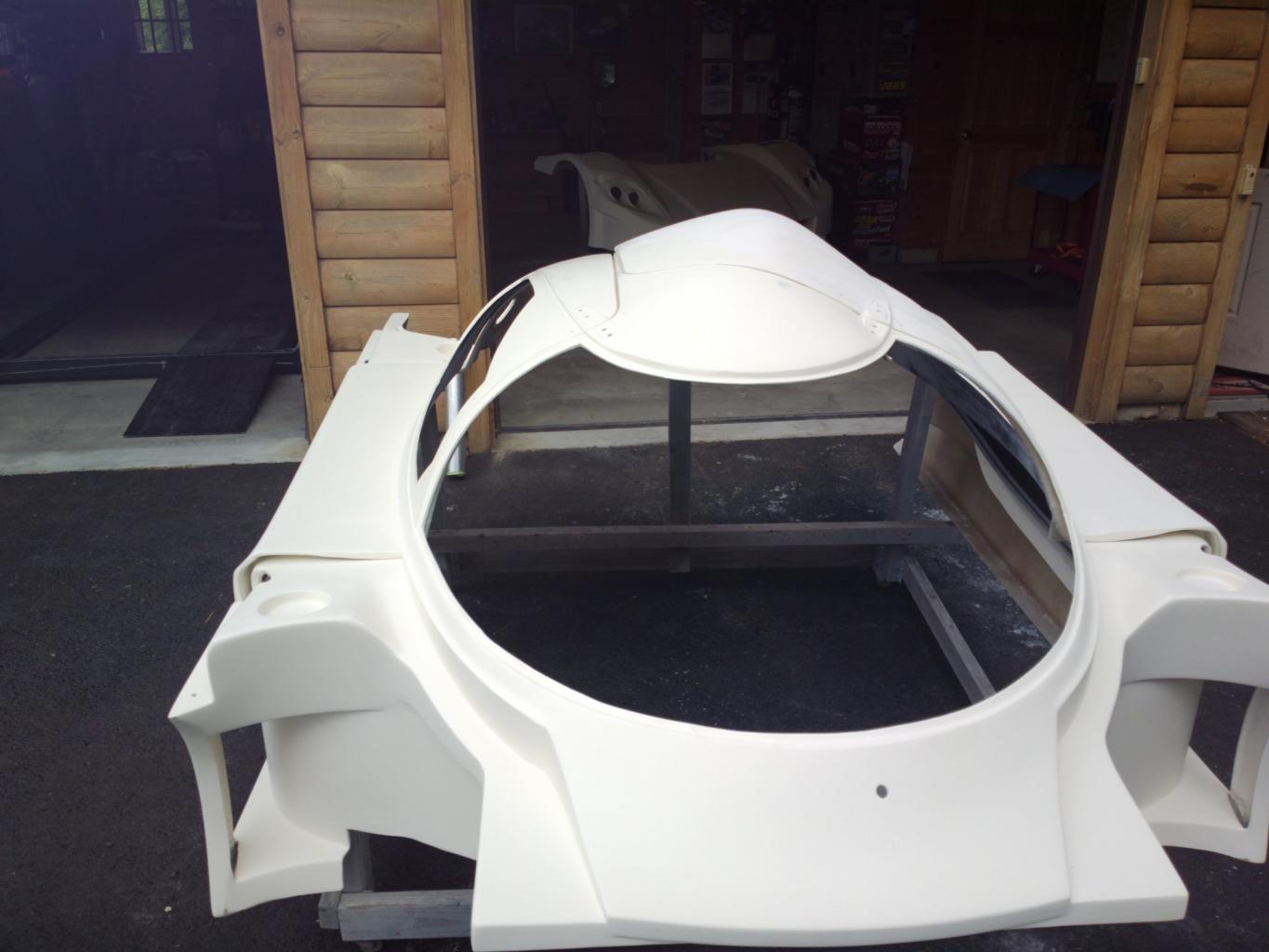

Here's some progress updates from Allan on the "Gurney Bump" on my car.
Looking good. Any idea what kind of body filler Allan is using?
After 6 layers of fiberglass then a layer of resin mixed with microfiller was added for additional strength. After that I used 3M Platinum Plus filler to even out the contours.

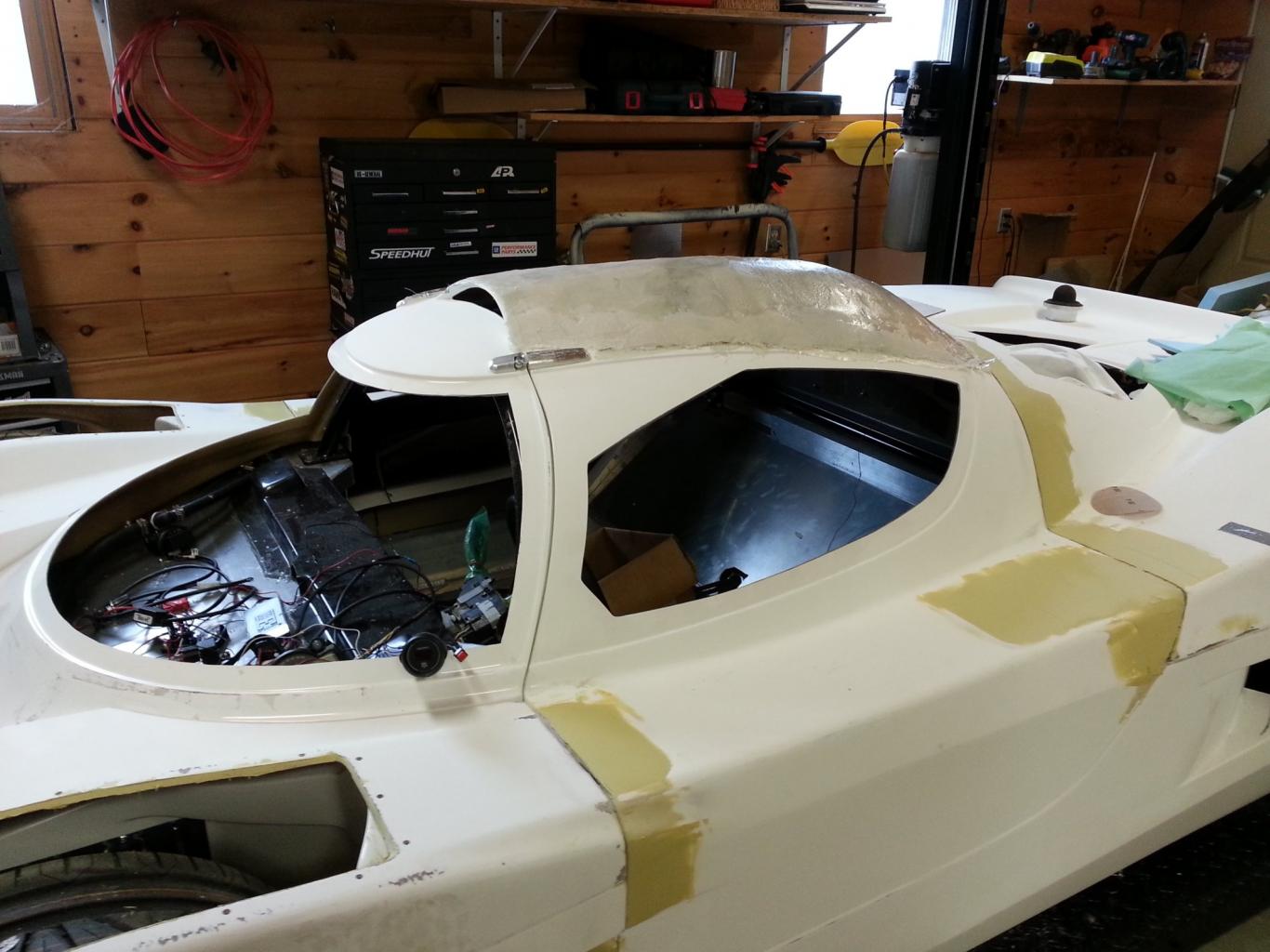

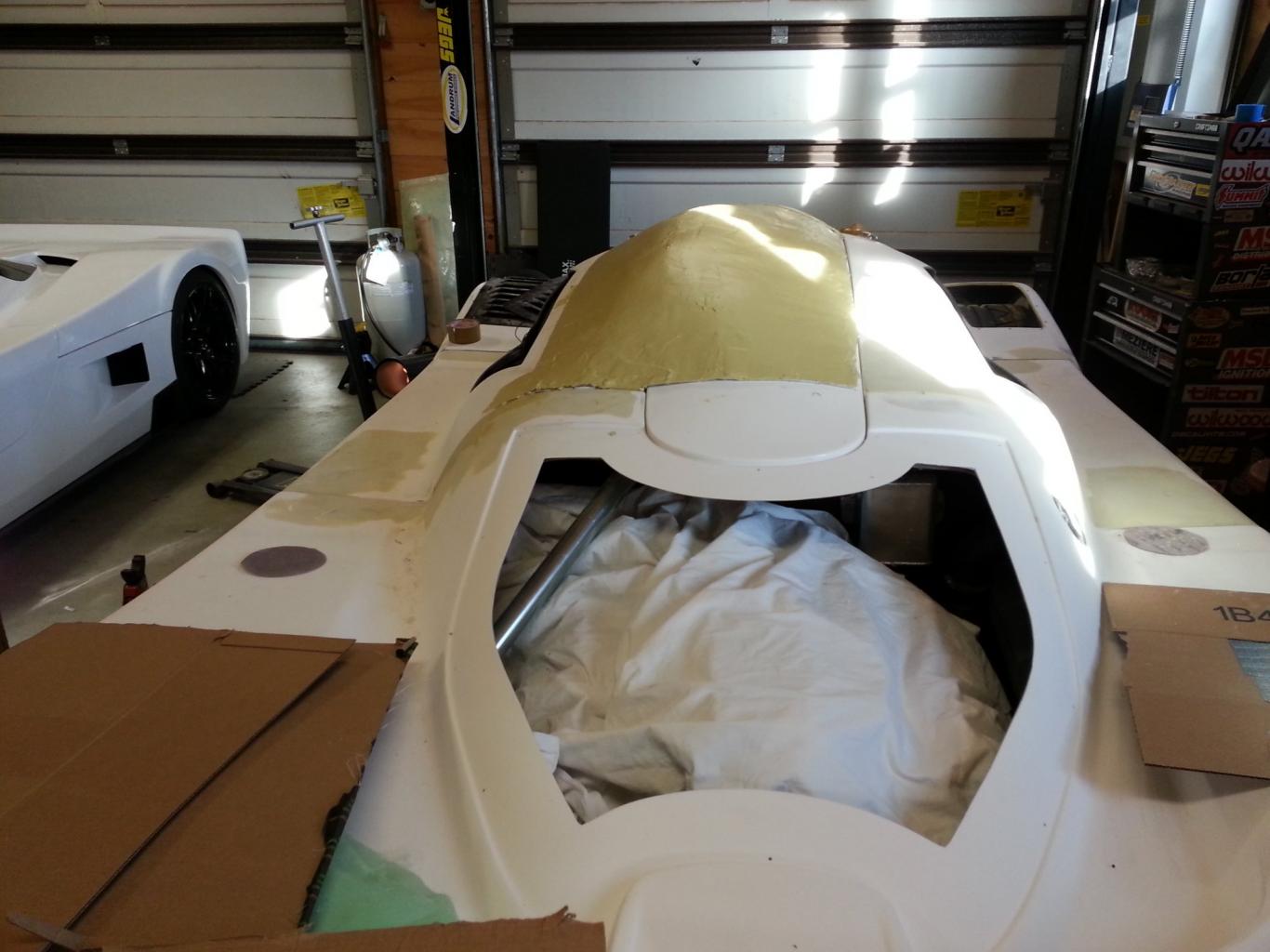

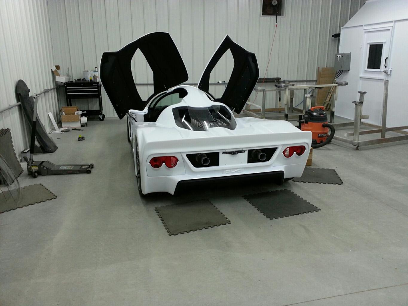

Here's the Gurney Bump...

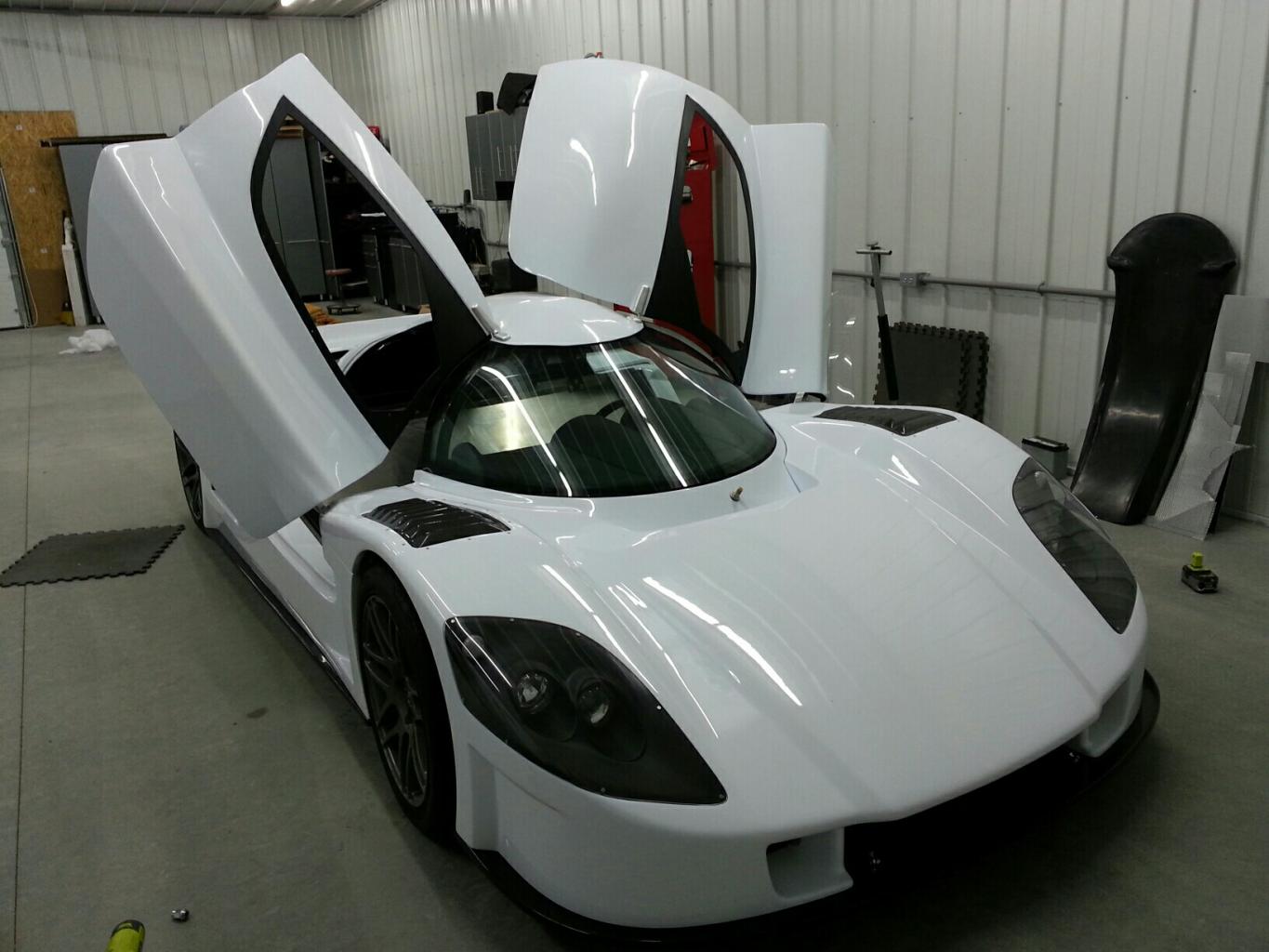

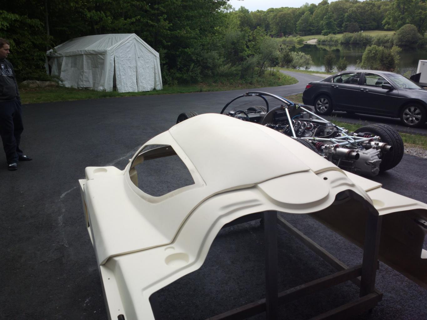

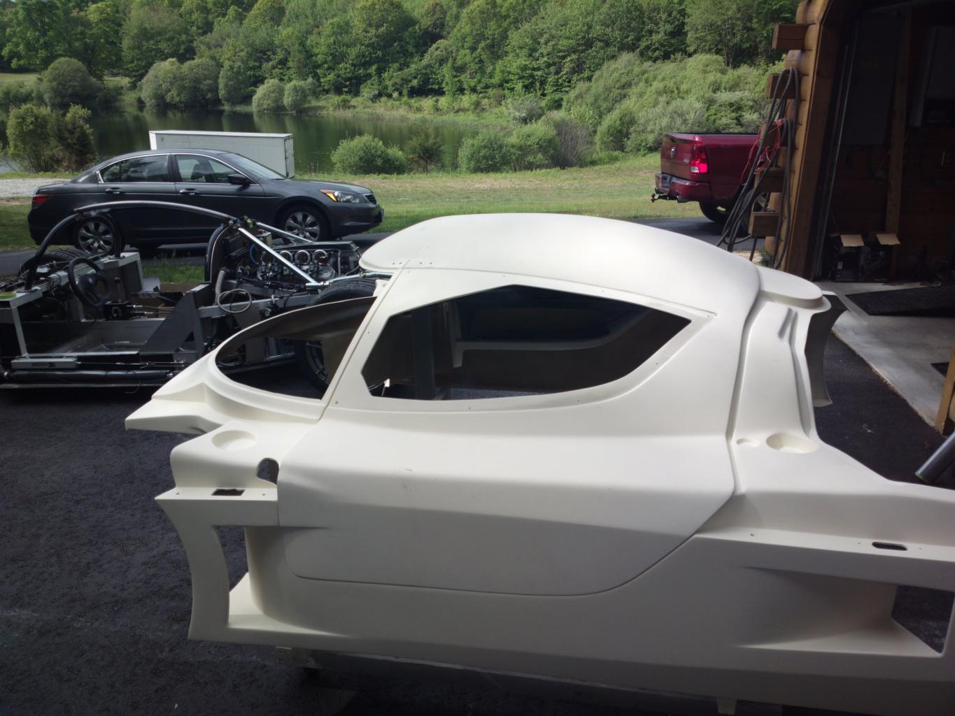

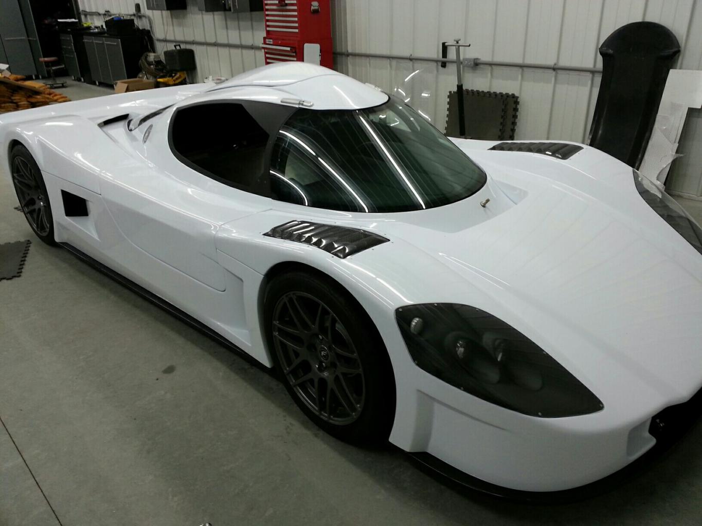

Going to pick it up next week. Here's how it looks...
