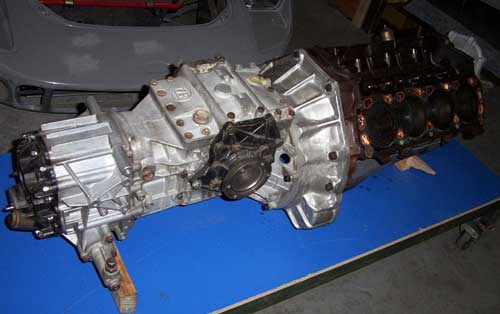

A couple of bell housing pics for you Frank

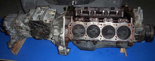

#2 /ubbthreads/images/graemlins/dead_horse.gif I just love the flog the dead horse.(no other reason) /ubbthreads/images/graemlins/cool.gif
Ross Nicol
You'll notice i have no ears on the cover plate either. I made a mount up and bolted it to the cover plate.
Ross
