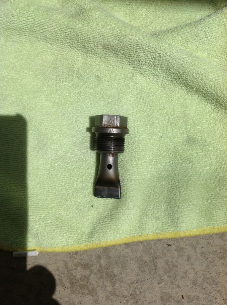

On the other issue of blow-by I discovered this interesting item adapted to my breather fitting yet I still had excessive blow-by. Again would 2/3 cup over the recommended 2.5 qts produce blow-by?
Tim Kay
Update to my own question. After draining out 2 qts + 2 2/3 cups I refilled with 2 qts 1 3/4 cup and no blow-by. I'll add the other 1/4 cup now and post the results. Evidently 2/3 cup can make a difference.
