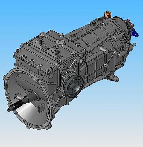

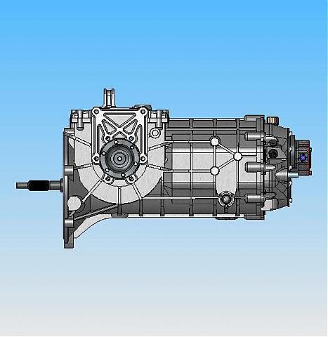

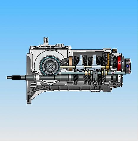

Hi Guys
The ZFQ is a completely new transaxle specifically built to be a nut and bolt replacement for ZF, with GT40 configuration and ATB differential as standard. The ZFQ bolts directly to the ZF GT40 bellhousing and uses the same clutch, gear shift and output shafts.
Regards
Chris.
