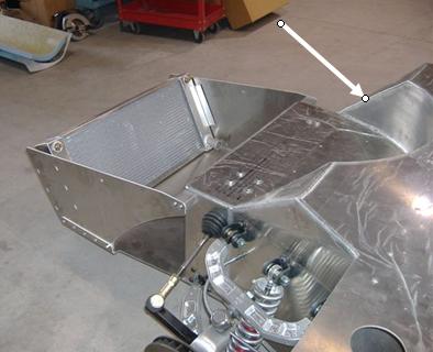

One thing I should mention is that I was thinking along similar lines with respect to fuel relocation. A fuel cell in the shape of a spare tire (say 10" x 25" diameter) holds about 21.25 gallons. This is probably bigger than you can jam into the front well of an RCR and still put the hood on, but that's about the only place I could come up with. That, plus run-flat tires, I guess!

One thing I was concerned about was having the cell stick out past the front of the chassis, and being subject to a direct front impact. So I might have to go with a custom ATL cell that doesn't go much past the panel with the white arrow on it in the photo below. That's probably good for at least 8-10 gallons, which is enough for me in the short events I participate in. But for Ron and his enduros, he will probably want to fill the factory tanks, the front tank and have 5 gallons riding in the passenger seat :-).
I think that an inner/upper puncture of the factory tank is highly unlikely in an RCR simply based on the amount/thickness of material that needs to be penetrated, but it is possible. So because 1. I'm really afraid of fire and 2. my wife asked "where is the gas tank?" when she was sitting in the RCR the other day, it seems a cell will be a necessity for me.

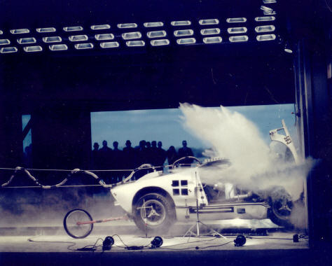

I'm not sure if they were contained in the thread mentioned above, but there were some photos posted a while back of a front end collision test (done by Ford), where "fuel" flew everywhere, due to the front tires crushing the front of the sponsons, compressing the fuel in the tanks very quickly, and consequently blowing the fuel caps out. I don't think that the tanks were compromised (physically holed), but fire would pretty much have been a given, had this been done with gasoline, and not water. It'd be worth a search to see the results of the test, if you haven't already.
You mean the one in my Avatar Bill.
That's the one Brett!
I don't remember the exact speed of this test. Wasn't it 60MPH?
I'd love to see a close up of the gentlemen in the background of the photo.
I can imagine a look of slack jawed shock on every face!
I wonder who owns (or claims to own) this chassis today?
