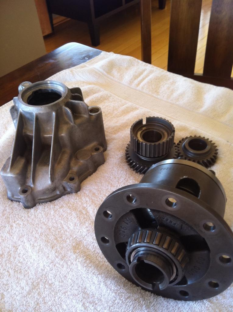

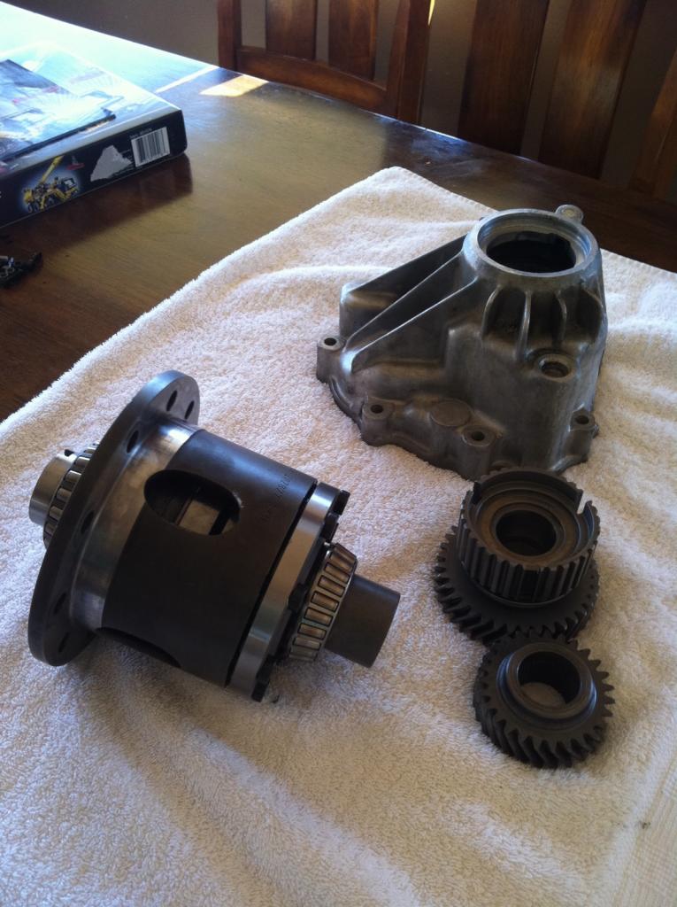

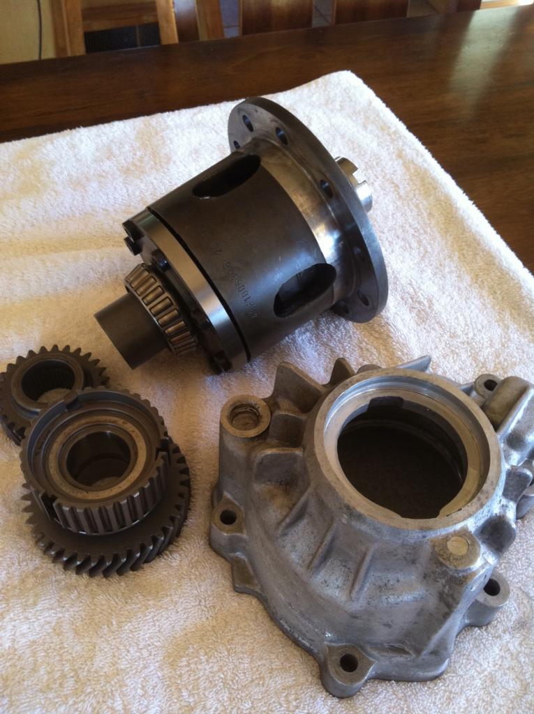

I removed these two gears from an 016 over the weekend - these are the two gears residing under the aluminum cover at the very rear of the transaxle.
My question is, are these the two "final" gears that produce either the 3.89, 4.11 or 4.56 final drive ratio used by the 016?
These came from a porsche 944 turbo 016.
Thanks in advance.

Cliff,
The two gears shown in the photo are what make up "5th" gear. The "final drive ratio" is made up of the ring gear and pinion gear (the same as in a conventional differential).
The ring gear bolts to the "carrier" that is also shown in the photo (and is a "ring shaped" gear) and the pinion gear which is also the output shaft of the transmission. This "ring and pinion" combination is what makes up the "final drive" of the transaxle.
