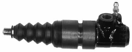

Hi all -
Can anyone tell me the pn and best source (pref UK) for a slave cylinder for an AUDI 016 transaxle ?
I had a search but didn't find details and AUDI UK say the box in question is from a German Car and they do not have 'pn.s for the German cars' - (hmmm - sounds like a lazy parts dept to me....!)
Any help much appreciated...

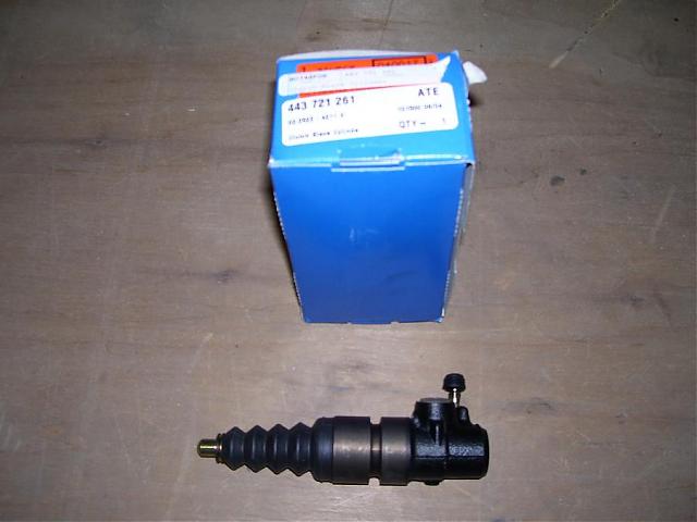

Thanks all - as always, the forum's contributor's are the font of all things GT40...:)
I have also been contacted by the 'new RF' - who have kindly said they have some available - so I'm just awaiting a price....rockonsmile
They look to be cheap Paul, $60 to $90. I'll be happy to order one and post it over to you, just let me know. My local shop can have them in 24 hours and it'd be about 4 days post.

Hi all -
Just thought I'd let you know I have been contacted by Paul of the 'New Roaring Forties' and a slave cylinder is on it's way.....
Paul was very helpful and is available for advice / other parts as required... :) Oh - and he likes Cosworths too so that makes him an 'all round good egg' in my eyes....

Bit late on this one,but ordered my box from my local audi dealer in newton abbot UK and they deliverred it from germany in 3 days, then the slave cylinder ordered and here in 3 days at cost of 55 uk pounds (currently $110 sorry must be time for a US holiday)
