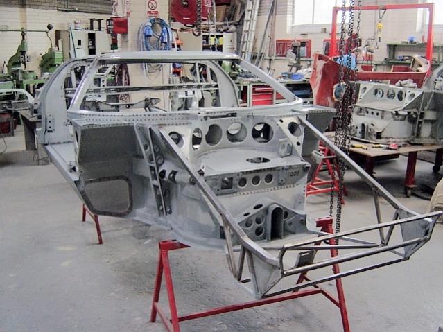

I was given a Trumpeter 1:12 MKII kit for Christmas but there is not enough detail in the chassis to my liking.
I have always wanted a model of my MKI chassis so I have started a scratch build in 15 thou. nickel silver sheet on a 1:6 scale from my full size chassis drawings.
Hopefully it might look like this.

Jim, that scale model monocoque is AMAZING. Not only does it look perfectly original, but all the shop accessories look exactly their their full-size equivalents as well. You are a magician. ;)

A productive couple of days here as the drawings are all scaled down now and I have started scoping some small swaging tools. The nickel sheet and a small press arrived yesterday.
This "mini" monocoque is approximately 17" long X 10" wide without the cradles and it would give an overall body length of 27".
I might consider laser cutting all the sheet work for better accuracy, more like a kit build to save time.
Should be fun:happy:

How are you forming the roof? I wanted to build a 1/8 scale tub (and just the tub/suspension, no bodywork) and started on the roof first thinking it would be the hardest part. I decided to carve a hardwood "buck' to hammer form the brass inner & outer roof pieces on.
After two hours of carving and grinding I went back to my Fujimi 1/24 GT40s and called it quits!

I am going to do the dishes using a leather sandbag with rubber and nylon ball hammers.
The edges will be formed with bucks and small crimping pliers. You need very soft annealed brass for this kind of work.
Tedious I know, but with patience they will come out OK.
