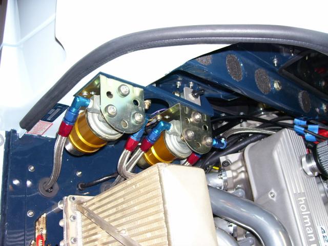

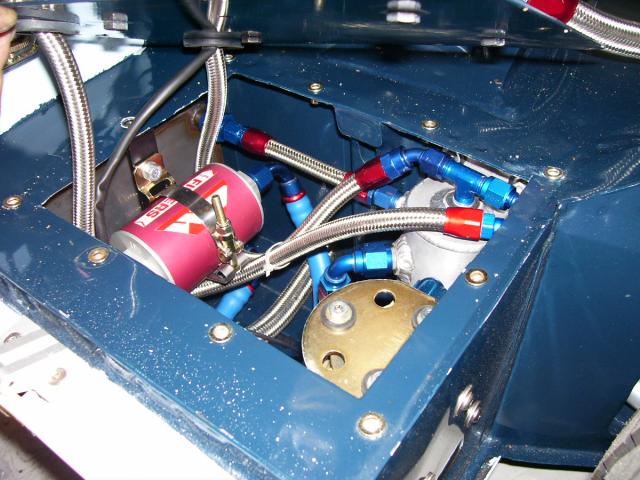

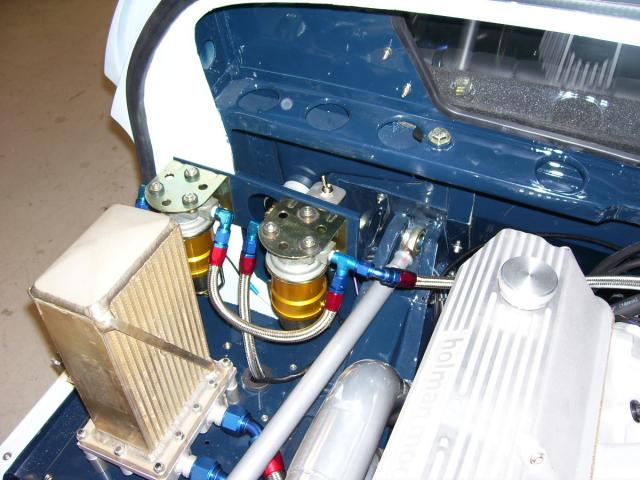

Tom,
You might want to consider a fuel delivery set up like this:
Send me a pm if you want to discuss.
Steve P2125
