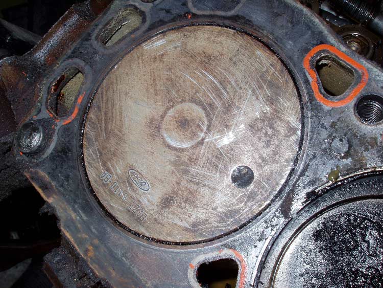

I have a 302 engine that was supposedly taken from a mustang GT.
I bought the engine knowing that I have to strip it down and inspect it.
I have one of the heads off and have already found a large dark mark on the bore which seems to have been caused by water making the inside of the bore rusty (the engine has been sitting in a leaky garage for a while) which will probably mean a rebore.
I just wanted to ask if the piston in the picture is standard for that type of application. As far as i'm aware, it's a mid 80's engine, originally fitted with an efi system. It has a roller camshaft and a serpentine pulley on the water pump (which will need changing)

Hi Simon,
It's a 1986 EFI spec Ford piston, original C/R is 9.2:1 for this motor, the good news is it's forged so that can be sorted.
The bad news is it specific to the cyl head that has the valves set deep in the chamber ( note no valve notches ), and they will need to be cut if you plan on using most other or aftermarket cyl heads. Having said that the heads that go with those pistons respond quite well to a bit of a rework in the combustion chamber.

Jac mac, you're right, there's no pocket in the pistons and the valves seem to be set a long way into the head. Would doing something as simple as changing the rocker arms to 1.6 roller rockers mean contact in the valve piston department? Can these heads be skimmed at all?
What sort of work can improve them?
Simon
1.6 is std rocker ratio so should not cause any problems, any head skimming or cam change it would be prudent to check valve to piston clearance.
If its the head I am thinking of it needs unshrouded around the valves and radiused on sharp edges particularly on the cusp that extends between valves.
Skimming of any Ford prod heads should be kept to a minimum for deck strength reasons.
Jac Mac

First off - the engine is not a Mustang HO engine but is probably from a full-size passenger car. The pistons in the non-HO cars were typically cast Hypereutectic design pistons. This can actually work to your advantage - read further..
"tiny pin marks" - this is usually a result of detonation / Pre-ignition. From the sound of it, this could have come from potential oil consumption problem in one or more cylinders.
Getting by with a re-hone (here's where the info from above comes into play).
Cast / Hypereutectic pistons are typically fit with a tolerance of .0015-.0035". If you measure the bores and they are still round within tolerance - you can have the block honed to fit a set of replacement "forged" pistons which are usually fit from .0045-.0065".
By replacing the pistons with forged - you can get pistons that are already notched appropriately for the higher lift camshafts.

First, the extra clearance is usually built into the piston- Bore size remains same @ 4.000" ( Cast-Hyper pistons will measure up @ 3.997"/3.998 approx while Forged will be in the 3.994'/3.995" zone ) Ford did make replacement Forged pistons to suit 0.005" O/S to allow for correction of warranty problems etc . These may no longer available though.
ACL ( Australia ) Make a Hi- Silicone Cast piston of performance design with narrow rings, coated skirts and drilled oil drainback ( no slots ) which is available in 0.020"/0.030"/0.040" OS. It also has a single large valve clearance pocket. These are also available for the 3.4" stroker version ( a 0.005" OS was also available for these. Taper wall pins & enough material in pin boss for circlips if you desire are a couple of other features.
The reason Howard & others urge you to rebalance is in the 40 situation you will require a non Ford flywheel, several forum members have had exspensive problems with mirror balanced flywheels and since the piston weight is likely to change in this instance it would be prudent to do so. ( Randy obviously has a lot more faith than in the ability of replacement part manufacturers to adhere to production weights than I do.)
I agree with Randy on the sleeve issue- not side by side- and as an added thought, I make all my own sleeves, just go to the local tractor/truck workshop and scrounge some of the old wet sleeves and spin them up in the lathe to the size I require, turn a step about 0.500" up from the bottom & bore the block to suit, That sucker aint going nowhere!
