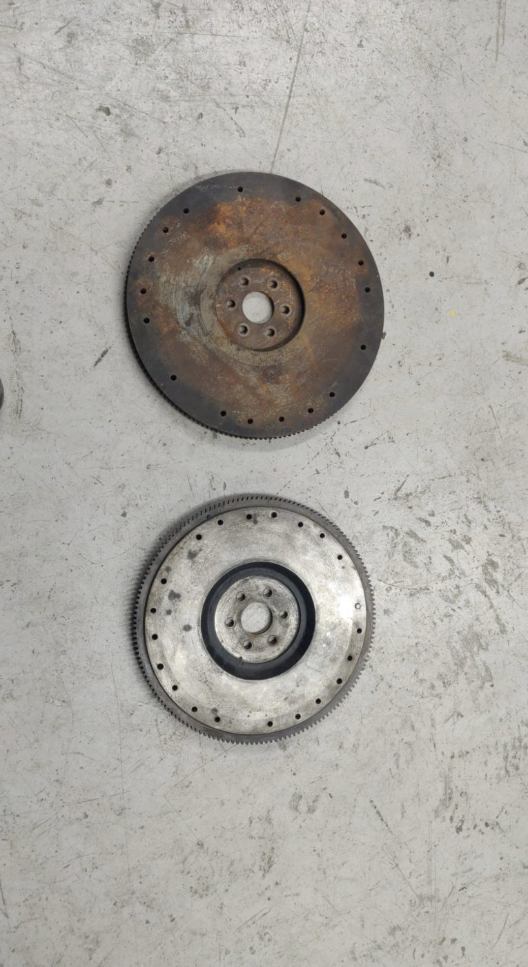

S Simon Feb 4, 2023 #1 Can anybody tell me which of these is the correct flywheel for a 1987 302 engine please?

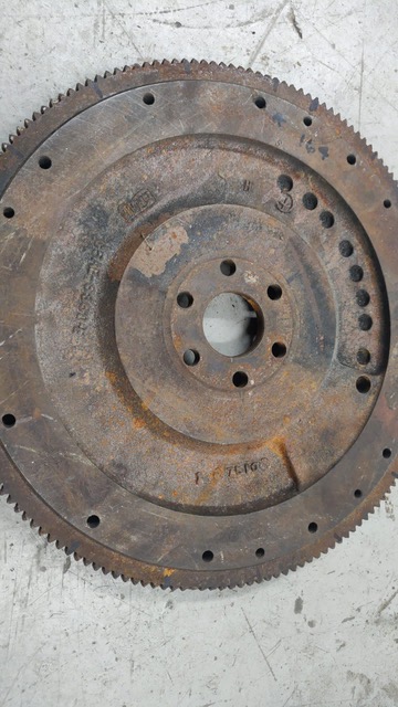

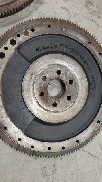

Randy V Moderator-Admin Staff member Admin Lifetime Supporter Feb 4, 2023 #2 Picture showing the back side with the counterbalance weight would be good...
Bill Kearley Supporter Feb 4, 2023 #4 Tooth count as well, one of those looks like it could be from a truck, bigger o.d. You will need a 50 oz.
Randy V Moderator-Admin Staff member Admin Lifetime Supporter Feb 4, 2023 #6 Looks like the 1 on the left is a 50oz imbalance flywheel…. That should work on your HO302…
Rune Supporter Feb 6, 2023 #10 A 302 built before 1981 use a 28oz balance and after 1981 50 oz if I remember correct.
